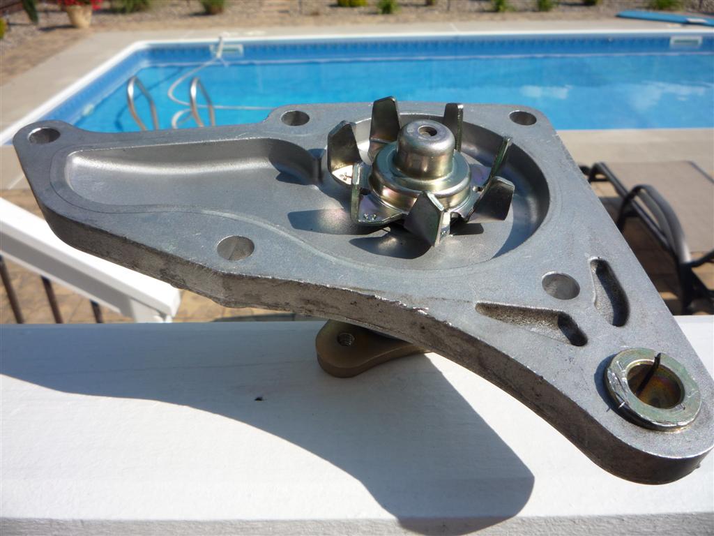

While we're on the subject of water pumps - anyone know if the impeller in the S's waterpump is plastic or metal?
Old Jul 23, 2009 | 09:22 AM
2001_s2000's Avatar
Posts: 235
From: south
Metal
