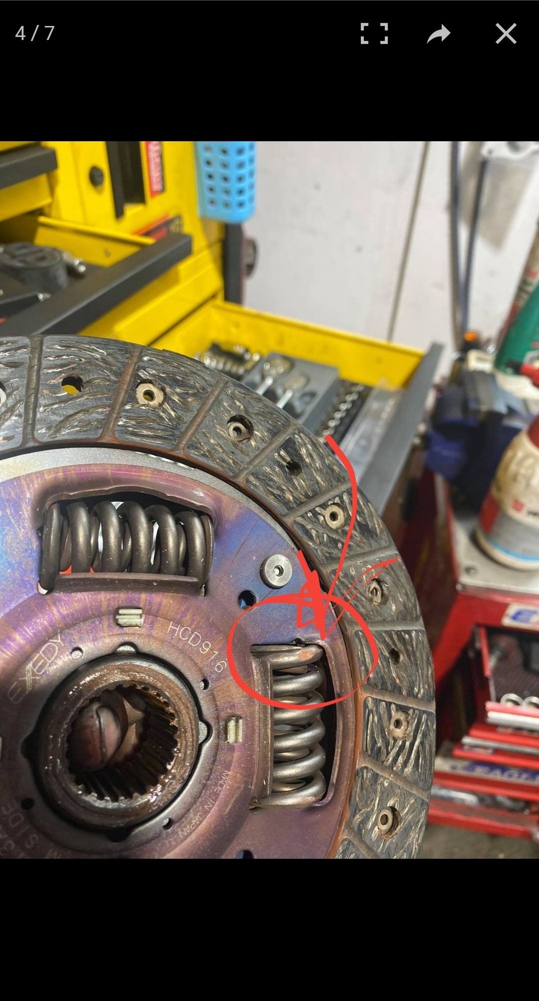

You're using an Exedy disc?
A big risk, my friend. I thought you said OEM.
Any springs popped out of the disc yet?
That high temp grease...its not copper anti-seize is it? You can't successfully use that for sliding parts. It will destroy them over time.

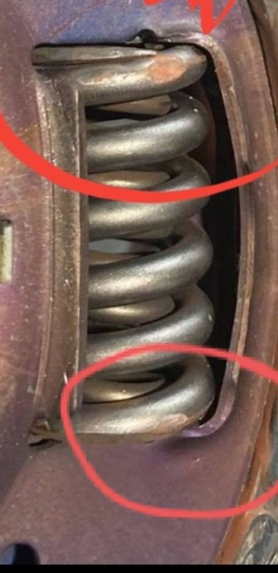

Exedy disc though....
Check out the OP's photo below...
Spring might be rubbing on something. Photo is of the trans side, it seems.
Wonder what the pressure plate looks like..
any evidence of rubbing, OP?
enhance....
