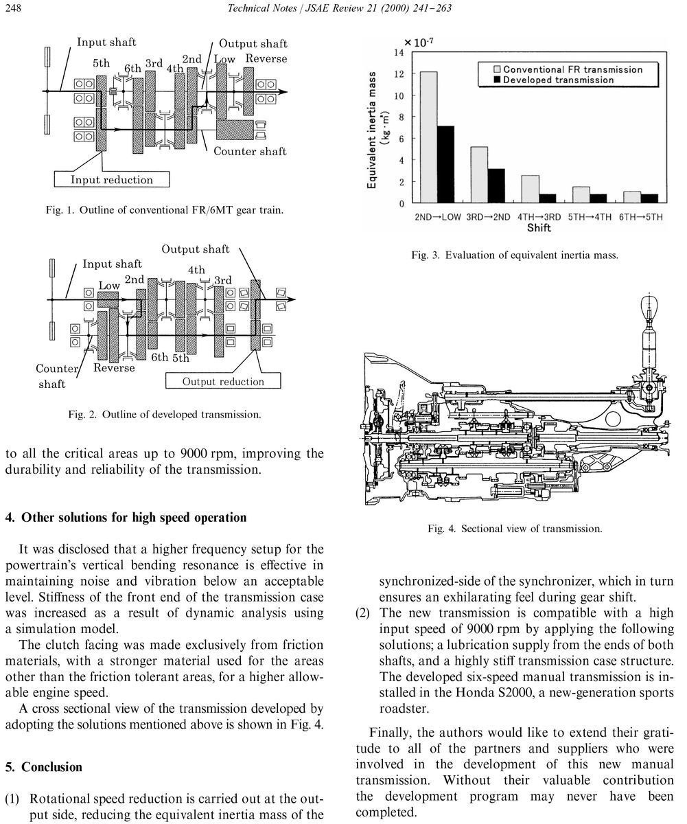

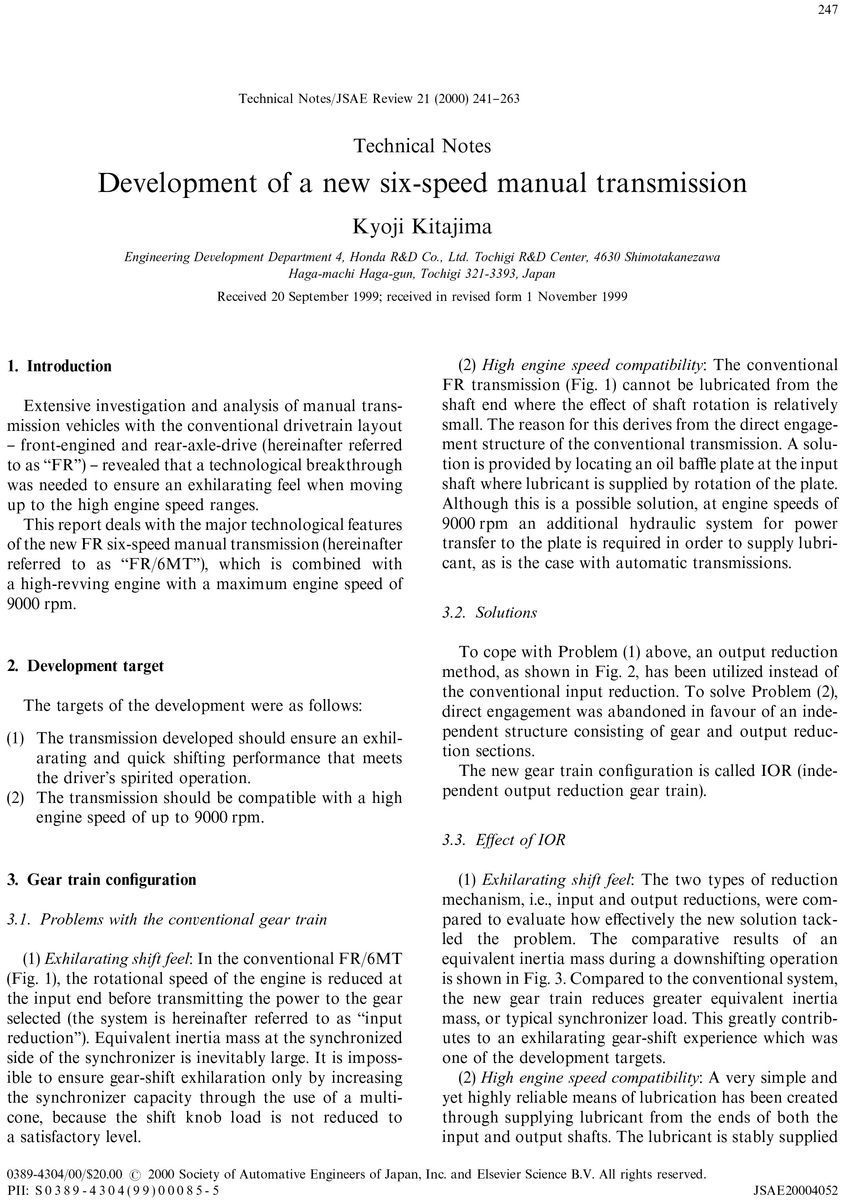

Regarding not getting into reverse, this may not be what you are getting, but the early AP1 has deliberately light synchros in lower gears to produce very light shift effort. When I first start my model year 2000, reverse or first may feel blocked out when I try to select them. Not grinding, just won't go. All I have to do is double clutch. Always works. That is, engage the clutch (let the pedal up) in neutral to spin the gears then release the clutch (press pedal) again to shift into first or reverse. Once the gears are moving the synchros do the job.
Later cars (2002?) got heavier synchros because of complaints about gear crunch from customers who only knew how to slam shift.
From my archives:
PII: S0389-4304(99)00085-5
