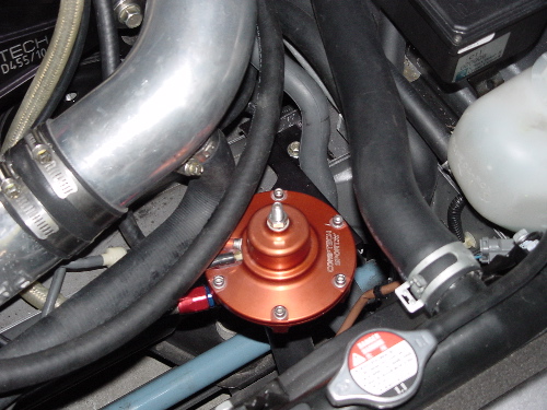

AusS2000 has a RHD car with a Comptech. The fuel pressure regulator mounting would be different, but nothing major.

The only modification required is the location of the FPR. I ran the supplied fuel line, extended boost line and fuel return forwards along the manifold towards the front rail. I modified the supplied bracket to mount the FPR on one of the original airbox mounts.

Oh yeah, if you don't have cruise control you could mount the fpr between the shock tower and the reservoir bottle. I have an aftermarket cruise control in that location but I suspect that only US S2000s have cruise as standard so you may have that location available.

I bought it on S2ki from the US and had it shipped here. I don't have the AC kit yet but it would probably interfere with my original FPR position. But that is an old photo. I now have a SARD FPR on the fuel rail, larger injectors and an E-manage.
You should be fine installing the FPR where the cruise box is in my photo.
