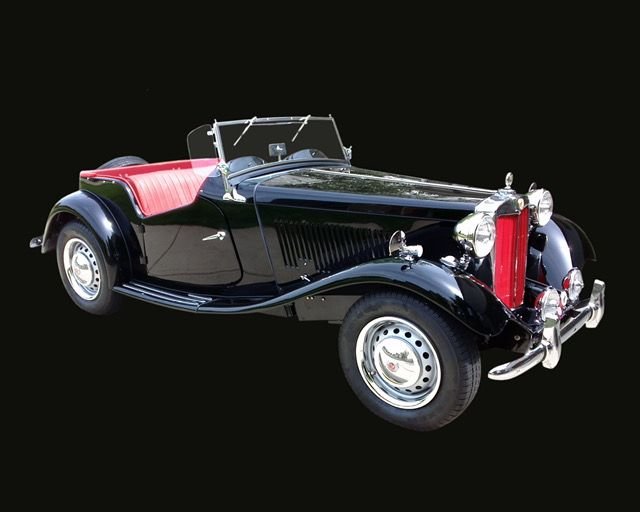

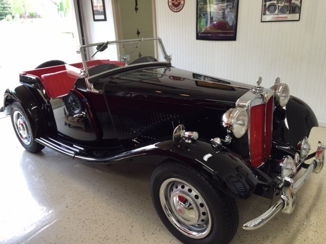

Three of my close friends have TDs but only one is national award winner. He can't help himself, he has a national award winning MGA too. And, is working on another MGA. Still, and this is the best part he drives them!! He made the 1400 mile trip to VA in his MGA a few weeks ago that I had to cancel. In any case, I asked him to send me a couple pictures of the TD.
