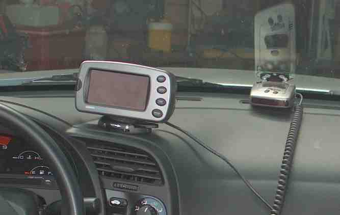

I got my pictures up..
This is the Garmin 2610 and Passport
The Radio Shack power splitter

Note that my 2610 is easy to monitor without taking my eyes off the road. I wouldn't want to mount it in the center console because it would distract me too much when I needed to look at it.
I tried using the GPS-V mounted next to the A pillar in the S but it was too far away to see the small screen.

I have a Garmin 2620 and a Valentine V1. I keep them in exactly the same place except that I use the beanbag with a sticky pad instead of mounting anything permanently to the dash.
I couldn't stand the wires so I wired in an auxiliary socket. The socket is in the basket next to the radio on the passenger side. The Garmin and V1 wires still come over the dash, but don't get pulled all the way to the glove compartment.
Go from socket 7, 8 or 9 in the fuse box in front of the drivers foot (and the ground on the firewall) to behind the radio and into the basket with the wire. Attach a double socket to it and you're done. I don't remember which one of them goes on with the ignition but I can look it up if you're interested or you can post a question in the electronics forum.

@ ralper --- Thanks for the tip. I've read other threads about getting power from there but I haven't gotten around to doing anything yet. I've got a voltmeter so if I ever do that I'll be able to figure out what is what.

Ed Grant, I have mine similar to yours but my GPS is farther away, and closer to the radar detector. When I drive I have on distance only glasses so I don't want my GPS too close for me to read.

The 2610 is a touch screen so having it within easy reach is a plus. I was able to stop using glasses a couple of years ago after having to wear them since 1972 for my far vision.
