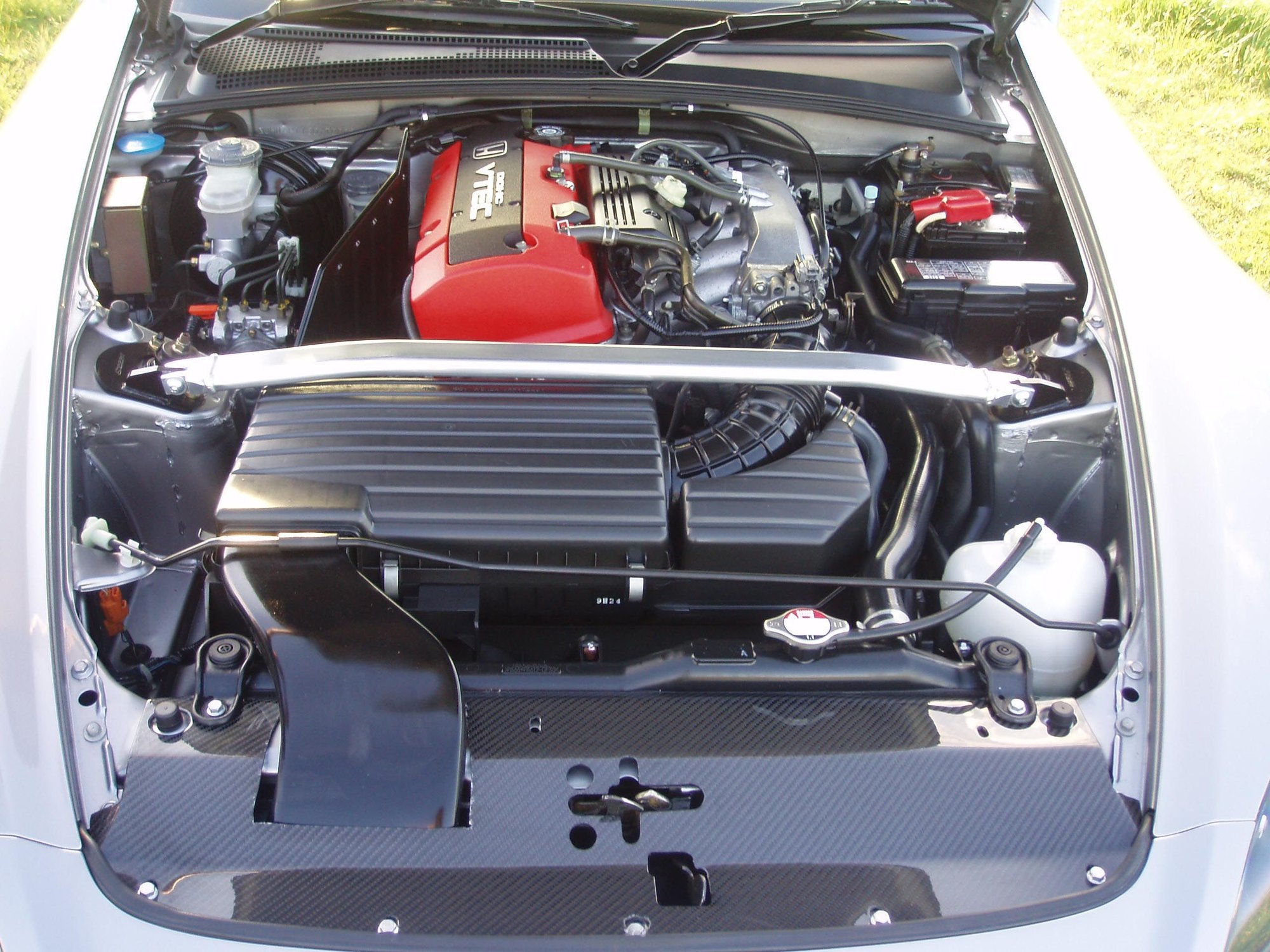

First, STAY AWAY FROM SIMPLE GREEN. I cannot stress this enough. Simple Green has a widely known reputation for staining (and even degrading) metals such as aluminum. Just because it hasn't happened to you that only means it hasn't happened to you yet.
Second, engine cleaning is very easy. A lot of people have already mentioned most of the steps, but here's a quick "how to" . . .
  • Stuff a towel in the air intake because you don't want water in there. Plus know where the alternator is because you want to avoid spraying it with anything.
  • Spray down the whole engine bay with a gentle degreaser like Meguiar's Safe D-Greaser (check for it in small sizes at Autodetailingsolutions.com). Then let the cleaner dwell for a few minutes.
  • Scrub everything you can reach with either a toothbrush (for tight areas) or a body/wheel brush.
  • Hose off using a gentle spray from your garden hose. Do not leave the stream in one place for more than a second and be careful not to soak anything.
  • If engine is still greasy in some areas repeat the previous steps, but chances are it will now be clean.
  • Remove the towel from the air intake and turn on the engine. Let it run for 10 minutes with the hood closed. The heat from the engine will help to dry the engine bay.
  • Towel dry any remaining water.
  • Spray a quality vinyl dressing on everything in the engine bay. Meguiar's Hyper Dressing (also available in small sizes on ADS) is a popular choice, but my personal favorite is CD2 Engine Detailer.
  • Run the engine with the hood closed again for 10 minutes to dry the dressing.
  • Towel off any excess dressing.
I've done this to many, many cars without a problem. Here are some additional tips for getting the best results.
  • never clean a hot engine
  • make sure to clean the underside of the hood
  • Be careful around stickers. A brush and some cleaner will quickly remove them which is not a good thing.
  • Be mindful of electrical connections.
