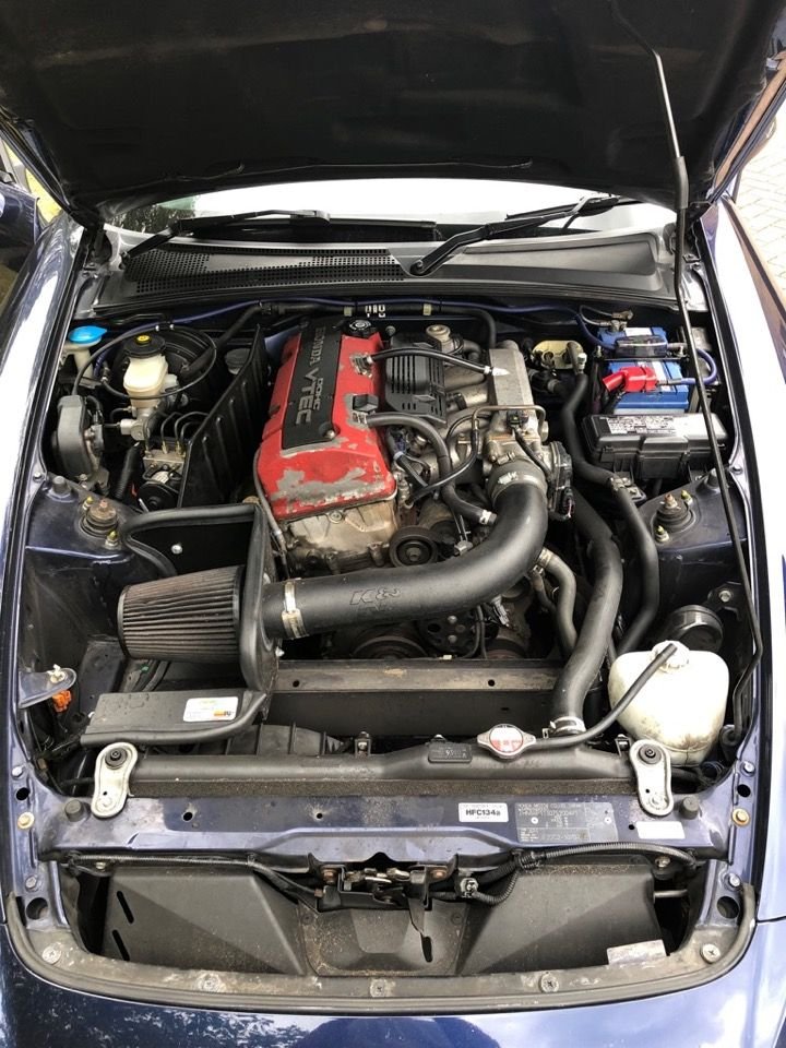

Also got a valve clearance check done while I was there, only 1 out of 16 needed adjusting which isn't bad! And had them strip and re-fit the VTEC solenoid and TCT as I had a slow leak. This also sounded like the perfect time to get the valve cover changed, as the paint has always been very flaky. Unfortunately couldn't find anyone who could do a refurb with exchange for a later model car, so decided to investigate a brand new part - the OEM Honda ones seem very pricey but Si at Hendy happened to have an ex-display Spoon one he was willing to let go for a reasonable price. Definitely wouldn't have gone for this at RRP, but at the price he was willing to let it go for it made sense. Quite happy with the yellow colour!
Fitted with a new gasket and I also sanded back the letters on the spark plug cover which is a good improvement. Finally an eBay VTEC solenoid cover and new black battery terminal cover tidy things up quite a bit. So, from this:
To this, much better!

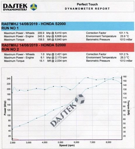

After this the car was all ready for mapping, at last (bought the FlashPro over a year ago!). I had booked a slot with Romain ages ago as he books up fast, on the day he was working at Perfect Touch in Enfield. Pretty slick operation, I was only there about an hour and a half. Car made good power, 245hp which isn't bad given the only mods are a sports cat and the K&N intake. I've only done a few hundred miles so far, most of which were in the pissing rain driving back from Enfield, but initial impressions are very good - the lower VTEC (4000-5500 depending on throttle %) helps smooth out the power band and the extra midrange is noticeable. Nice and smooth too, looking forward to some proper driving!

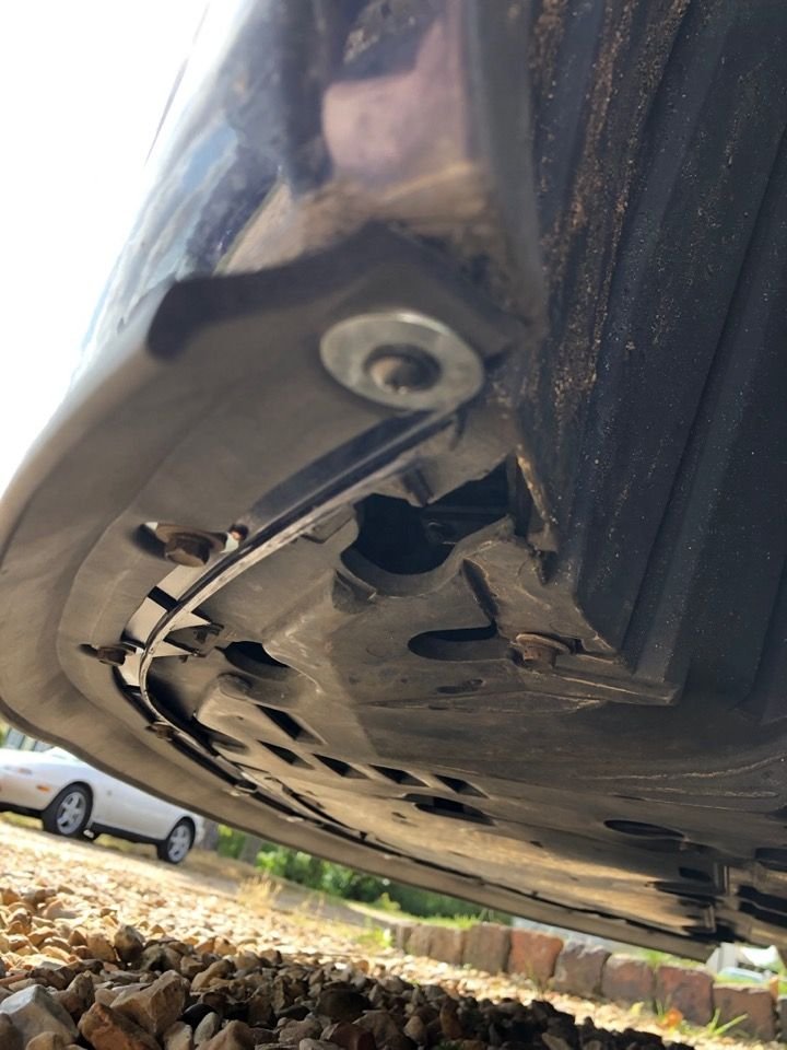

Next up I had wanted to freshen up the front end for a while, so finally got some jobs done. Picked up a ZunSport grille off another member, took all of 5 minutes to fit! Also an eBay self-adhesive front splitter, which is a bit of an experiment, we'll see how long it lasts. I've been looking out for a 'FlyBikesLee' splitter for a while but no luck so far, so will try this for now. Added large washers through the normal bumper bolts for good measure plus a few screws:

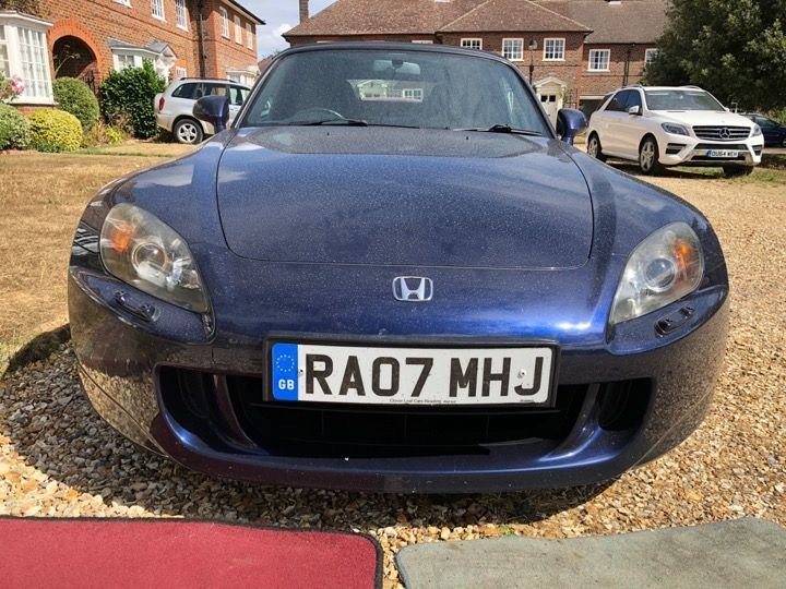

Final job was a headlight restoration. I went for the AutoGlym kit, pretty easy job, done in a couple of hours. No problem doing it with a cordless drill but you will need a change of batteries! Masked up and ready to start, you can see the lights weren't exactly awful but not great either:
Part way through, this is the 'what have I done!' stage, but things quickly improve!
Finished up with some sealant from Amazon. So, overall, from this (removed the holder and added the small plate since this pic of course):
To this - a nice improvement, freshened up the front end nicely!
A few more pics after a good wash, polish and wax:

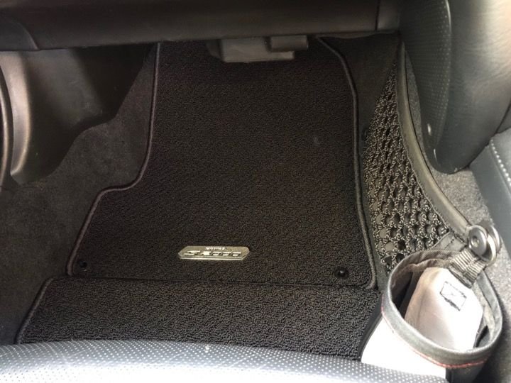

Also got round to fitting a set of premium Honda mats which tidy up the interior nicely. Like most others I ignored the instructions to cut the carpet and just screwed through it instead!
