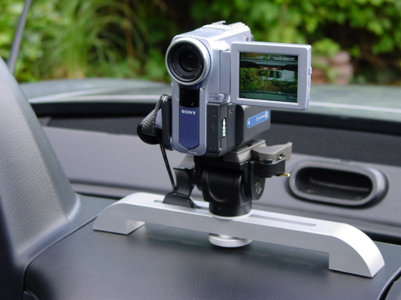

I made one from a bit of wood, a metal bracket I found in the garage and a tripod bolt:
Works a treat

That is actually brilliant. Totally going to do that.

That's a top job. I take it the mount screws down where the wind deflector holder once did?
I'll be copying that. I've been promising to take my Mum out for a top down spin this summer and want to capture her reaction when she experiences VTEC for the first time.

Thanks
It does use the 2 wind deflector nuts in the lid. I bought some longer m5 bolts and wing nuts so I can undo them by hand.
I do like the way that with the modifry one you don't have to keep taking the deflector off but the one pictured above looks quite tall and makes me think it'll wobble if you've got a heavy camera.

Mine is low enough not to have any problem with the mirror either, the lens only sits maybe 4cm above the lid
