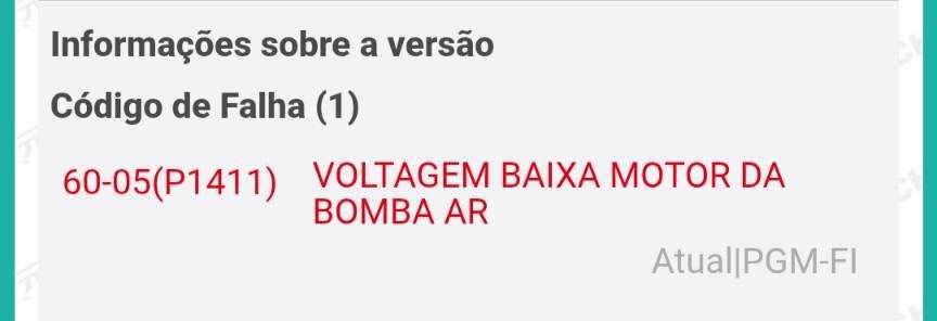

I have a 2000 European Honda S2000 AP1 LHD and recently the CEL came on.
After reading the ECU, the following fault code appears:
'60-05(P1411) Low Voltage Air Pump Motor'
Please see the attached image.
Has anyone ever encountered this error code in the ECU?

Likely to be your air pump relay has failed. Worth checking it's operation, and not bad going if it's lasted 26 years.
Failing that, check your vac lines have been connected correctly, or are even connected at all. Typical that one of the vac lines can become disconnected if not seated. Good luck
