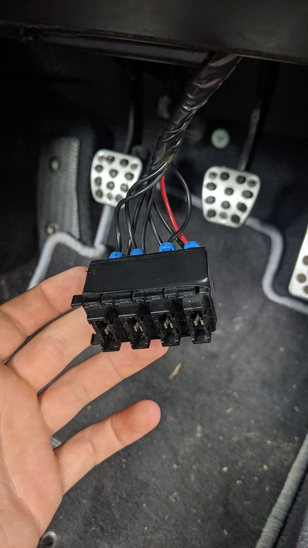

Just looking for a bit of advice on this cable. I believe it is linked to the central locking/alarm but just wondering if anyone knows exactly what. The car is a 2001 and the central locking and alarm have been disconnected so just trying to figure out what has gone on.

that looks like a fuse holder for something aftermarket.
Dont have that in my 2003 from what I can see under my dash.

Exactly my thoughts. Aftermarket fuse box for something.

This looks exactly like mine fuse board for my Clifford alarm.
I lost the use of the remote boot unlock for several months and when I went looking I found this tucked by the fuel cut off switch and one of the spade connectors had come out.
pushed it back in and got the remote boot release working again.

I think Hamilton and Palmer alarms used a fuse block like that? Is yours an early S2000?

It's a 2001 so guessing it will be a H&P. So would removing the fuses really bypas the system or will it have been cut somewhere?

I'd suggest contacting Hamilton Palmer to find out if that's the best approach - they have been helpful to other owners in the past. Best to avoid an immobilised car!

Already spoken to H&P and didn't really get very far to be honest. Would removing all of the fuses cut the alarm off or will cuts have been made at some point? I am not too fussed about the alarm I just want to get the central locking back so deciding to investigate or just get an aftermarket solution...
