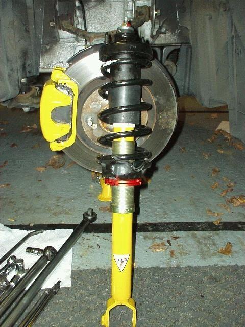

I installed HKS springs with Koni dampers. The ride was reduced by 29 mm. Although handling was improved the car was much less practical as it hit road humps and I couldn't get a jack underneath.
Take a look at the Mugen technical paper, they reccomend ride heights that are around 12mm off stock with a stronger spring rate. I have had Koni set up my suspension so I can achieve this ride height on the HKS springs. I have also had it set up to the '02 settings. It feels about the same as the reduced height but is much more usable on the street.
Be very sure before you change the springs as the dampers will probably need changing as they are a little 'bouncy' on the back anyway. Add up the total amount you think this will cost first before starting - although I think its the best mod I have made as it makes the power far more usable. I have also fitted Panther plus pads and they have a fantastic effect as well on stopping power.
This is what the Koni/ HKS set-up looks like:
Good luck - and get a manual as you need to torque up the suspension correctly and preload the dampers when you re-assemble.
