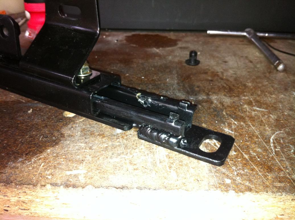

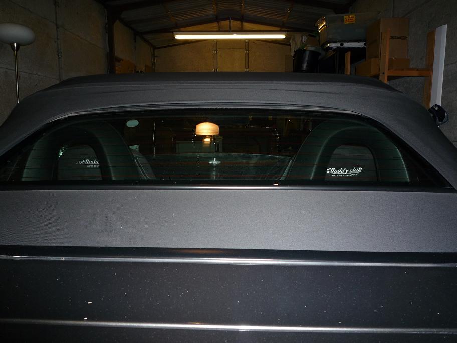

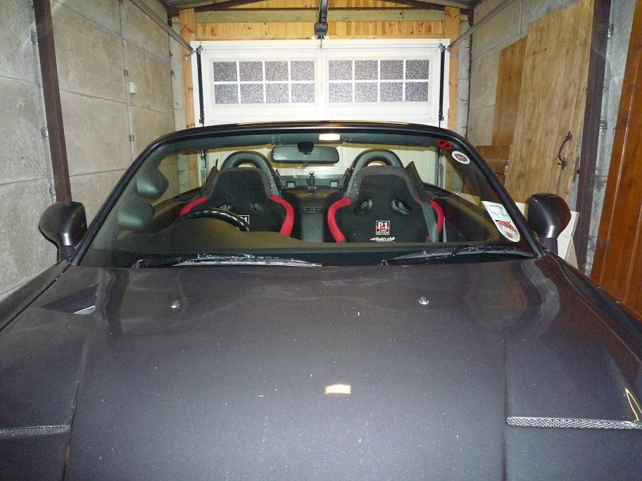

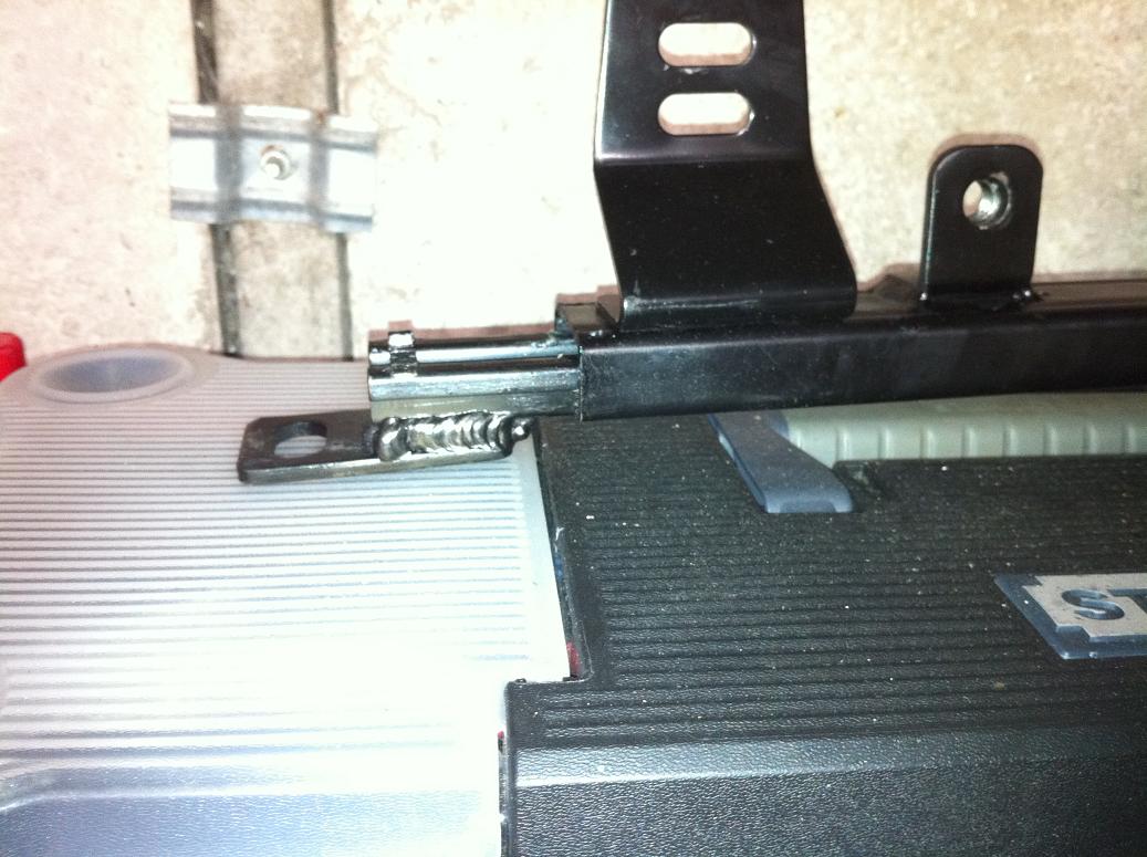

Got the Buddyclub seats in. I decided to get the rails welded as i've heard of a few failing. The welds on them really are gash. Mine are manly
I also modified the driver side gearbox tunnel side rail, by widening the front bolt hole a lot. Won't mean a lot to anyone who hasn't tried fitting these, but basically i've got all 4 points bolted down and have full travel on the seat slider. I had to modify (bend) the slide bar too. Pig of a job but so worth it. One of my favorite mods as it leaves you so connected to the car...

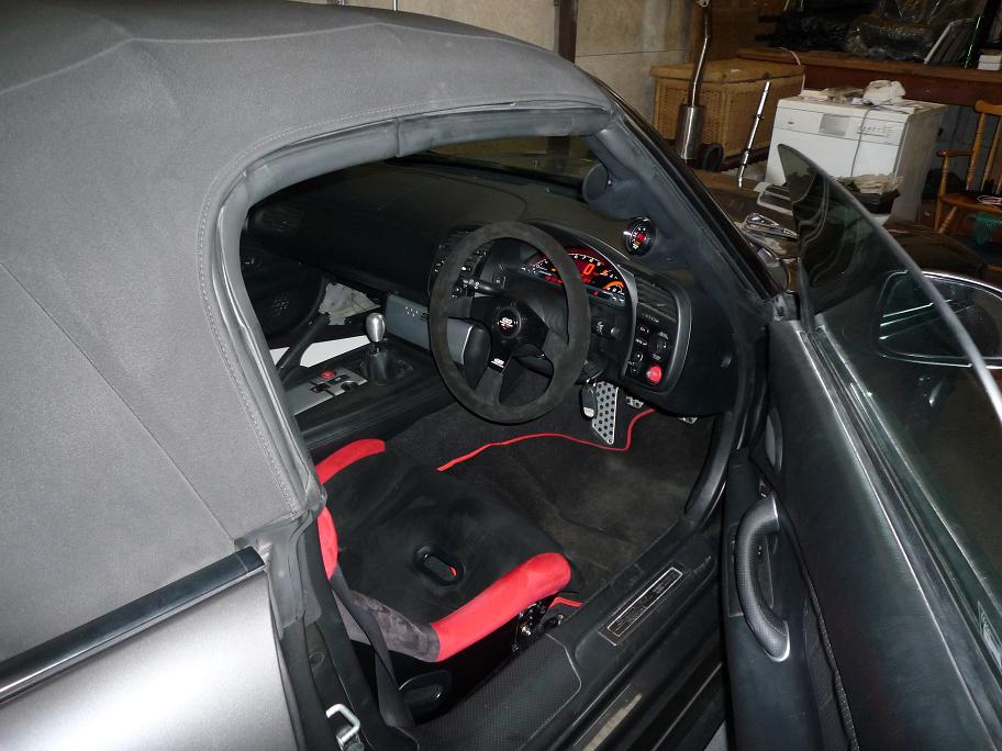

Also got a Mugen alcantara wheel fitted, with a Works Bell boss. Superb, much gripper and chunkier than the OEM one. Solves my sweaty palm issues!

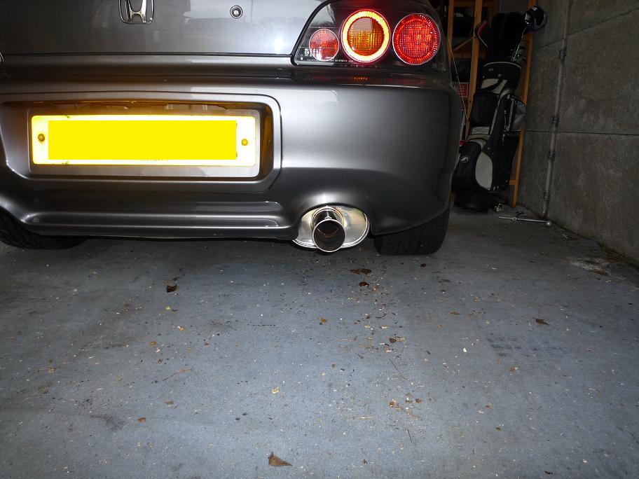

And finally, got an ASM 70mm single pipe fitted, from Tommy at GoTuning. It's not as light as I though, but it's defiantely quiet. I was hoping for a bit more noise but I think once it's got a few miles on it, it will get a bit noisier.

BTW The exhaust will most likely get quieter as you use it!
