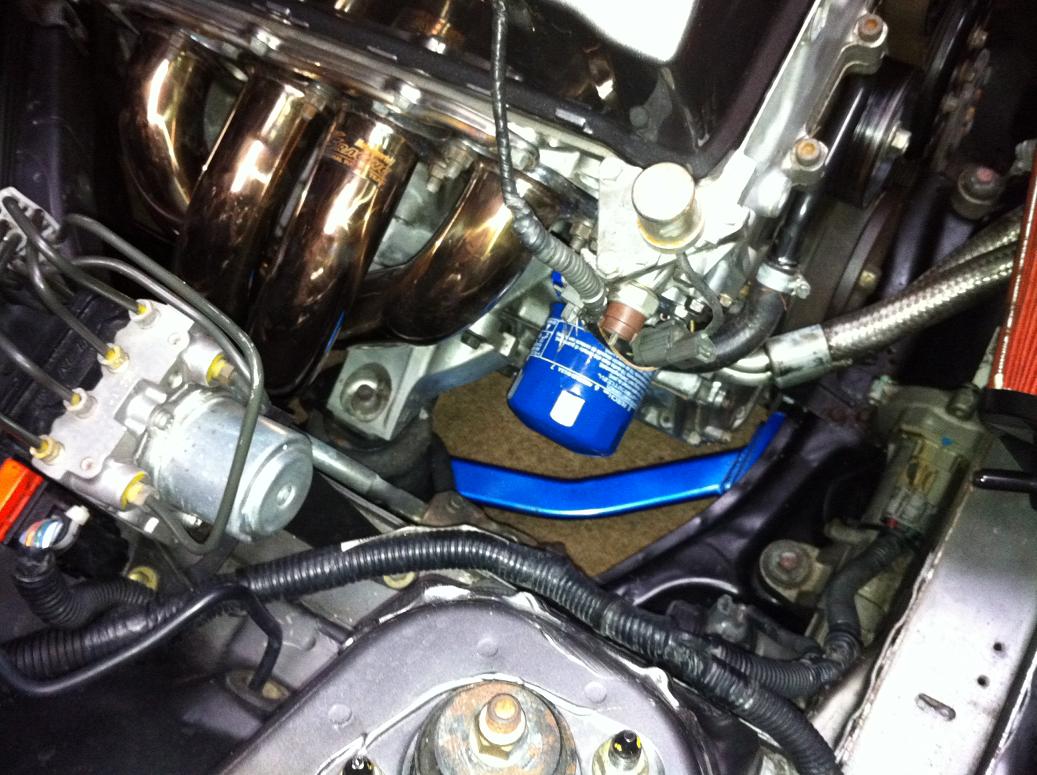

Pic of the Cusco brace...

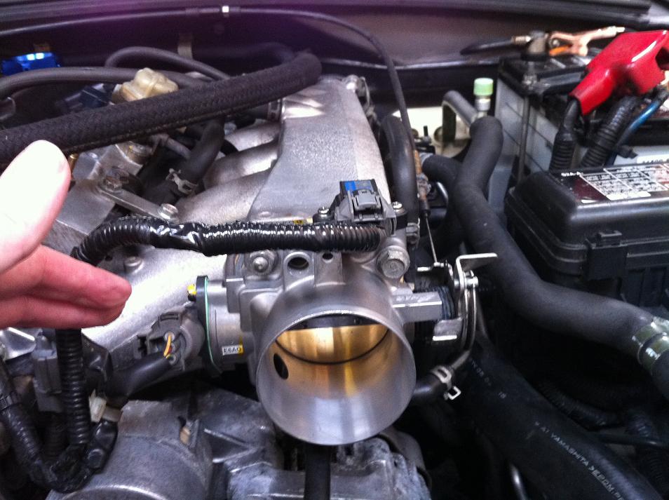

Installed a Spoon venturi TB today... throttle cable was a tiny bit too tight, and got a fright when it rev'd to 4000 on startup
I haven't looked at your build thread in a while and just noticed this. That is chuffing gorgeous!
I'm still learning about engine mods so have to ask two really stupid questions. Why does it look lit up inside and how does the noise from it compare to an intake?
Old Mar 3, 2011 | 03:58 AM
  #155
Joeh's Avatar
Joined: Apr 2009
Posts: 1,554
From: London
Noise I would imagine is the same. I think its possible you have the wrong idea what the device is, this is a throttle body which is midway between the intake manifold and the induction box. All cars have throttle bodies, if you remove the rubber piping to the induction (or possibly aluminium on your car if its been modified) then you will find the throttle body hiding behind it. Effectively this is a restriction point by diameter for how much are can be pushed (FI) /sucked (N/A) through it at any given time, so what MB has done is get one with a larger diameter allowing a larger volume/cubic capacity to go through. You can run your car like the picture but that would be insane as nothing would be filtered so you could get all types of dirt inside the engine. MB took a picture like this just to show the throttle body, normally it will look like this:
Regarding the lighting; Its lit up because he must have had his garage door open and the sun light is reflecting off it.

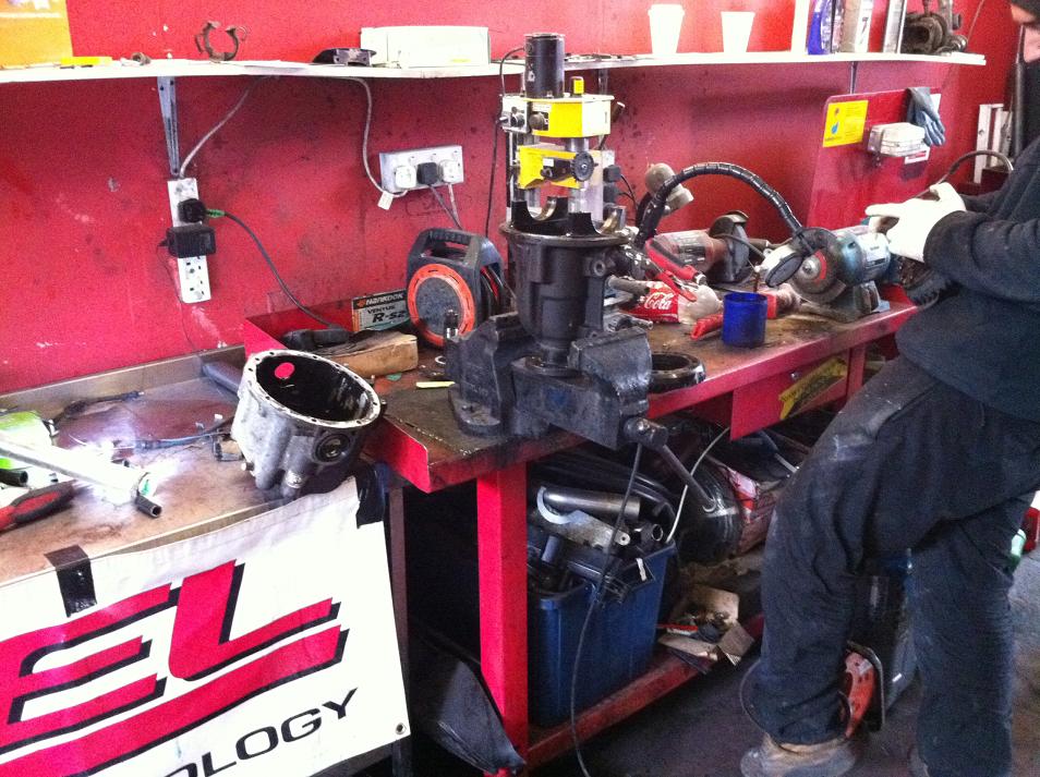

Got the 4.44 Gear X diff fitted today by Dixon @ DMS. Quite a fiddly job but nicely done.
Sounds awful while it's bedding in, but i'm assured it will improve shortly! I can't hammer it while it's bedding in but i'm very impressed with the torque increase.

How are you finding the gears do you like them?, good choice on the 4.44's Mark.
IIRC i bedded the gears in for around 500miles (in heat cycles) and never went above 4k rpm, after 500miles and replaced the diff fluid and well the rest is history it didn't cause me any problems.
Did you fit new shims?, or just fit the ring and pinion? - probably overkill for your low mileage car, i had the lot changed when i fitted my FD.
If its whining now, it will either gradually get better or stick (IMO)- I'm not saying dixon hasn't done a good job, just it could be a characteristic or not shimmed/backlash 'quite' right.
