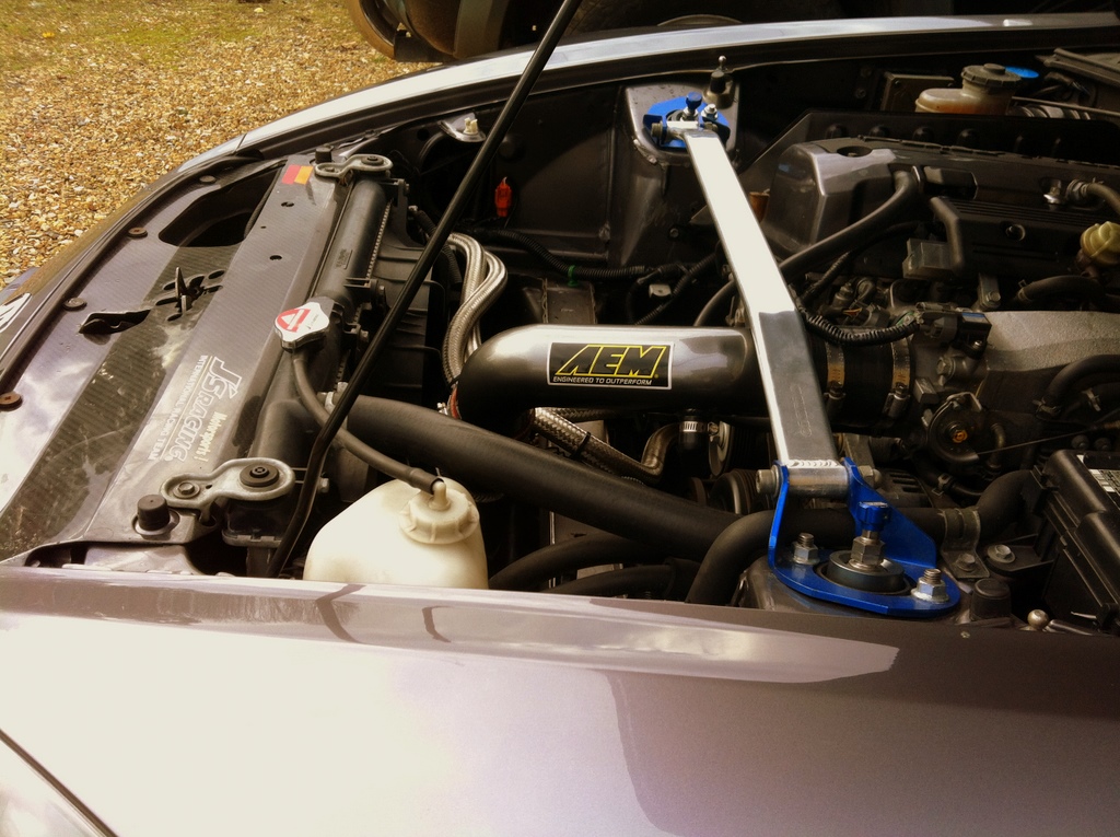

Quick pic of the AEM.
There's quite a positive difference in the throttle response, which is odd as the filter element is further from the intake. Impressive. Not as loud though, but i've not given it full beans yet.

I'd imagine a slightly better top end if tuned, a long intake tract suits high revving n/a cars. Spent a bit of time with intakes on a guys car, long wide tube yielded the vest gains.

Is that a V2 intake Mark ?
I loved mine, barking mad in VTEC, crisper throttle response and a couple of extra ponies !
Make sure you block over the drainage hole in the bonnet that sits above the filter.

Irv, It will also take out the resonsnace you see when mapping with the K&N. But i'm still a bit puzzled how it sharpens idle throttle response. It's markedly different.

Yep, V2, Lee.
It's still a lot quieter than the K&N at lower RPM (still not floored it) but i'm pleased with it. I only have the OEM bonnet on for the winter, then will go to the vented carbon one. Which hole do you mean though?

In the recess in the off side wing where the bonnet sits there is a series of 2 or 3 holes.
From memory they are the size of a 1p piece.
They are to let water drain away and one of them sits directly above the filter on the AEM.
A little bit of heavy duty tape is more than enough to block it off.
