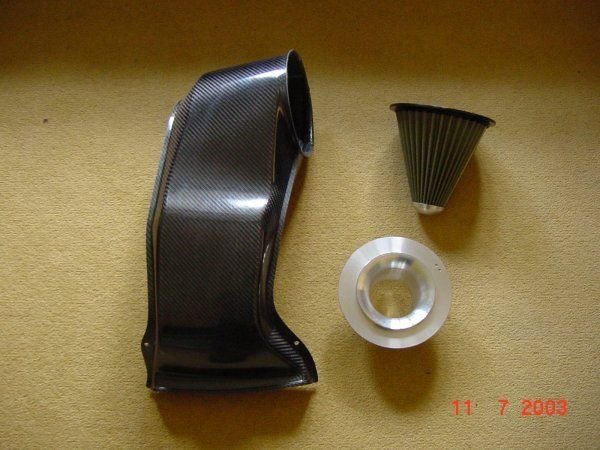

I'm having the Mugen CAI fitted on Tuesday
I'm sure Southern Counties will make a good job of it, but I have a question.
At the front of the engine bay, above the radiator, there is an OEM black plastic air guide, from what I can gather, it appears to direct the air coming in from the air damn onto the radiator. It is in this area that the Mugen CAI collects the air from. Does the OEM plastic air guide need to be removed? (I think it should be removed otherwise it will block the air from entering the Mugen CAI)

Fitting it will be simple if you take your time.
The bonnet cuts will require the correct tools and patience. The Airguide you mention has to be cut. Spares of this can be bought from Honda for less that 30 pounds.

yep, thats the one
the first and third pictures clearly show the black air guide is still in-situ (where the CAI dissappears at the front of the car).
The CAI collects air from this area, this is why I would of thought a hole would need to be cut in the OEM air guide to allow lots of cold air up to the intake?

It needs some cutting, but leaving in place. This is important IMHO if you run on track. Remove it and your car will run hotter.
If you want the instructions in English, pm me your email address and I'll email them.
