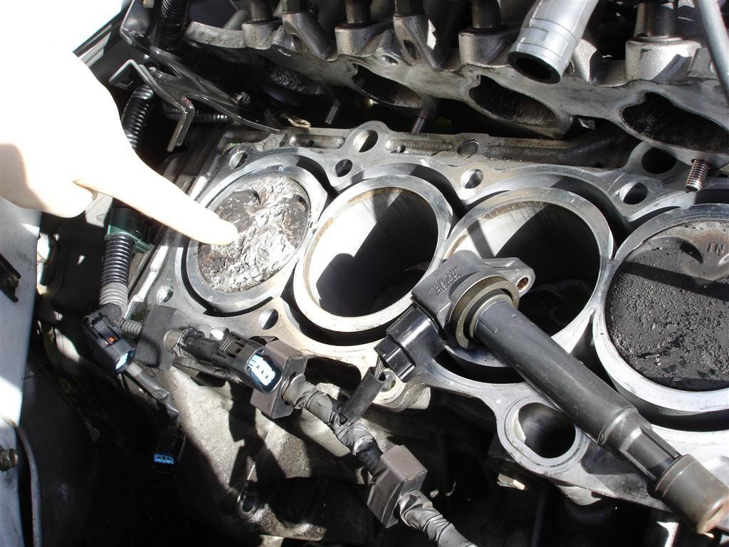

So I then decided to call my good friend Chris, he then took of the engine head and found a broken pieces of the cam follower? (Thing that connects the cam and valve springs) above the pot 4.
Anyway, next was the spark plugs. We took off one by one. The one in pot 4 was stuck, likely to be bent. Things were not looking good.
Later we took off the engine head and we could smell burnt oil, very bad smell. Once it was off, we found this...
One of the exhaust valve was broken and pieces had dropped and melted inside. All the other cylinder walls were badly scored and Chris concluded I needed a new engine.

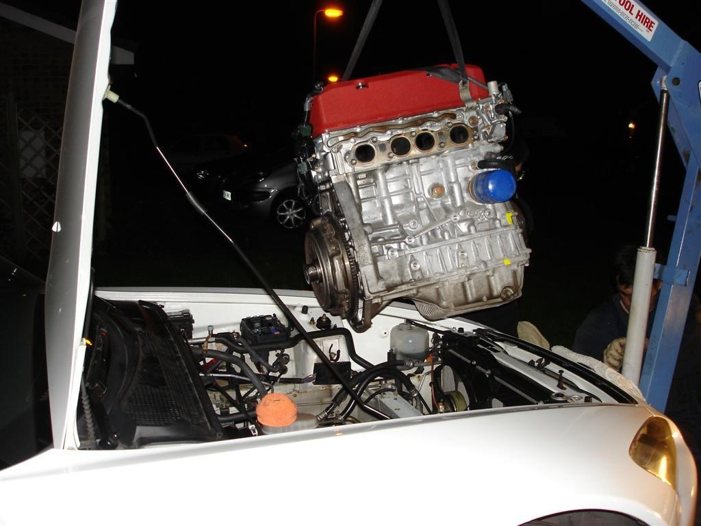

Crane ready
engine head had to be put back on to be on, then strapped on.
carefully lifting the engine out, making sure no cables/pipes were still connected
engine out!!!

new engine going in
oh yeah!!!
new gearbox on, it was such a bugger to get in and damn heavy!!!
