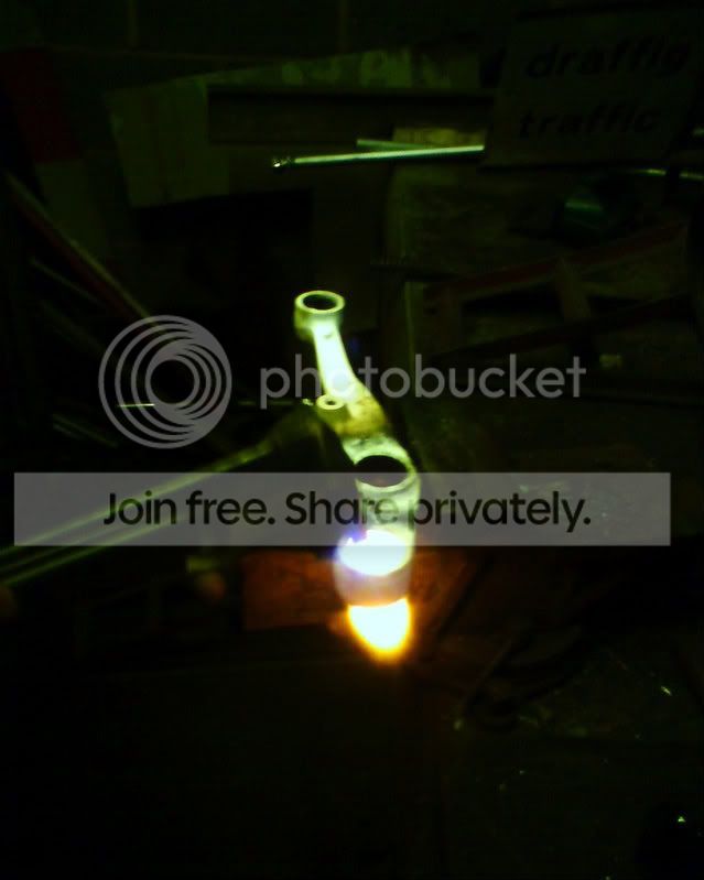

I'd say robs method was the best TBH
Although I am doing a rebush soon and I am going to cheat.
Remove all the arms, take them to your local garage and for about £50, they'll press em all out for you!
A lot easier than doing what I did...
