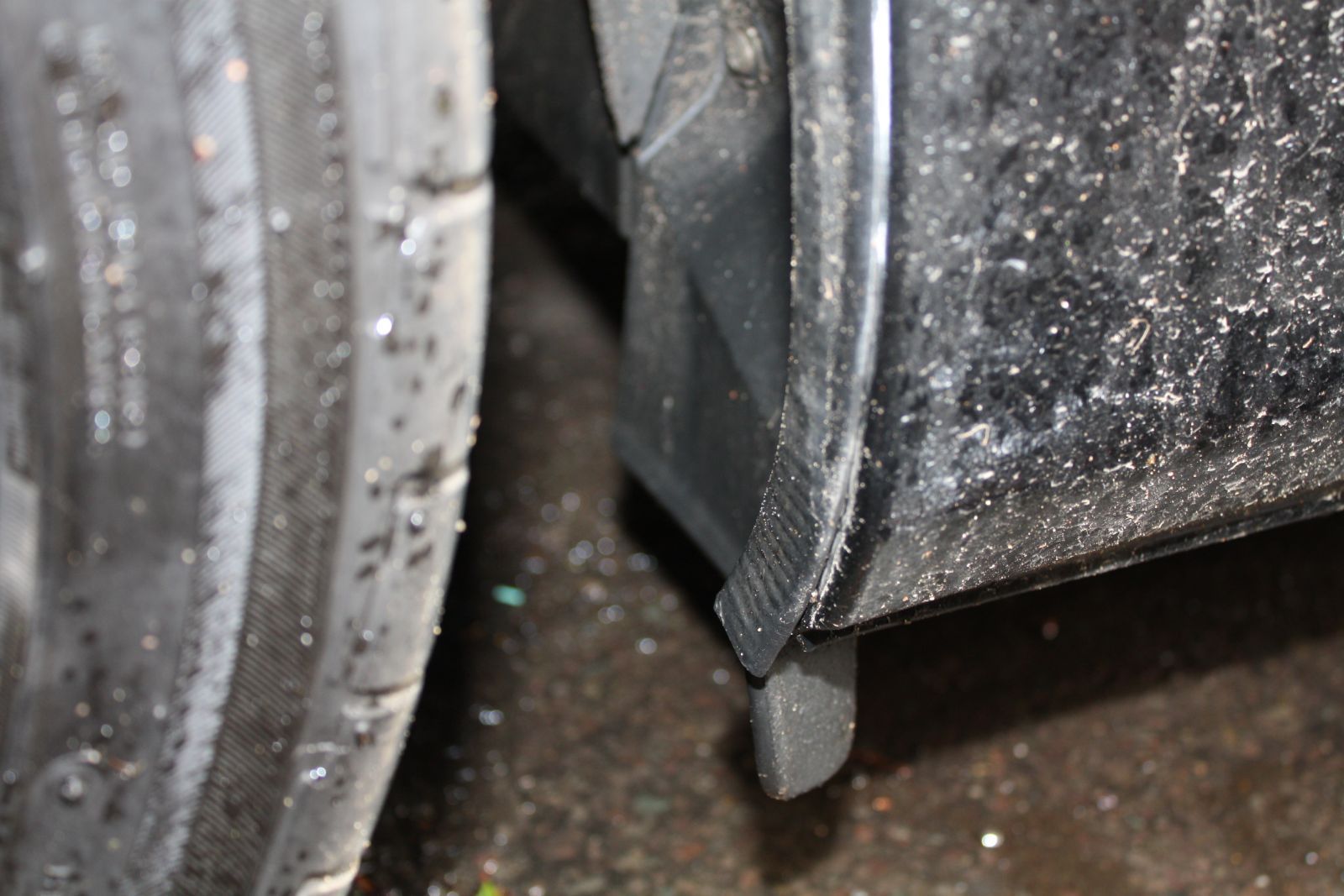

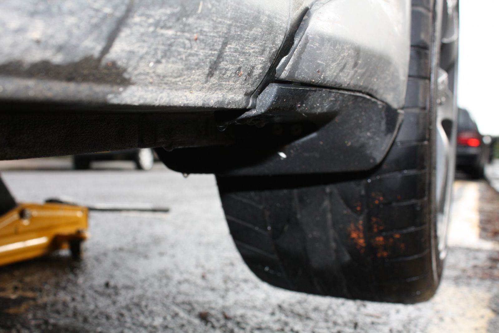

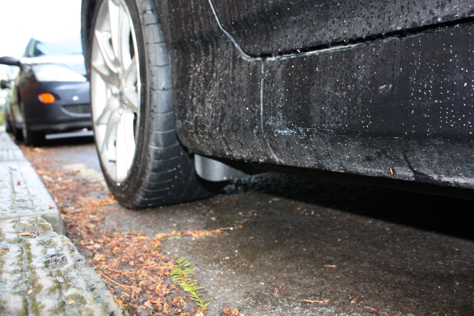

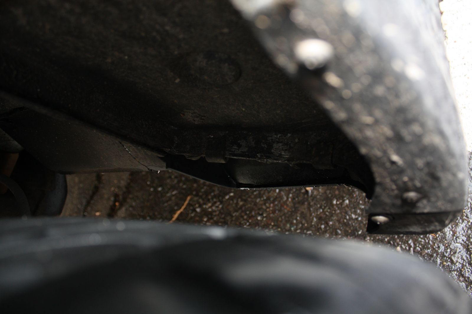

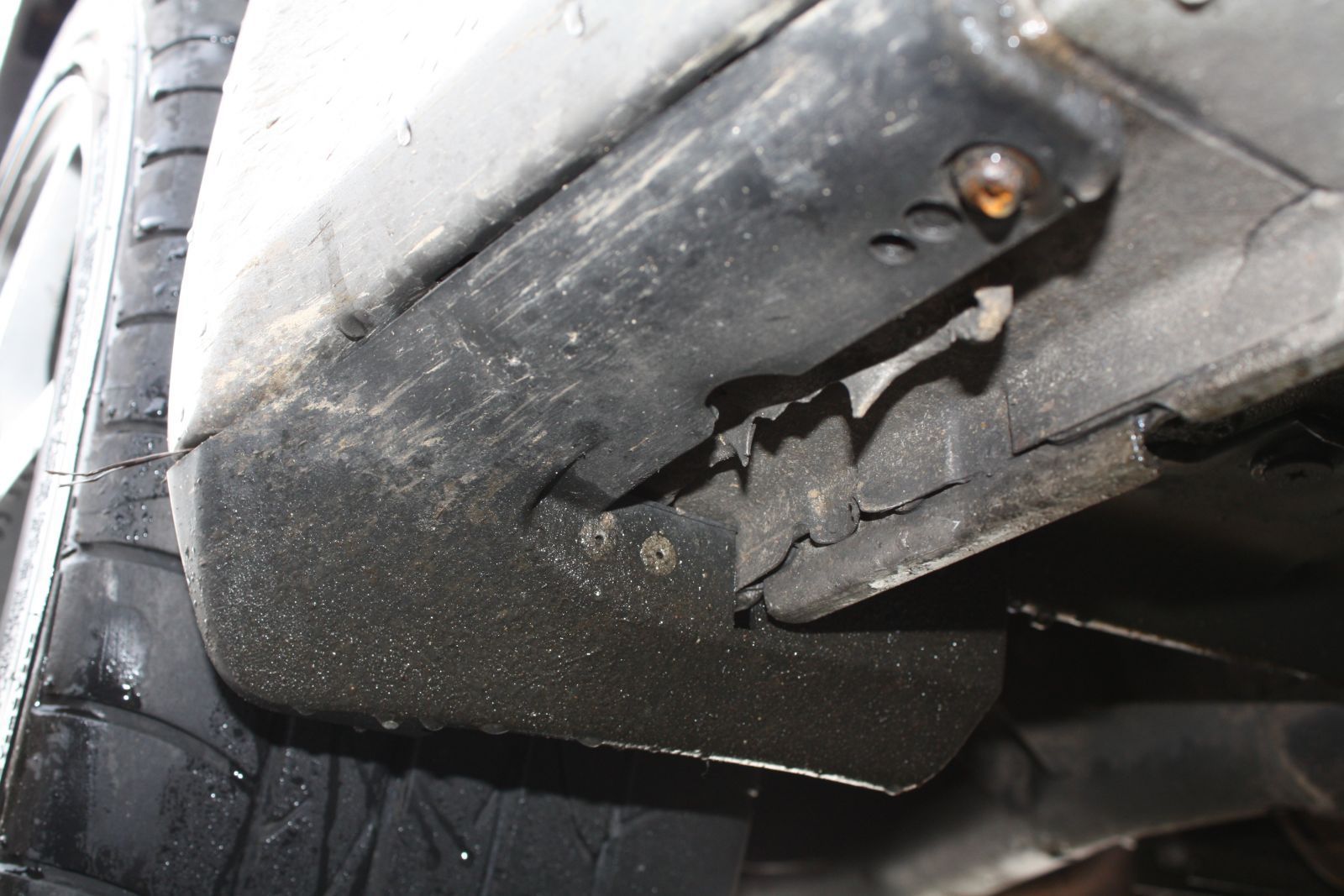

Pics as requested. Let me know if you want a wheel off pic and maybe a rubber off pic.
Fitting instructions and pics of parts
Honda fixings
My fixings
Standard aero part on newer s2000 (my nieghbors car)
With lower part of rubber strake installed
Without lower rubber installed.

Thanks for the pics Kitkat, Its the bit that you can just about see in the 4th pic down you have posted and called 'clamps' in the pdf link.
I'm thinking if I cant get hold of the clamps on their own somewhere then self tapping bolts may be the way forward...

self taping or nut and bolt - your looking at 5 mins work and 20p in cost as opposed to £300 from honda to get the part. It took me 18 months to actually have the confidence to drill the lil but it was no problem at all in the end...
