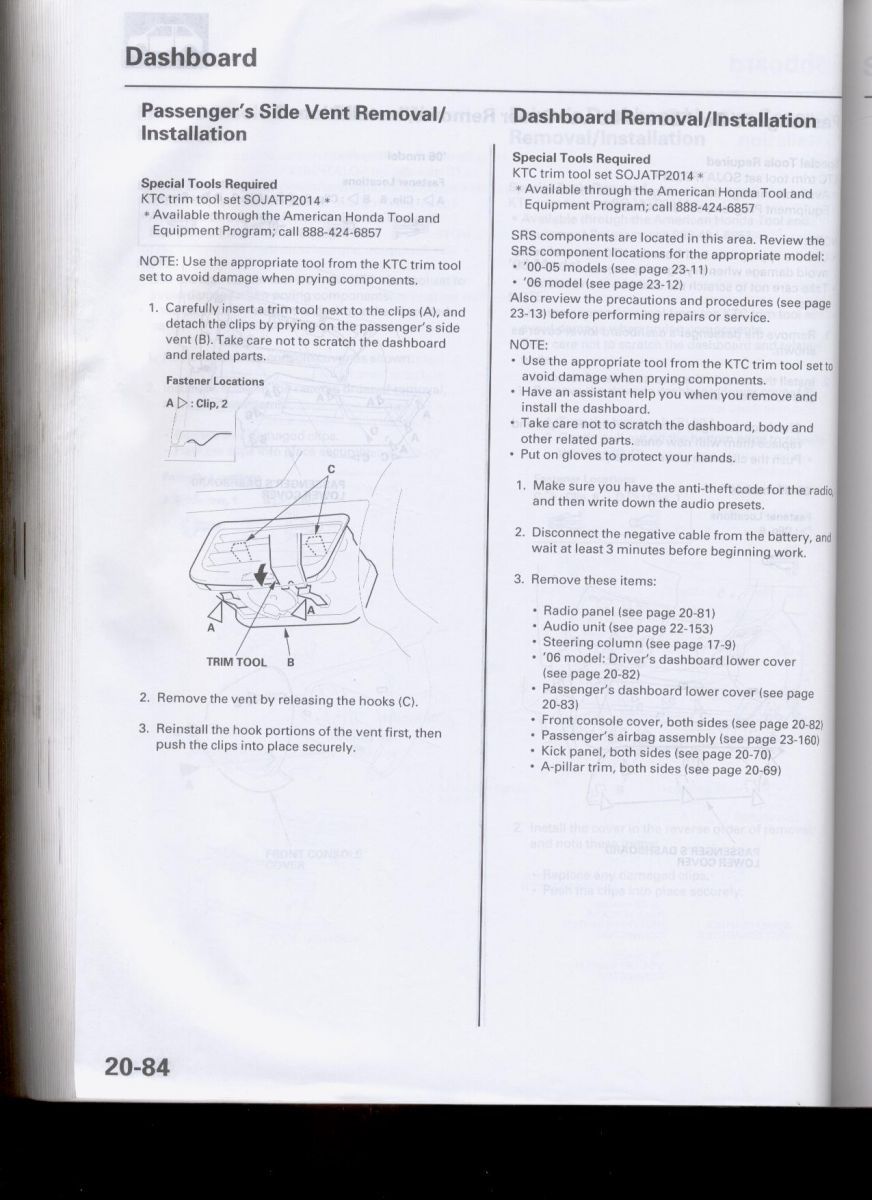

This might get you started. After scanning the pages, I realized there were several cross-references to other sections. If you want me to scan any of those other sections, let me know.

disconnect the battery to be on the safe side if you'll be anywhere near airbag stuff

I kinda figured on disconnecting the battery.
Do I need any special tools to get it out (and back in)?
