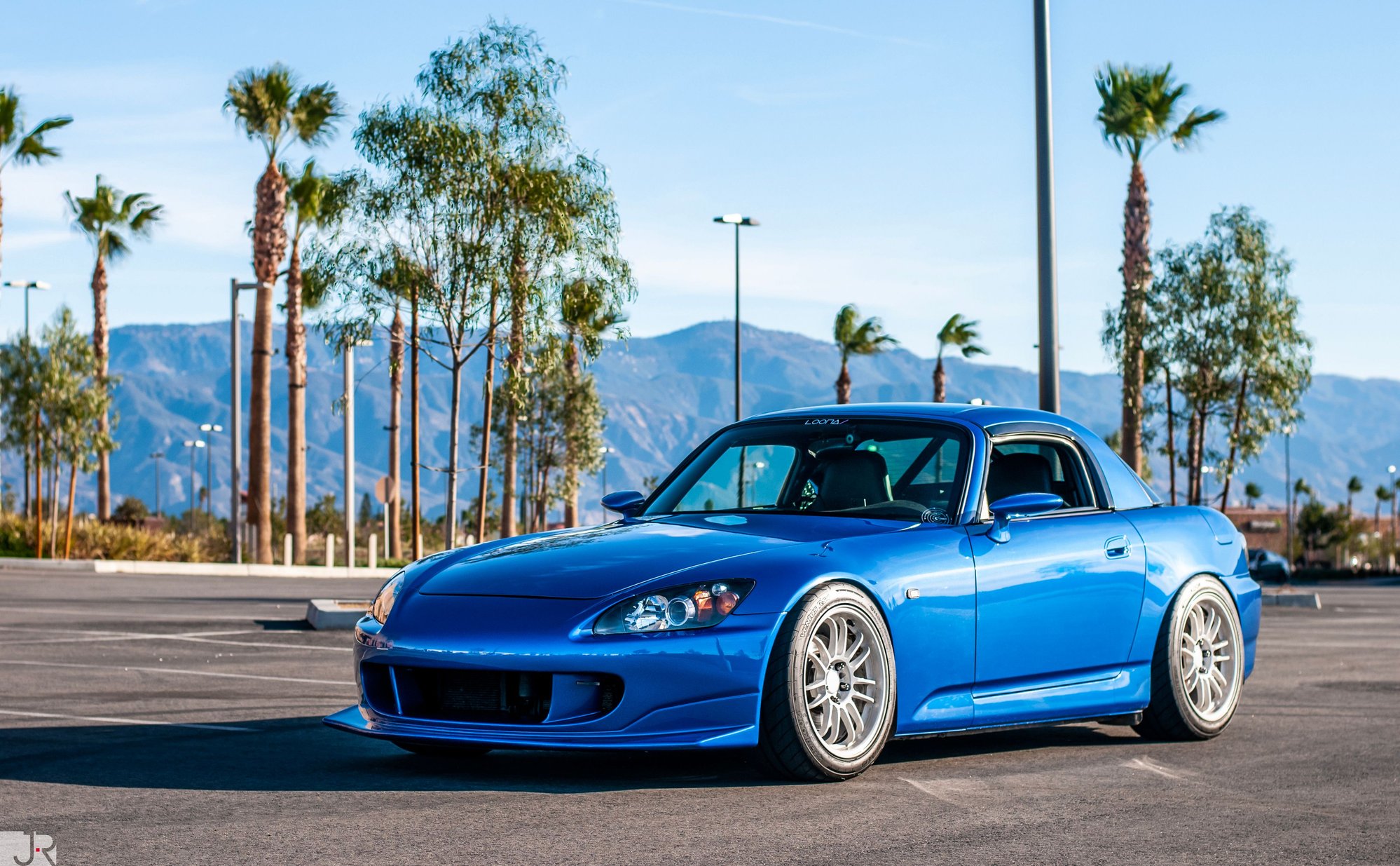

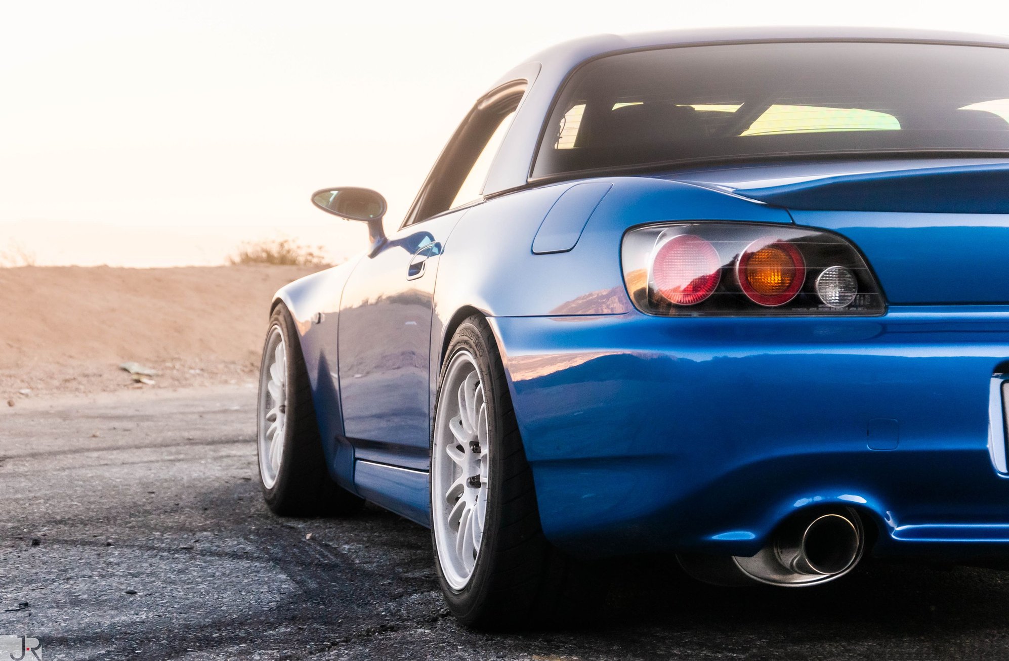

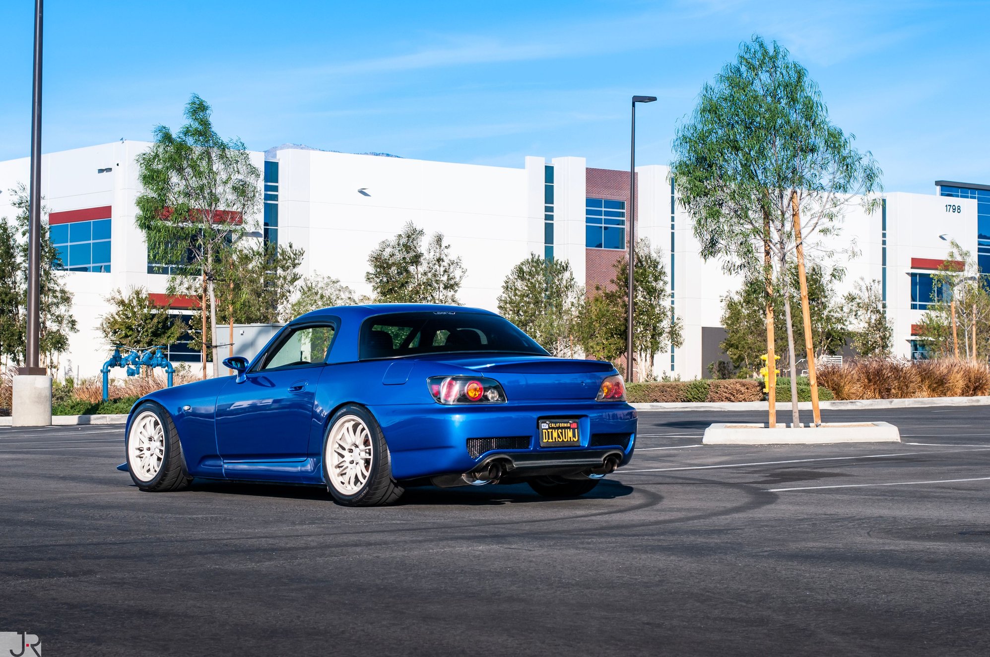

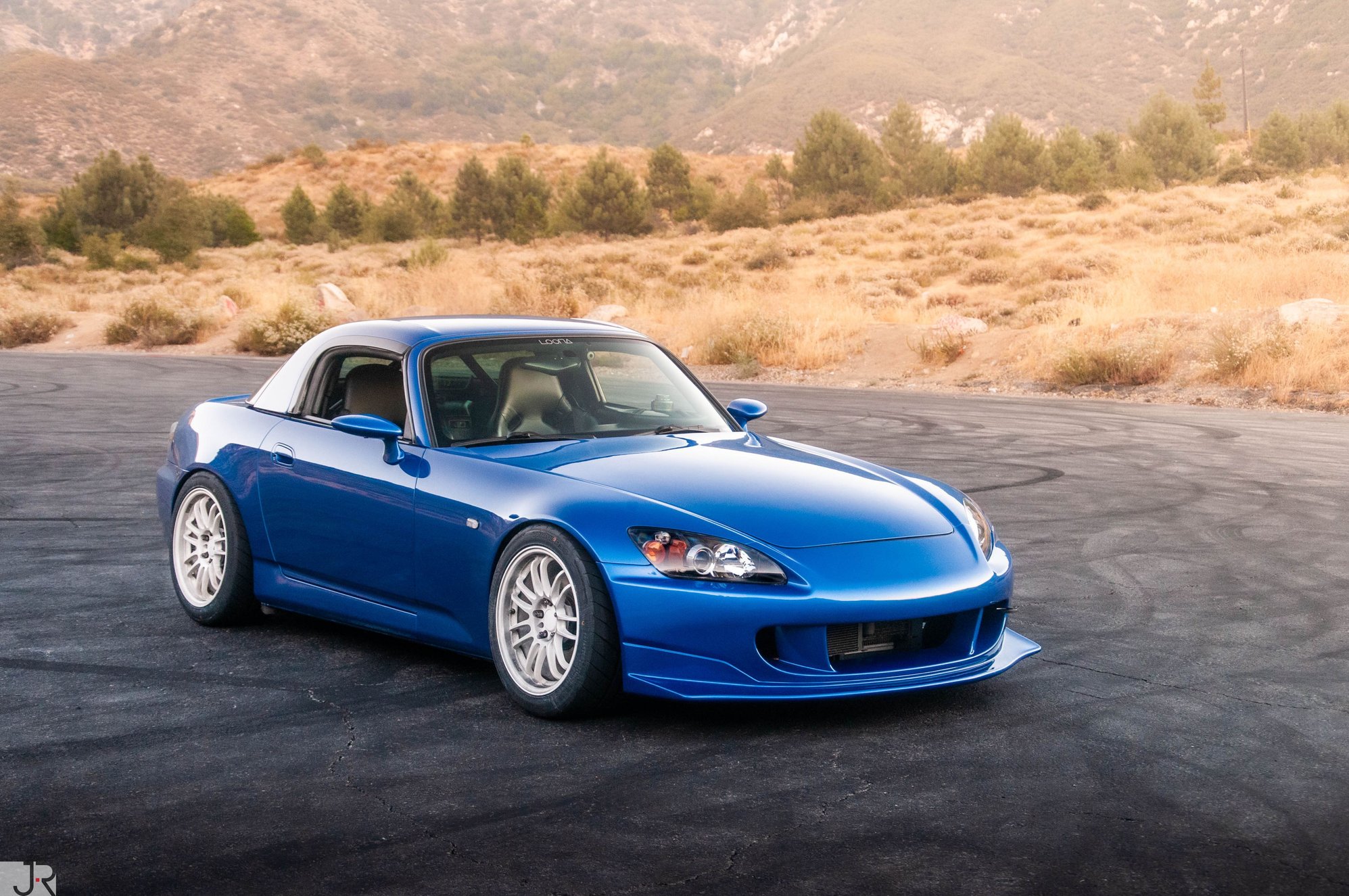

on my setup, I am running 17x9.5 +40 255/40 Hankook RS4. I am on OEM body with rolled and pulled fenders, running -3 camber all around. I am also pretty low, maybe a half-finger gap between the tires and fenders, shaved and relocated rear bumper tab.
