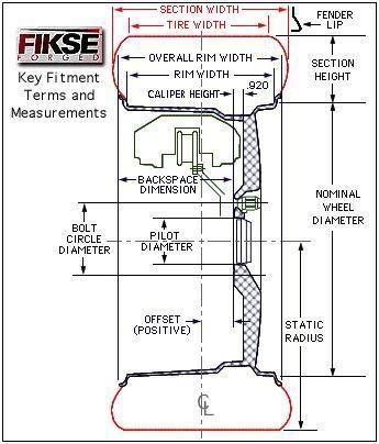

Rolling radius is what matters. The taller the sidewall the more it deflects under load resulting in the same Revolutions per Distance so 16's should stand taller than 17's and likewise 18's are shorter for the same rolling radii tires.
As far as rubbing with the 225/50-16 which is even narrower than '00-'03 stock tire, that's got to be due to the offset being too low on the 16's

definitely wrong offset on the wheels.
Here's a diagram to help you understand what offset is:
I would ask the place that sold you those to supply you wheels that "fit" the car ...... that's

[QUOTE=Suphawk,Feb 24 2005, 08:16 AM] Not sure what you mean about correct offsets, I guess I don't know what offsets are

Yes I can see the picture. Interesting what I ment to say was I got the exact size tires not the rims I guess. Although they don't stick out past the wheel arch. I'll take some pics and post them so you can get what I mean.
Thanks for all the info, I guess I shouldn't have trusted the tire store to get the sizes right, I did verify that the tire sizes are correct though.
