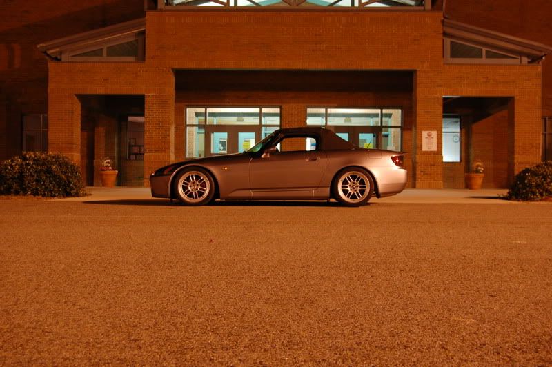

17x9 +45 in rear with fender roll and -3 camber or so in the rear! N cutting the bumper or relocation of the bumper tad. Here is a picture.
Best I could find:
