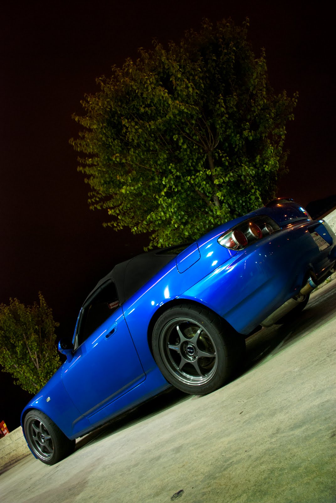

I wouldn't go any bigger than 235/40 width tire in the front for the 7.5
265's will stick out quite a bit but still looks manageable. It's not the width you have to worry about, its how tall the sidewall is. 265/40 is a tall sidewall. Had 265/40 starspecs as my previous rear tires on a 9" wide wheel. I had to raise my rear 1/4-1/2" to clear my fenders due to a taller sidewall.
Here's a pic...

Hi, thanks for the reply and picture
Do you know what offset you had on those wheels?
We surely don't want them rubbing in rough roads or potholes..

17x9 +45 all around
But add in another 5mm because that is how much more the tire is going to come out past the rim/wheel.
