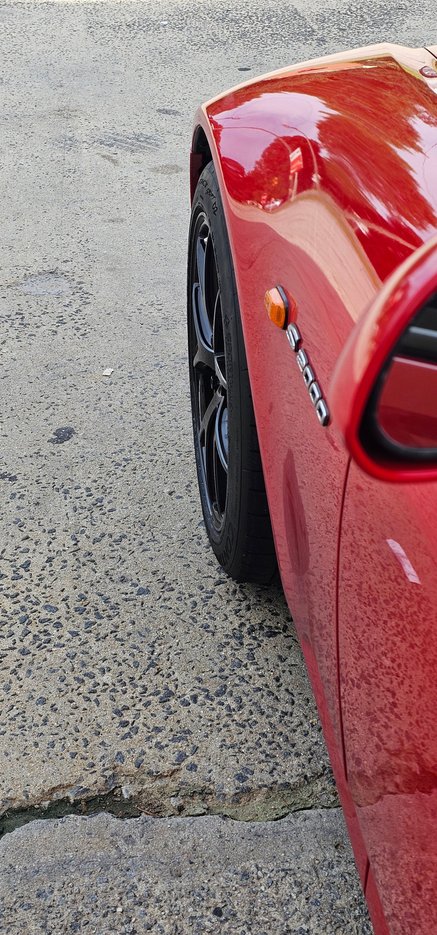

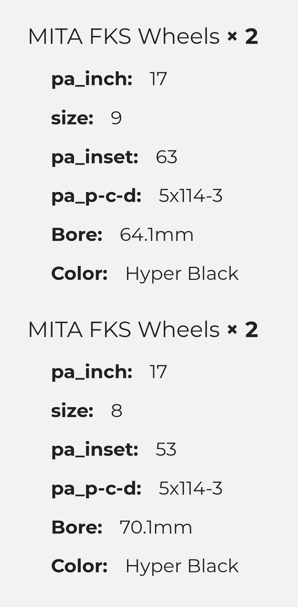

Originally Posted by miknieves
What tire size did you end up with?
Ended up going 17x8 ET53 MITA FKS wheels with 225/40R17 in the front and 17x9 ET63 with 255/40R17 in the rear. Lowered about 1/2" on Öhlins with a 2 finger gap up front and about 1.75-2 in the rear. Offset fits about as well as I hoped. Front is great, could use another 5mm or so in the rear, but I don't know if I want to run a spacer.
