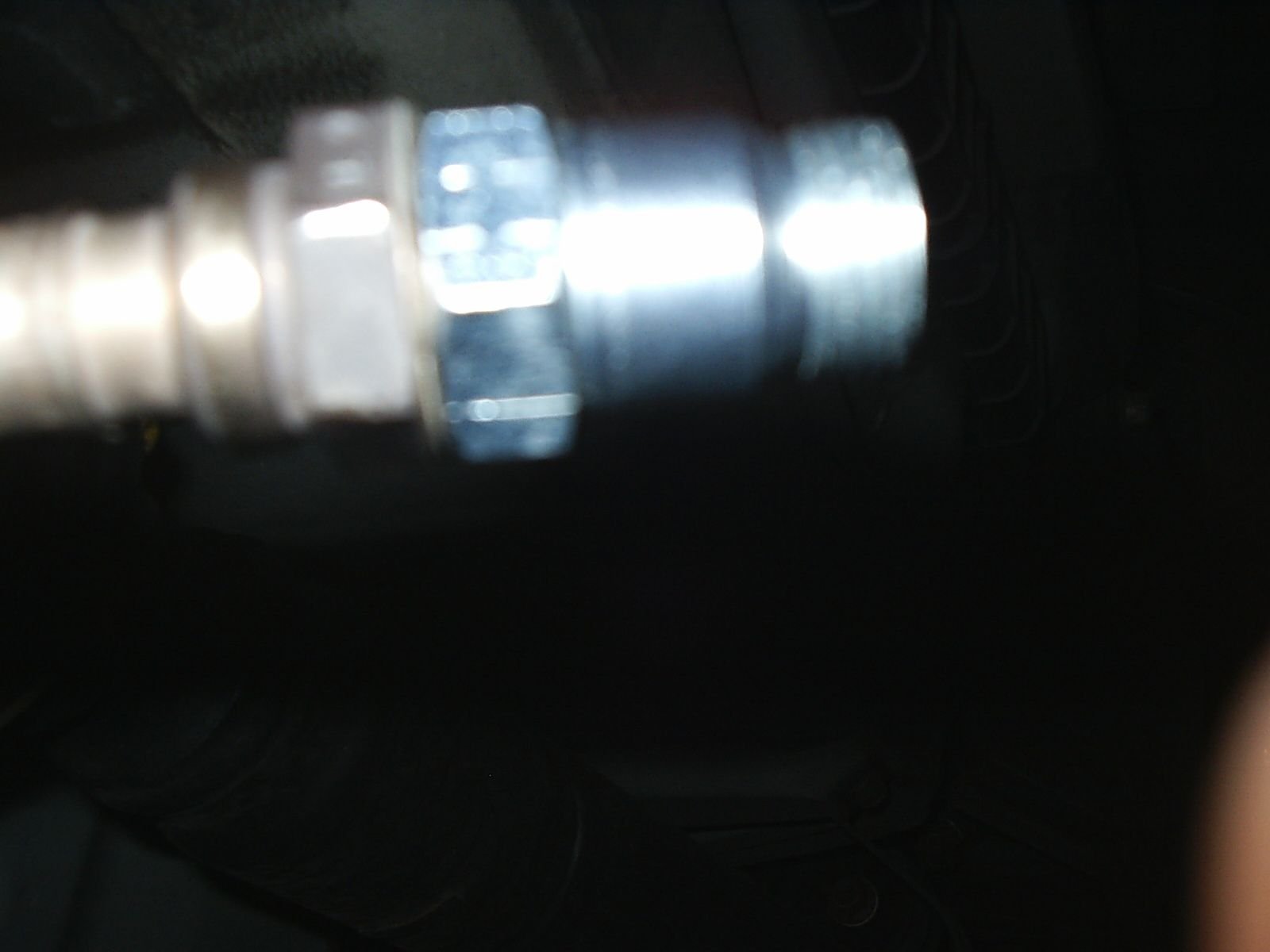

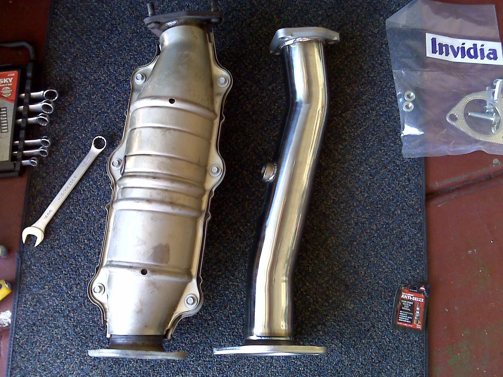

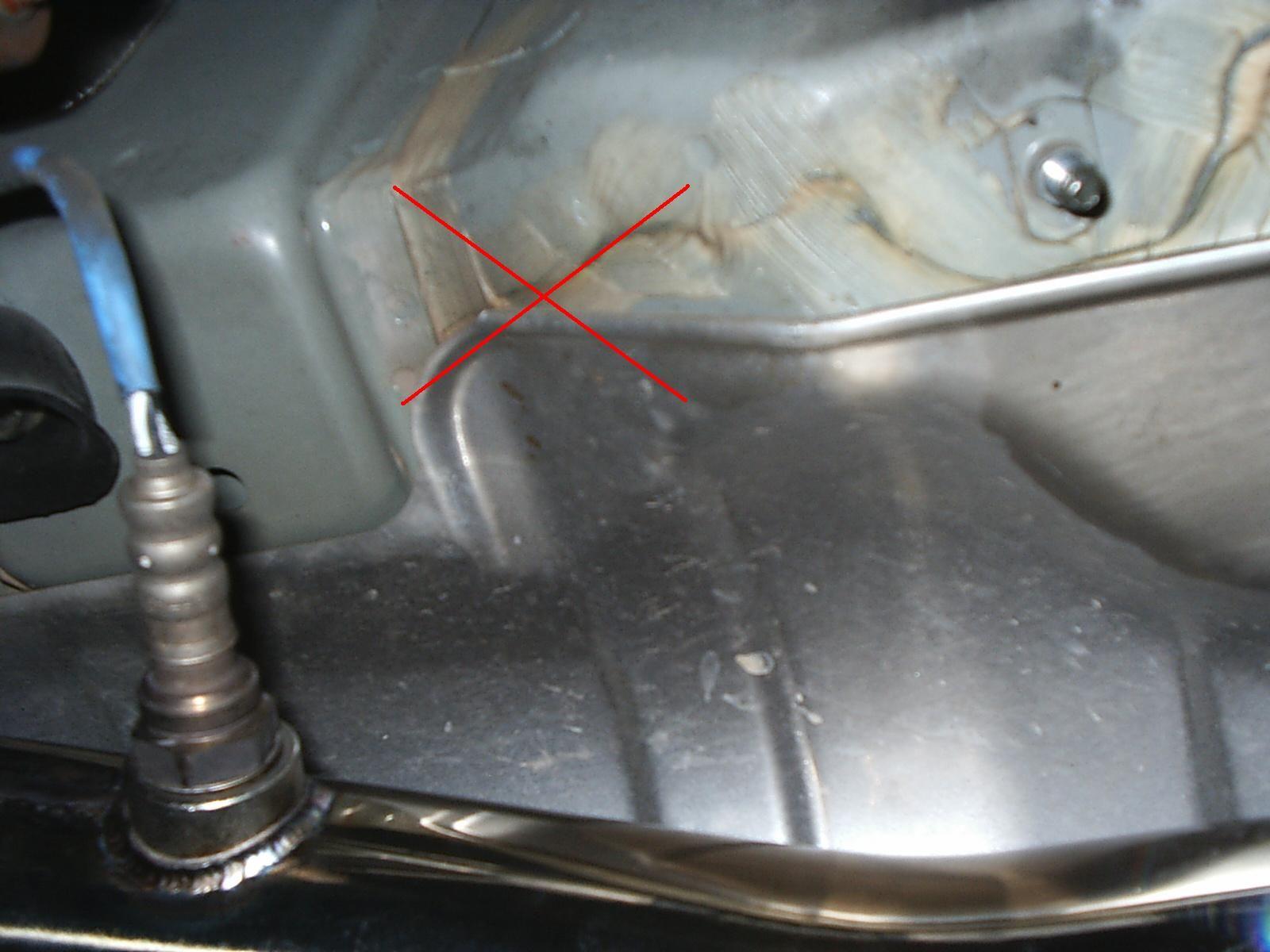

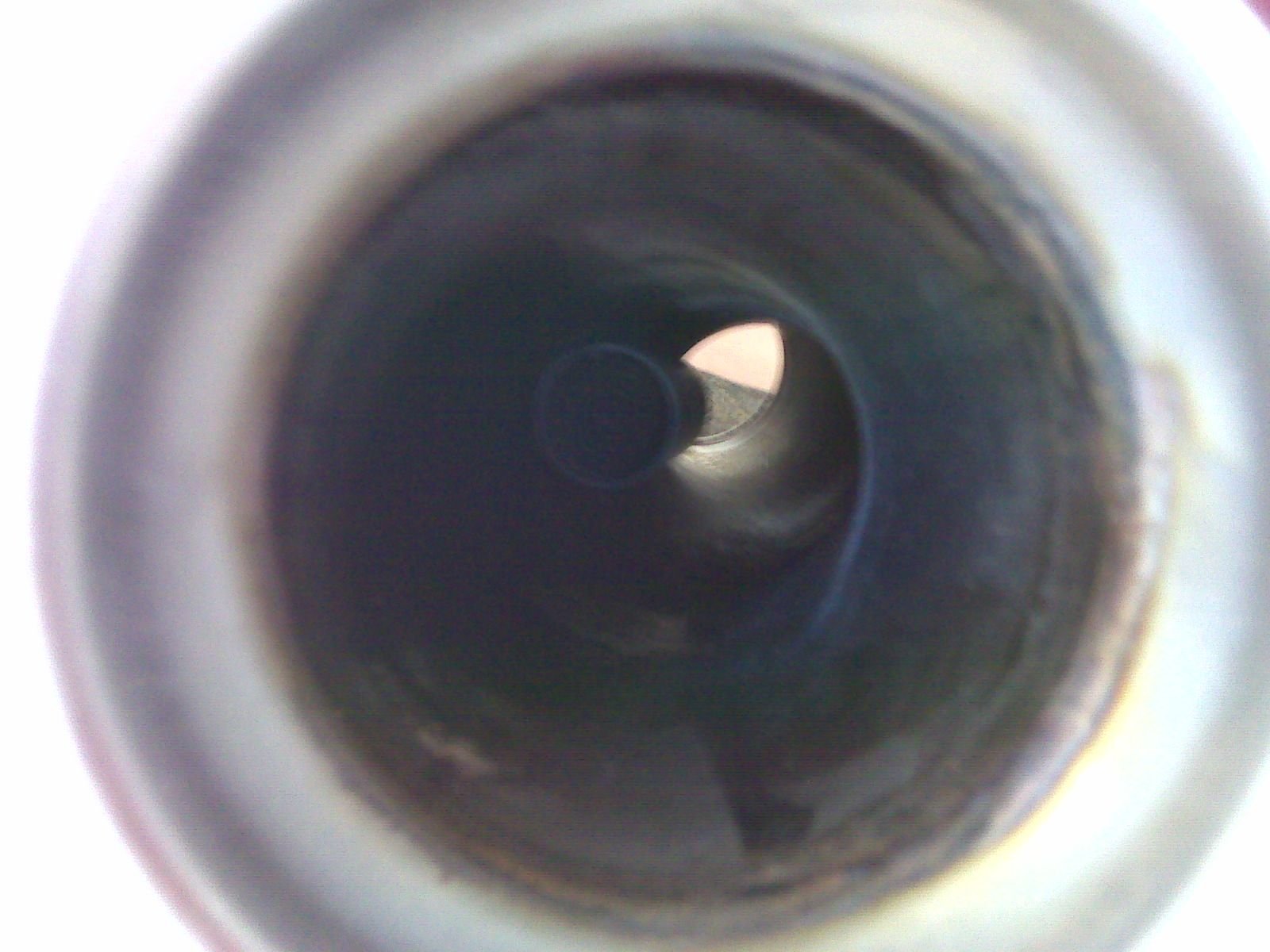

Whats up AZ people? Not too long ago I put a test pipe on my stock exhaust and thought I'd share my CEL FIX experience. I got an invidia test pipe and it "came" with cel fix in it. BS, took the ECU about half tank of gas to realize that things aren't right lol. So I went to autozone and got the "spark plug antifouler". Bored one of them so the O2 sensor can actually fit through it and just screwed the other one on. About 100 miles after the install, the CEL went off. I didn't even reset the ecu or anything. Anyway, on to the pictures:
Comparing the two (btw, the cat is about 20-30 pounds):
Bored vs the way it comes:
Iv been reading positive comments about this set up when it comes to CEL. Some run 3 of these in order to shut it off, but in my case 2 worked just fine!
