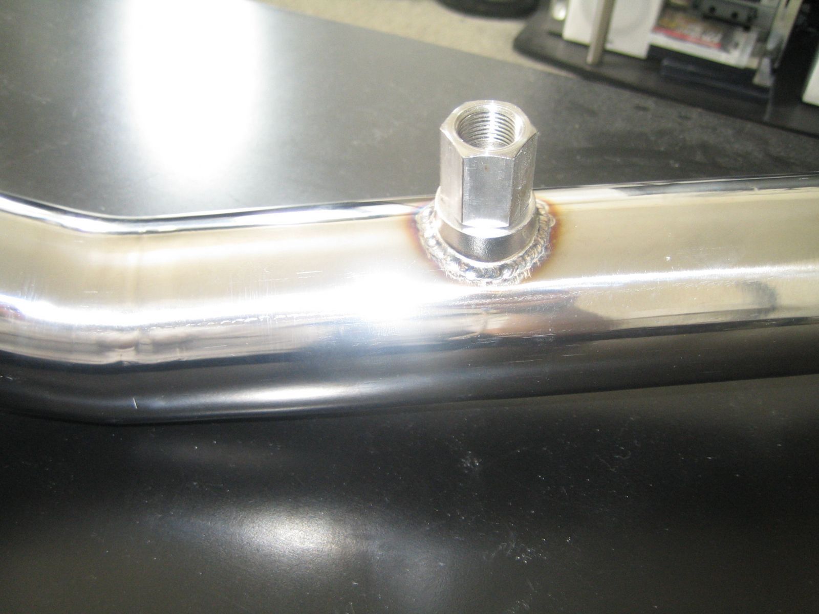

Hey, I just got this today, looks like I won't need to do the spark plug anti-fouler method, this looks like it might be far enough away, what do you guys thinj=k?

From: in my garage
Same idea.

Same idea.
so it should work right?
It 'should'. But MY06+ seem to have a more sensitive o2 sensor so it's still up in the air until you run it for a while. good luck

Mine came with the installed CEL fix (the mesh screen wind sock).
It did not work with my setup and threw a CEL anyway. I just added the antifouler fix to it and presto!!!....no more CEL (after resetting ECU of course)

i have the same test pipe with the cel fix, and i've been running my car for about 3 weeks with it and so far no cel light.

No it doesn't look good.
The offset may be ok but there is no reducer hole at the end.
This is what you want ($12 bux from inlinefour.com)

I made one with the "HELP" brand ones from a local auto store today for my buddies Evo MR he's been praising me all day for it lol but I bought one similar to the "blox" just to look nice lol
Same here, got two of the "HELP" antifoulers on for over a year.

the internal built-in fix did not work for me, i had to add the external fix and that did the trick, no cel since.
