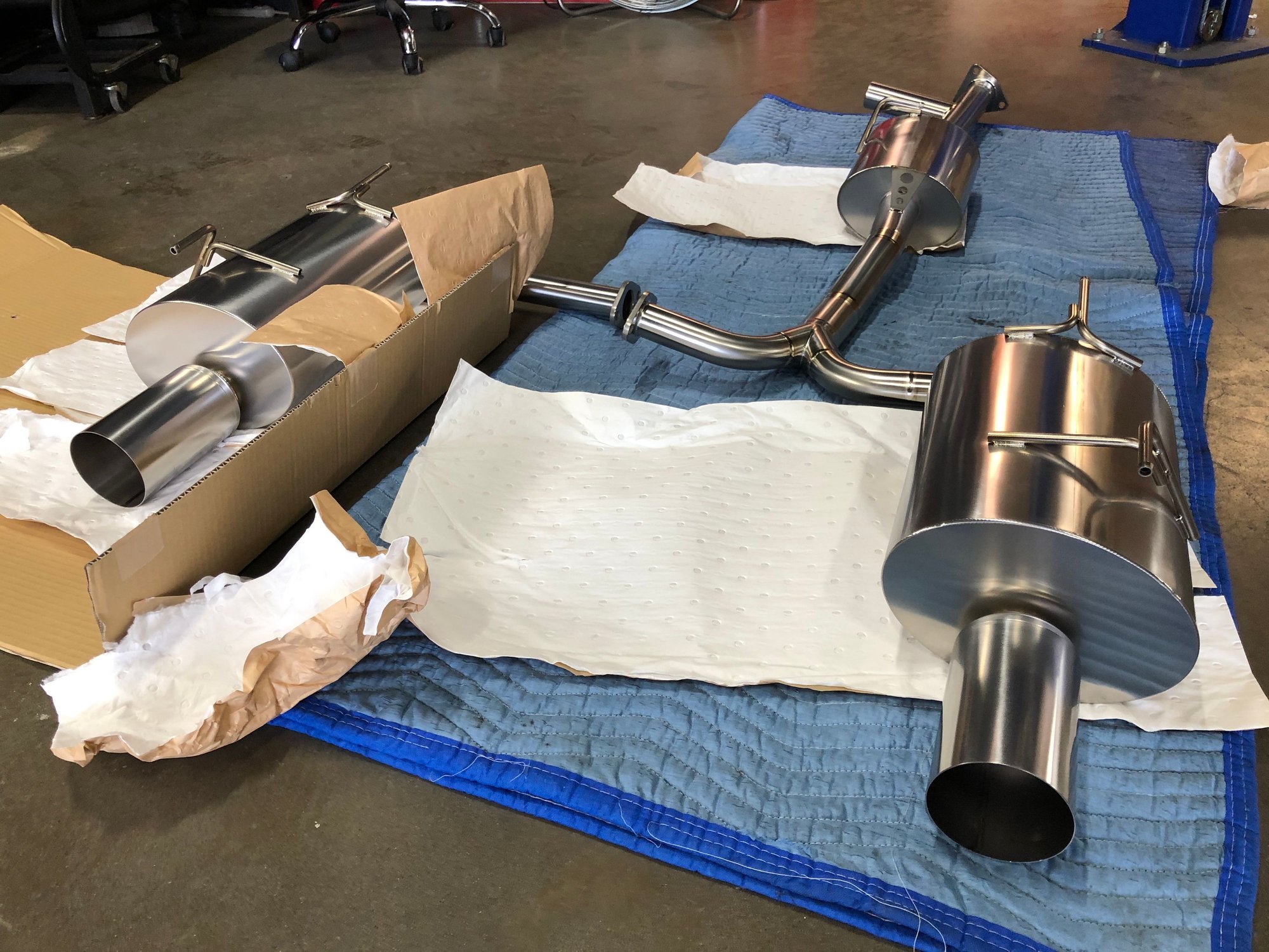

Fast forward another 6 weeks or so, a new R1 Titan Euro exhaust was completed and delivered! This time it wasn't broken, so it went on without a hitch.
My first impression of the exhaust was nothing short of excellent. Sound wise its very compliant at lower revs, and its easy to forget that there is an aftermarket piece on the car because there is no drone. Once you get upwards of 5k RPM or so, you really start to hear it sing. Its louder than stock, but its not obnoxious and you definitely won't kill your hearing abilities with it. The biggest surprise that I wasn't expecting was how the car actually drones less when you let off the throttle around the 3-5k RPM zone.
A key factor that lead me to this exhaust over others was the titanium *zing* noises I read about and heard through youtube videos. It is not quite as pronounced as I expected, however some of these other samples were using test pipe / HFC, which would effect the sound. Regardless, I have to get the revs up into VTEC territory to really hear the titanium sounds, which is the perfect excuse to drive the car as intended. I had the chance to take this through a tunnel with the top-down and I couldn't wipe the grin off my face for the remainder of the drive.
Overall, I would recommend this exhaust to an enthusiast who is looking for a unique and pleasant acoustic enhancement to their S2000, without drawing unwanted attention from the general public.
Props to my mechanic for further cleaning the exhaust once it was on the car, it truly is a piece of art!

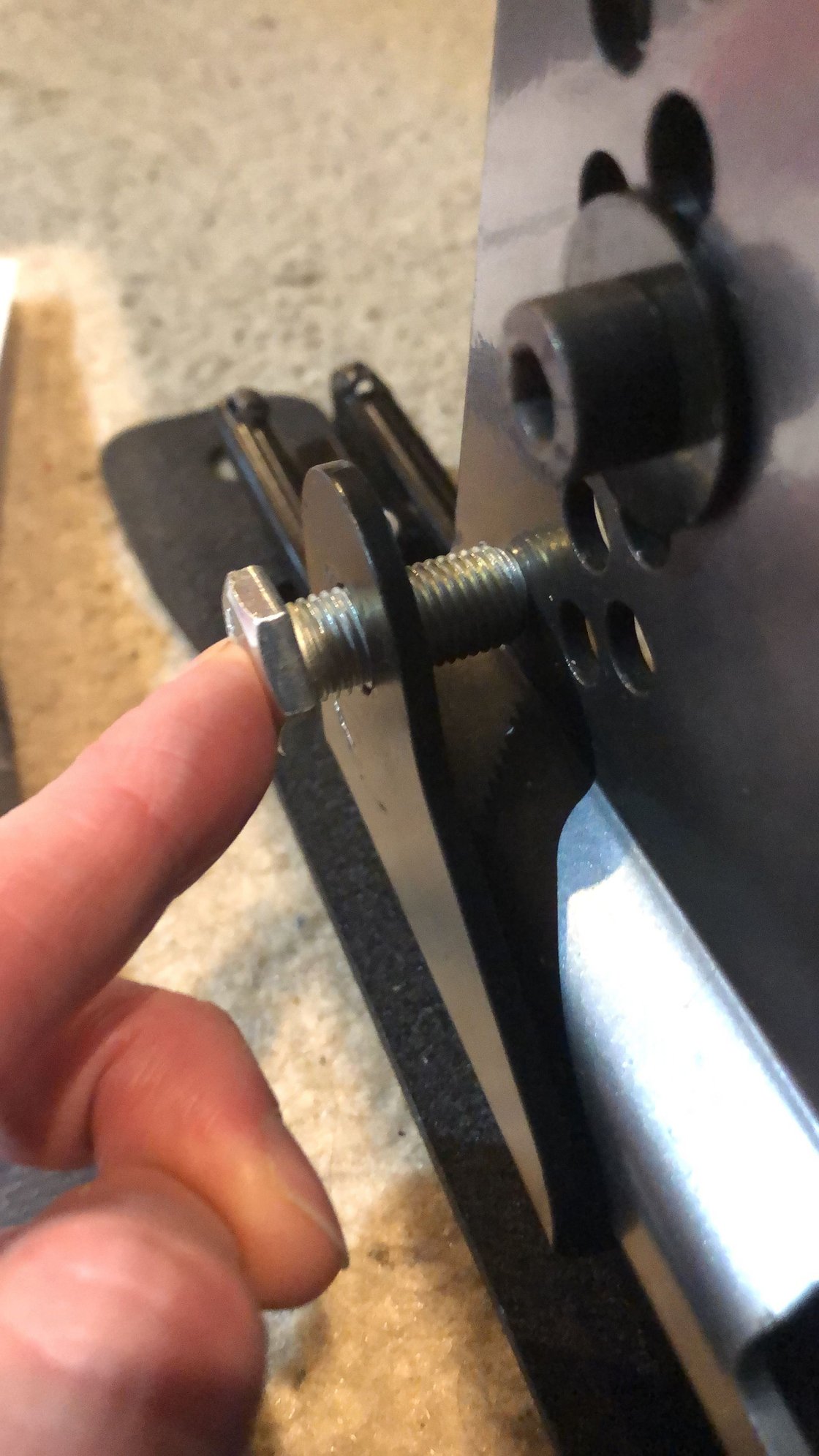

*IMPORTANT NOTE* In Andrew's example he used a 25mm bolt, however I noticed that this actually stuck out too far for my application. After some back in forth, the only plausible explanation is that the rail design has been updated since he posted (or I butchered the install somewhere along the way lol). I picked up a generic brand grade 8.8 20mm 7/16in bolt and matching nut instead and it worked fine. The only caveat is now I don't have room for the pivot, but so far that hasn't caused me any issues not having it on. I guess I could mount the pivot and belt on the outside of the seat rail instead of the inside, but for now I'm happy.

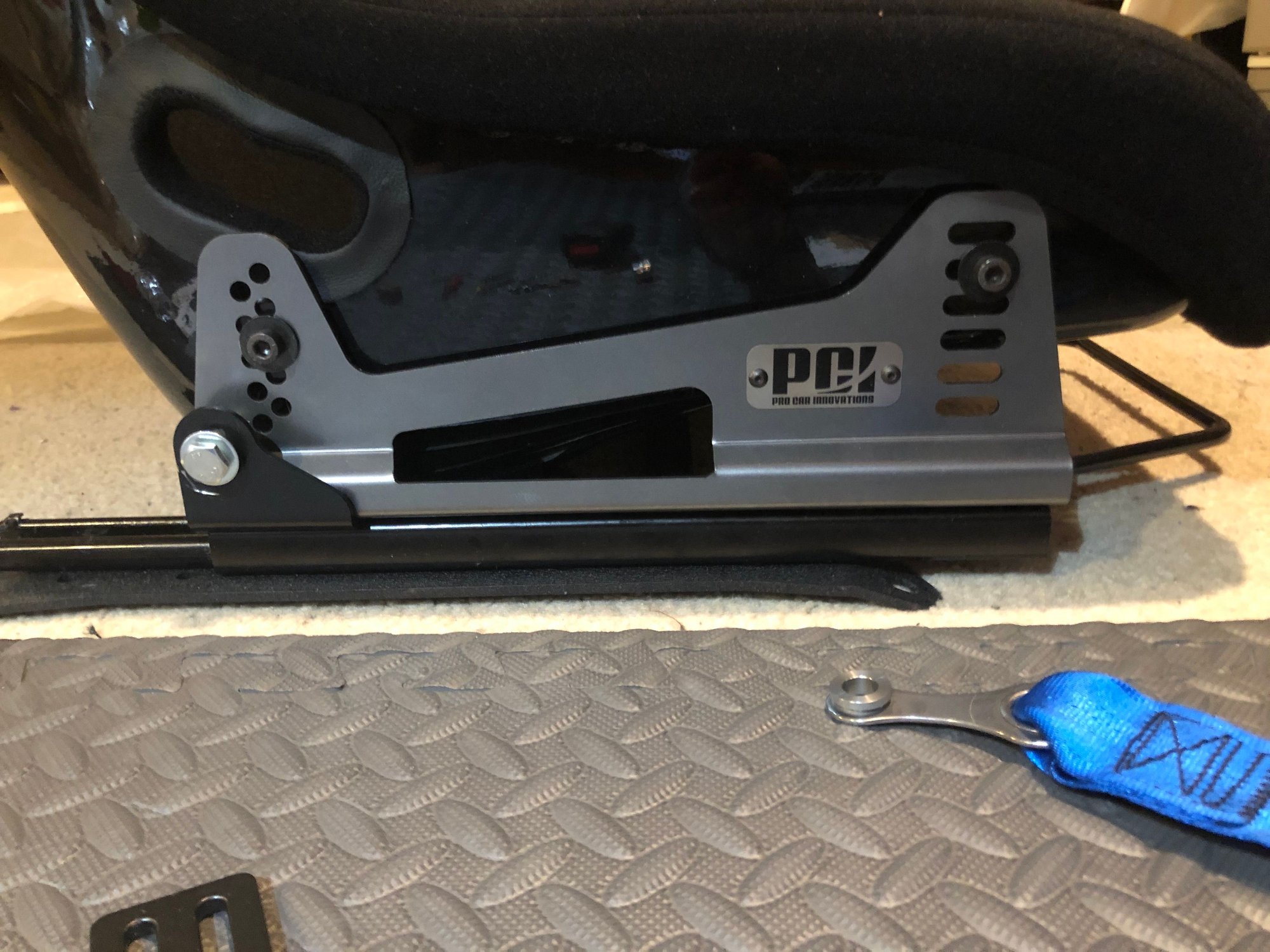

Here is how I positioned the seat on the rail. It actually looks a bit different than what I said I copied from Andrew above:
Here are the part from Schroth laid out. Remember I replaced their 25mm 7/16in bolt with a 20mm 7/16in bolt.
Heres how the 25mm was too long for my application. Again, I don't know why 25mm didn't fit for me while it worked for others in the past. Looking at Andrews rails, it appears the design has changed slightly.

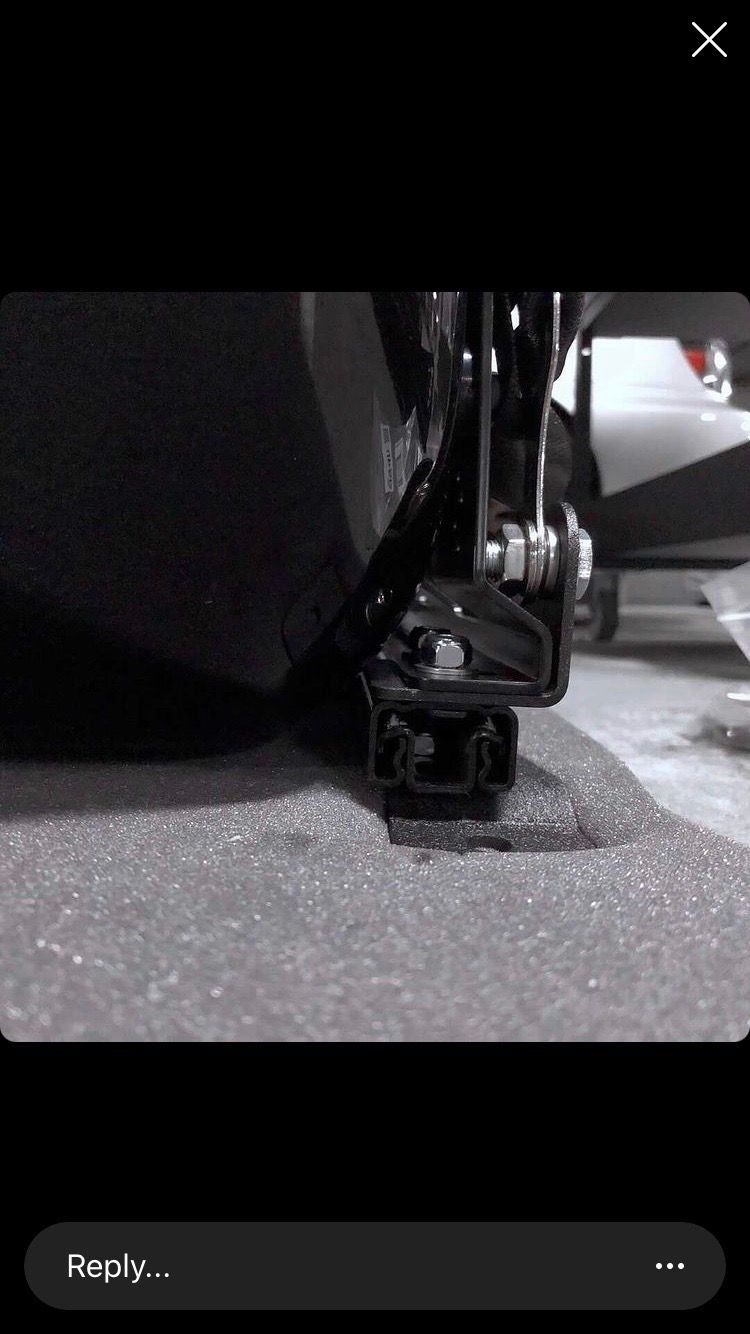

Here is the looping of the belt through the 3 bar slide. This is loose, just for the sake of mocking it up. I tightened it before installing.
Here is mine assembled with the 20mm bolt, followed by Andrews with a 25mm bolt. Remember, I do not have the pivot on mine since there isn't enough clearance between the seatbelt mounting point and the inner base of the rail.
