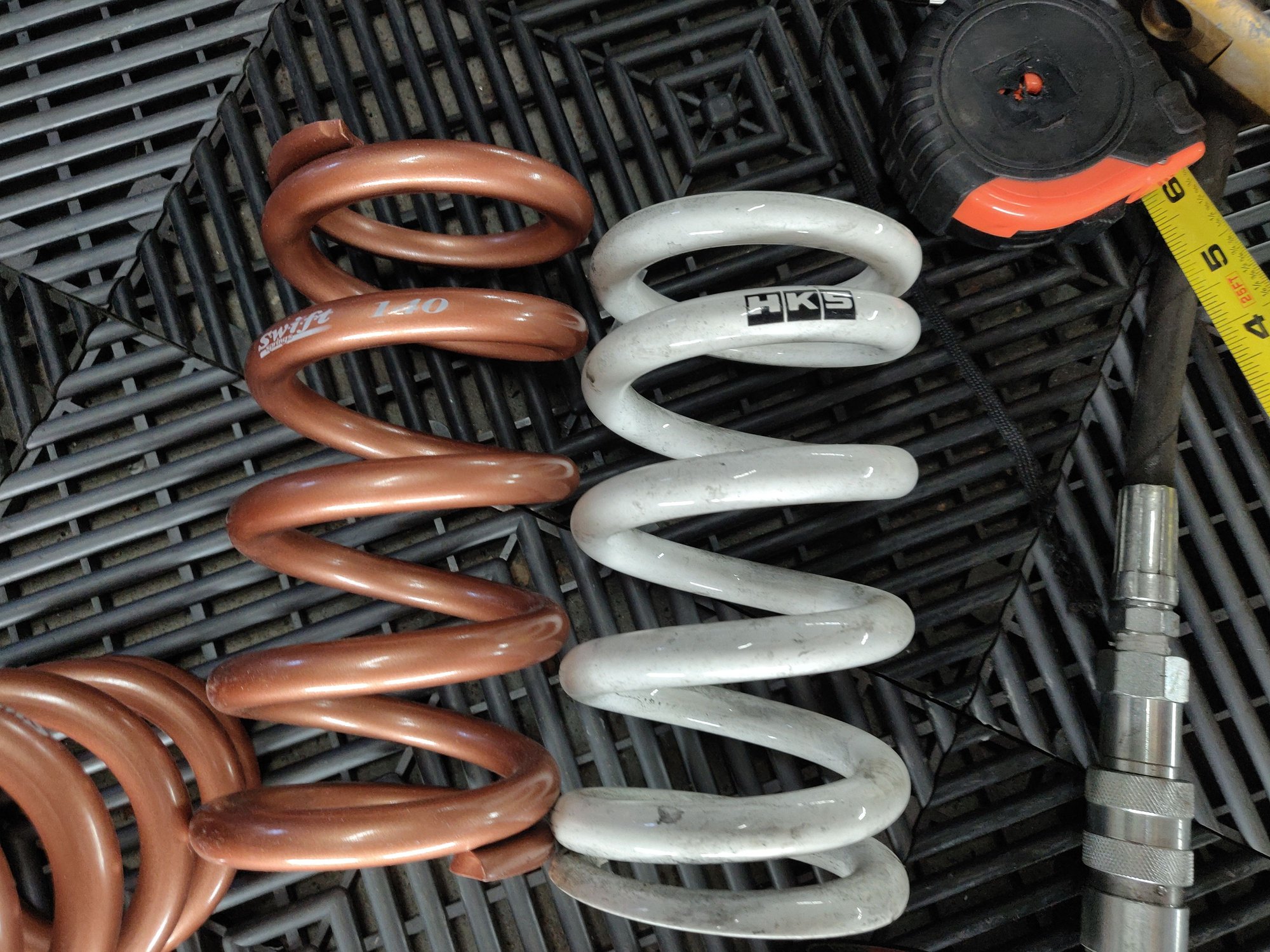

The most noticeable upgrade I have done was switching the stock HKS 16k springs to a 14k Swift springs. Before, any kind of medium to big bump at speed would upset the car. It felt like the spring compressed a bit and launched the car into the air. The car also felt twitchy at the limit as if the car was fighting for grip between all 4 tires. With my limited driving with the 14k springs so far on some backroads, I immediately noticed the feeling of the tires "grabbing" the road more. Steering feel has increased and smaller to medium bumps no longer launched the car off the ground. I could get on the throttle much more aggressively as the rear feels more planted and won't break loose as easily. Bigger bumps still upset the car but nowhere as bad as the 16k springs it came with. Car settles down much quicker and isn't nearly as sketchy.
Will be excited to test during a track day soon to see how the car feels at the limit.

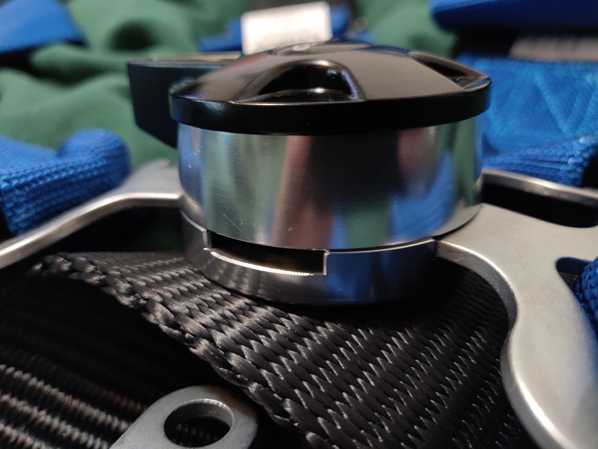

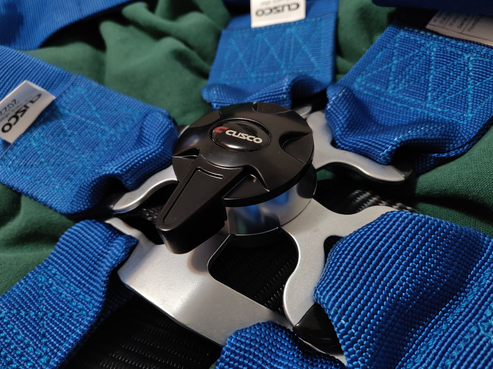

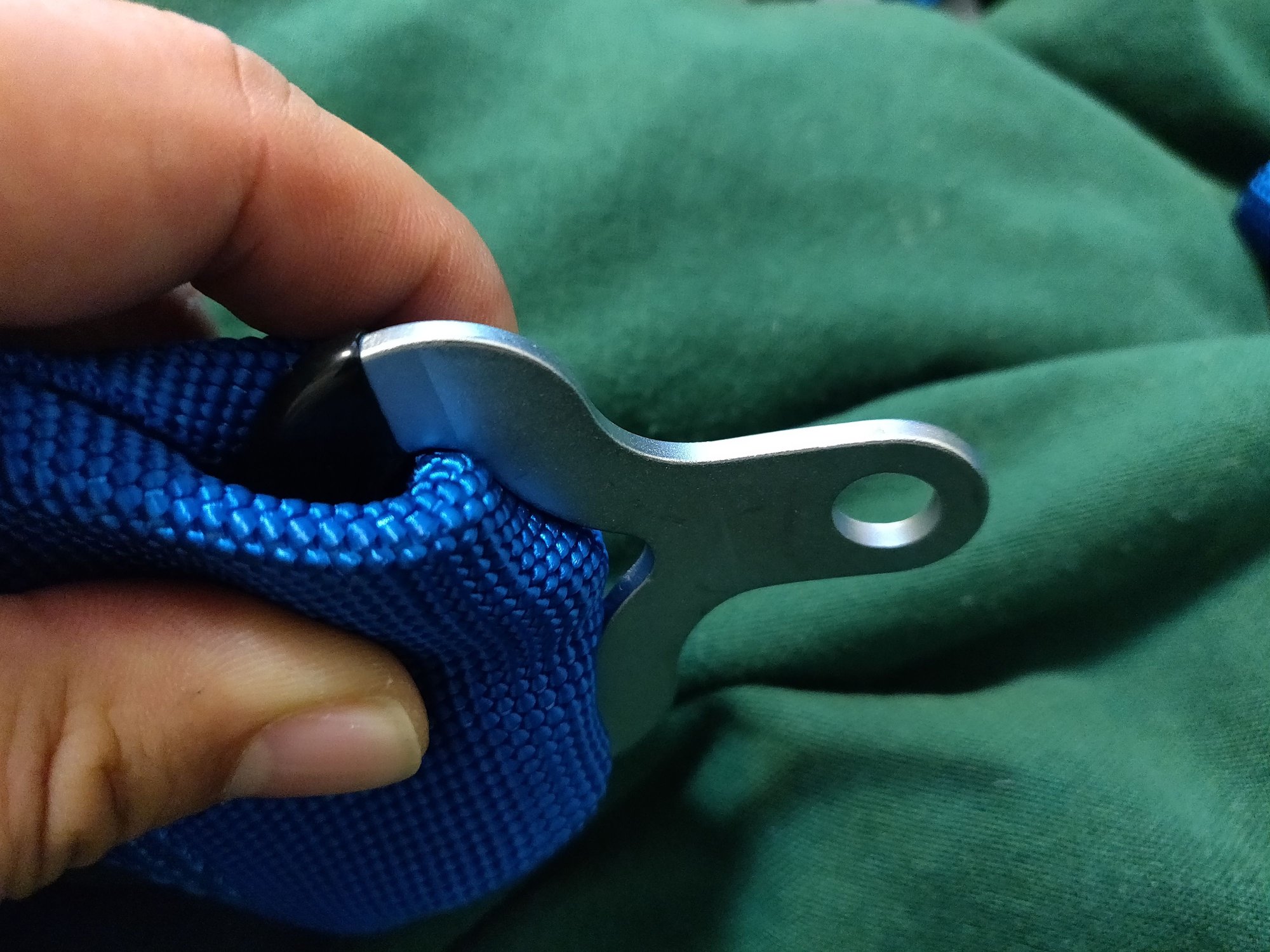

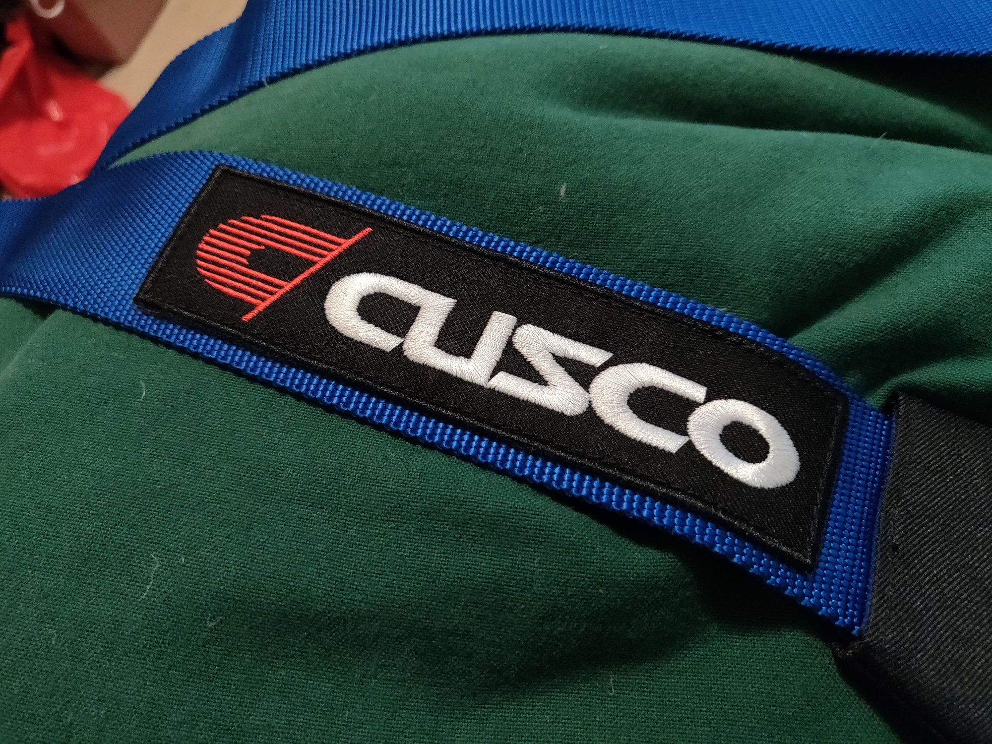

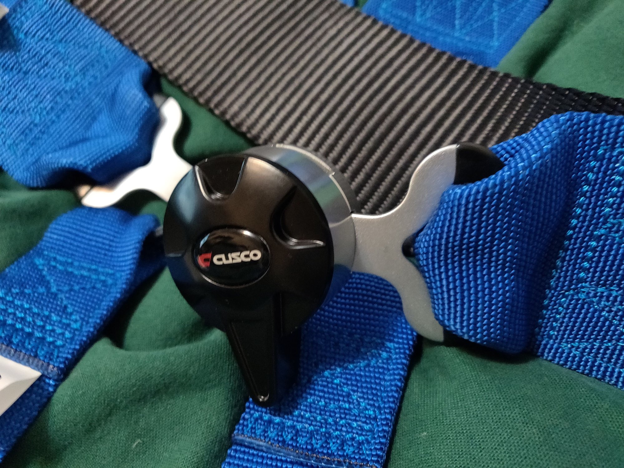

Picked up a Cusco 6 Point Hans Harness over Black Friday. Since I couldn't find any pictures of these on the internet, here are some closeup.
Just by picking them up, the belt material is thicker than the older Schroth Profi I have. One thing I noticed was the permanently mounted buckle is on the left hip side vs bottom crotch belt.
The buckle is made of billet machined aluminum.
The clips are made of what seems to be aluminum with a textured finish vs the polished steel on Schroths.
Adjusters are pretty nice with a spring loaded mechanisim.

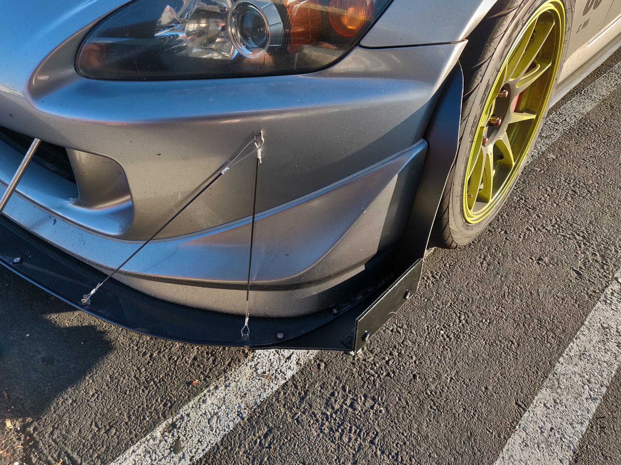

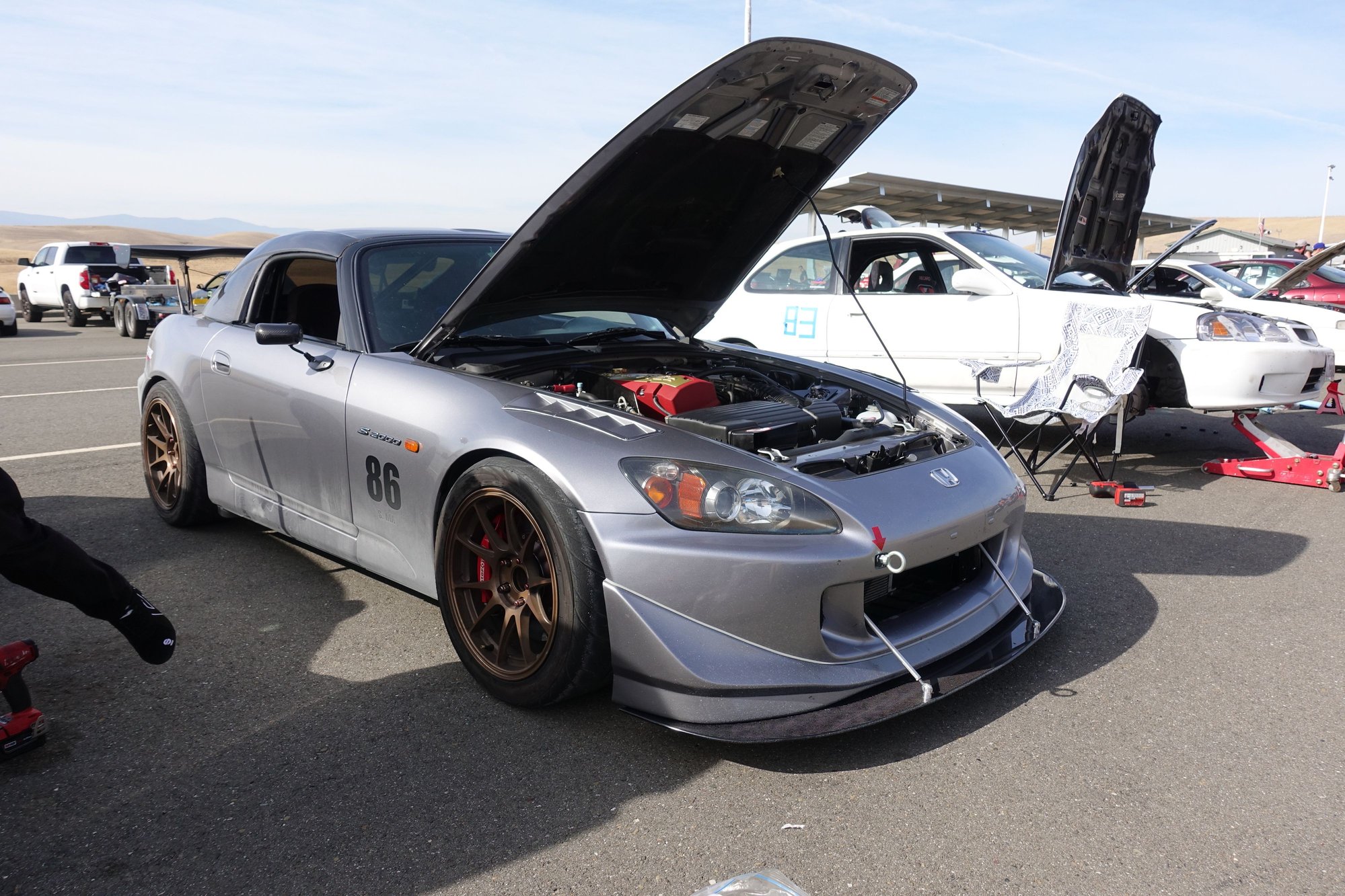

Some updates to my front splitter.
DIY'd some end plates and something to help cover my exposed tire
