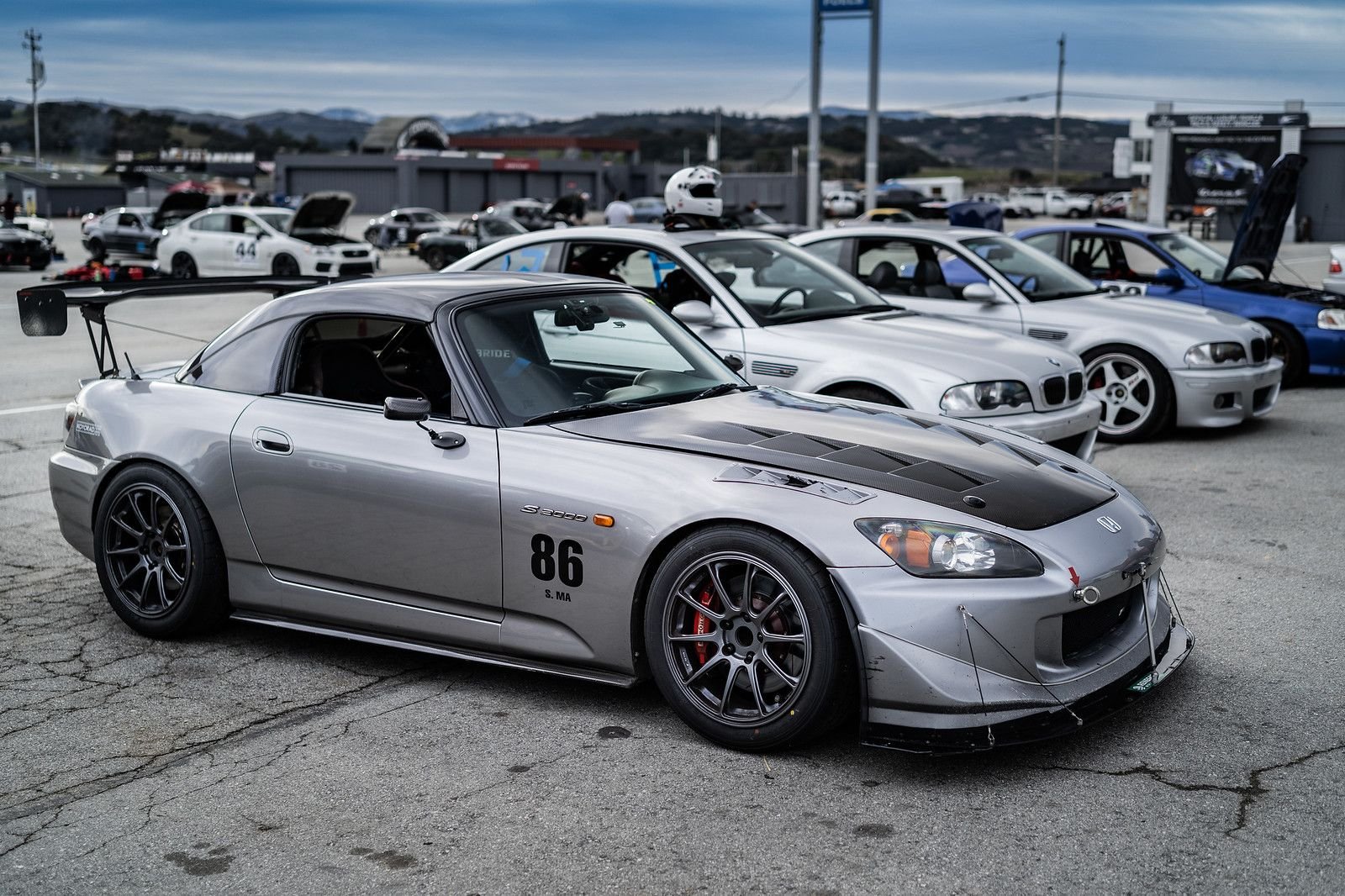

Refreshed the look of my car for 2020. Attempted wrapping my car by myself which turned out alright! Goal was for it to look decent from like standing 10 ft away from it and look good in pictures as well.

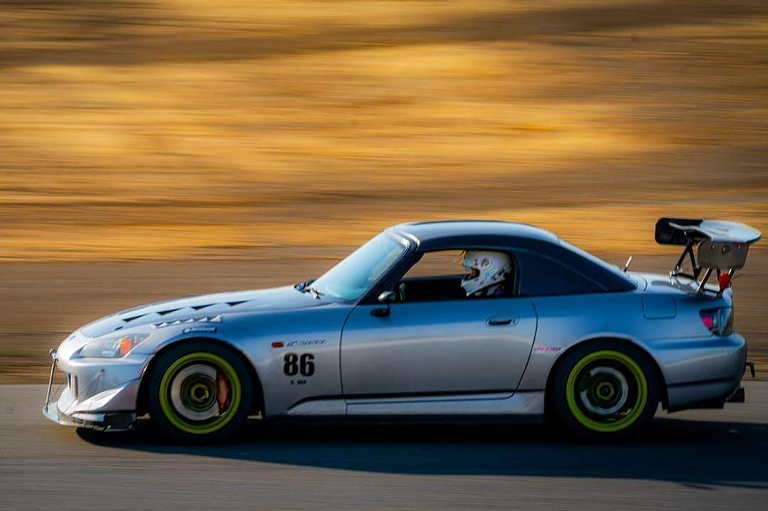

Did my first trackday at Thunderhill West CW so in reverse. Ran a time of 1'22.6 which is faster than my CCW forward time. Track is definitely faster going backwards. Had to end the day early because my splitter/tunnels were having issues.
Also got retuned with my new 70mm Milltek dual exhaust with 70mm TP. The gains were massive! +10hp peak and +20hp midrange. Midrange torque was massively increased. It finally hit the 230whp club.
