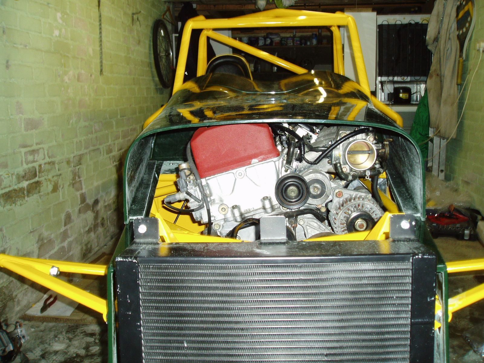

got the f20c motor,box,diff,steering,clocks and modded prop into my mnr chassis and it fits under the bonnet (just) with no mods! what do you guys think it will go like? and a couple of q's. the car i a fully caged lotus 7 style kit car,discs all round,prm cai intake,4-1 silencer, 600kg's,s2k diff,clocks,switch gear and steeing. 13" caterham r500 wheels
1; steering arm runs tight to side of motor meaning there is only just enough room to get the oil filter in,wihout the standard oil cooler. do i need an oil cooler with this motor as its not going to be under tha same load as an 's' its only 600kg's and air flow is high due to completely open engine bay (i will put a large scoop in bonnet)
2; i am running 205/60/13 yoko a048's with standard diff. how will this affect gearing, and top speed?
3; where is s2k speed sensor/pickup as i will need to alter the clocks to compensate for the 13's? is there an easy way to do this?
4;how do i upload pics for you to view? i have a few on my pc but am struggling to upload!

Speed sensor is in the gearbox, and JDMs and people with different final drives use a speed converter chip between that and the clocks. So you need to work out the difference between 205/60/13 and 245/40/17 and find an appropriate converter. Obviously you're going to have lower gearing and lower top speed.
Please upload some pics.

the car is a bit more 'complete' than in these pisc as it was a while ago when these were taken!

That chassis wouldn't look out of place in a game of Kerplunk
