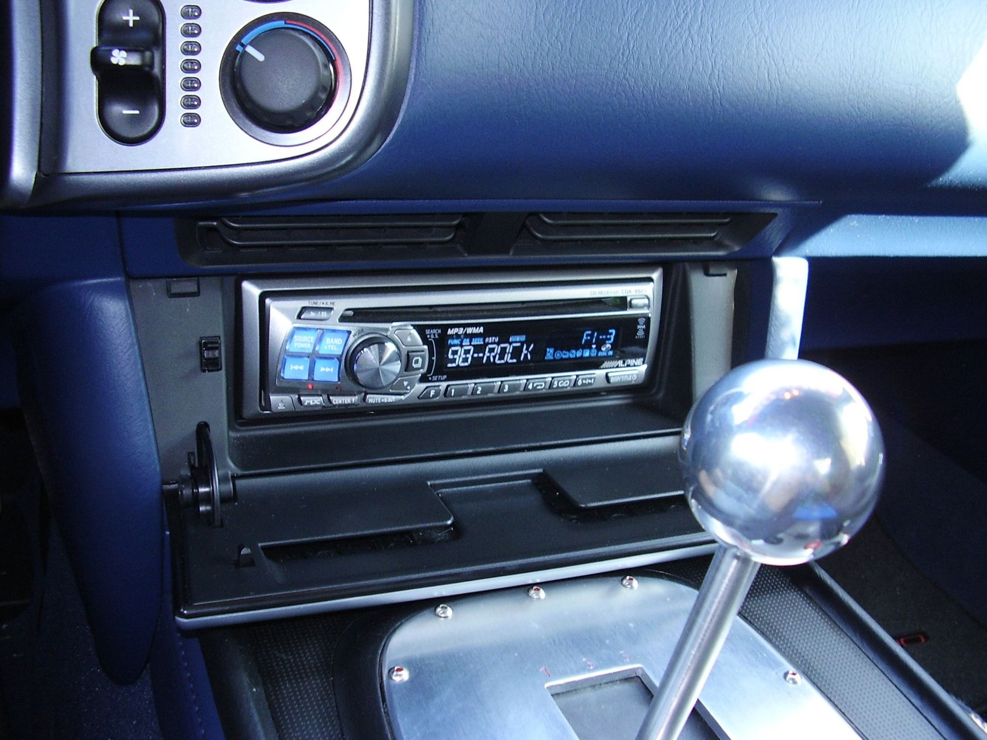

alright i installed my 9857 with the ipod connector...ran the connector under the center console and tucked it up in the glove box...this is only temporary bcs i couldnt come up with a great way w/out cutting to get into the glove box so i just ran the wire as suggested by dave-ror but i dont like the wire being visible...still trying to figure out a better way to get this done...love the set up though...

Well I am drilling a hole in my secret compartment to mount it in there. It's a pain to get all the crap out to do so but it's not so bad. If you need help on removing any of the parts let me know. I am going to do a write up with the pics I took but am waiting on parts to finish my install... or semi finish it anyways
