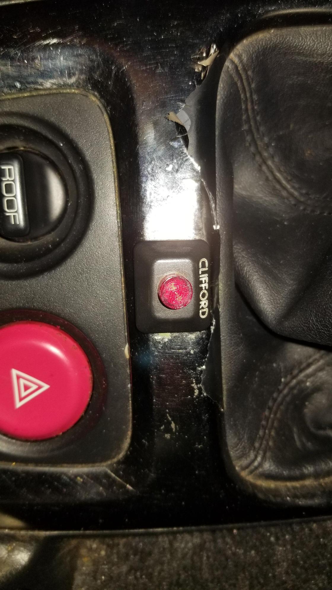

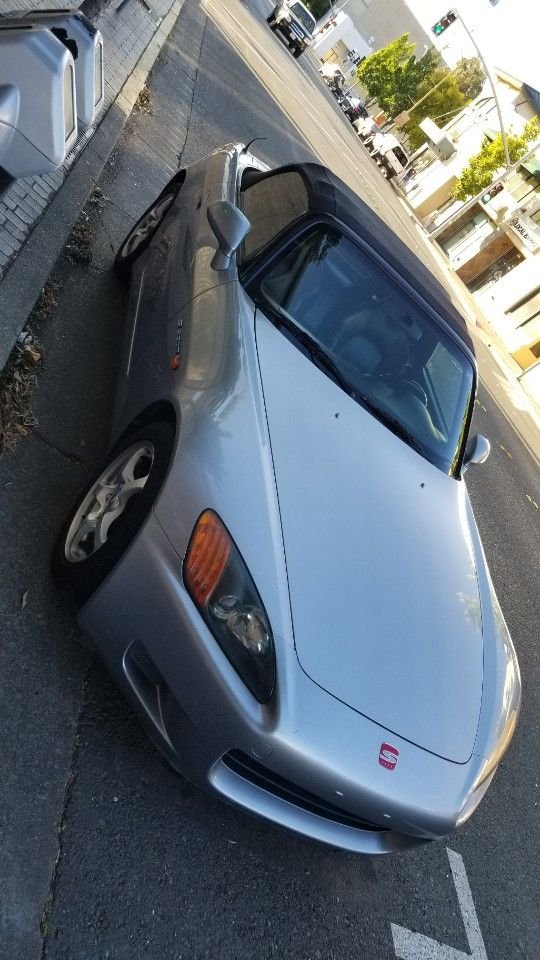

When I finally got the car home, I took my time to do a deep inspection. Interior was dirty and well worn. Dings and dents were scattered around, the ones that bothered me the most was the driver's fender which had a good sized shallow dent and a small one on the passenger's door that was distracting obviously next to the body line. Headlights were hazy. The front bumper cracked with plenty of chips. The engine by was kept but dusty. Someone drilled a hold near the shifter for an alarm LED (which didn't work) and the shiny coating was already peeling. This was definitely going to be a long term project.

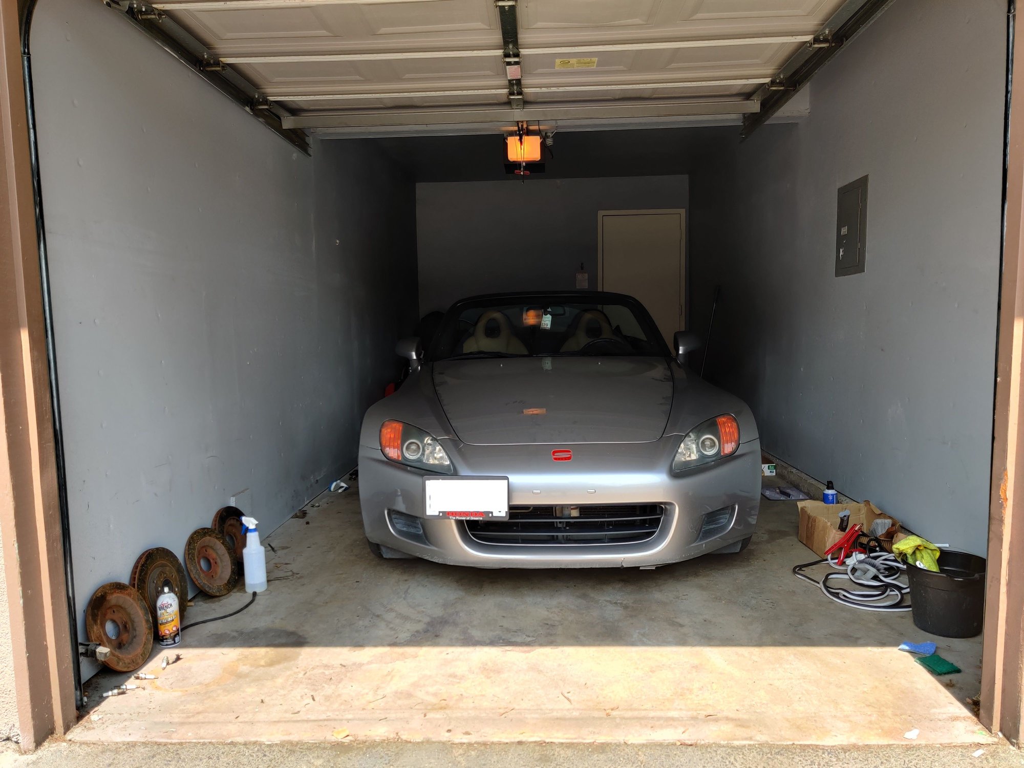

In the garage
The front

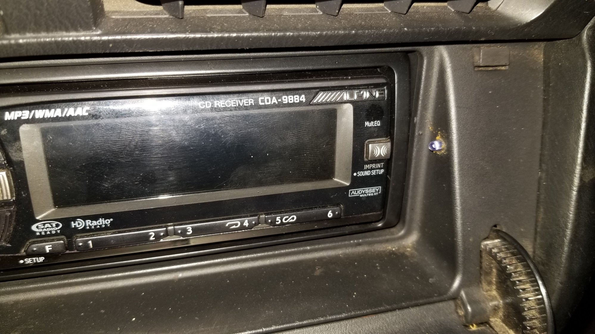

Vintage Alpine. Great build quality and it came with a jack for an iPhone. The original iPhone....

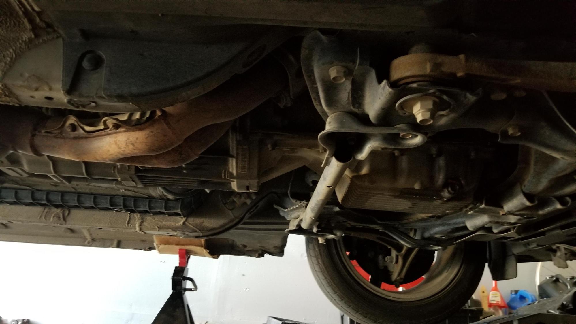

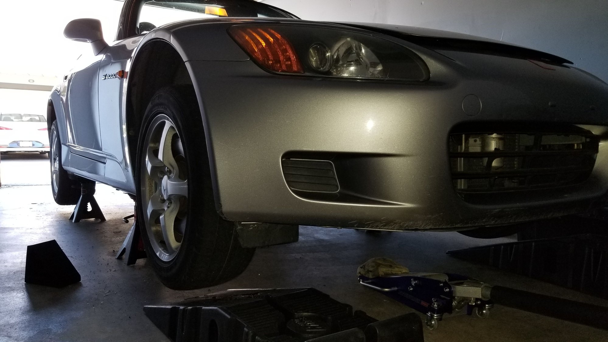

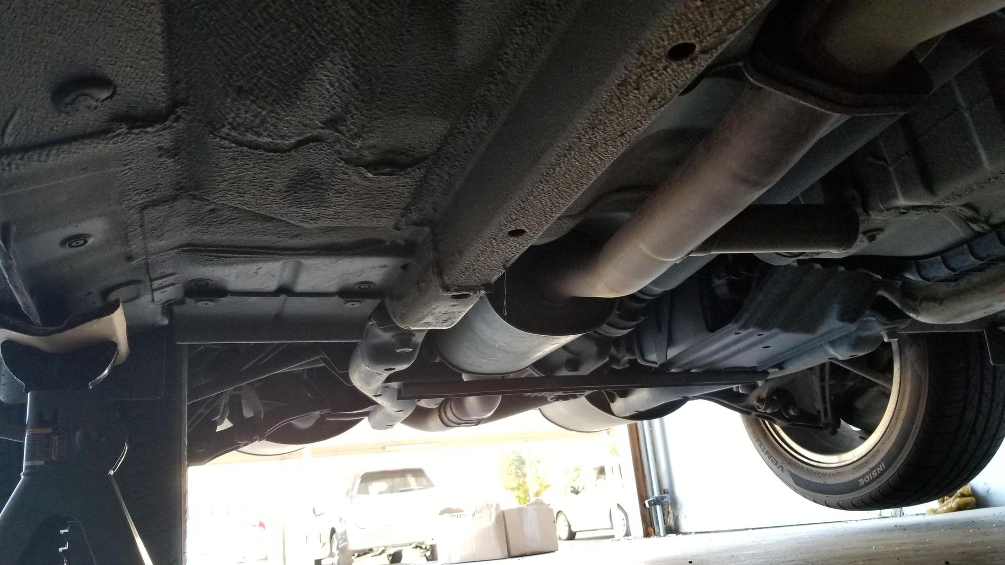

Levitating the car
Remarkably clean
Not bad

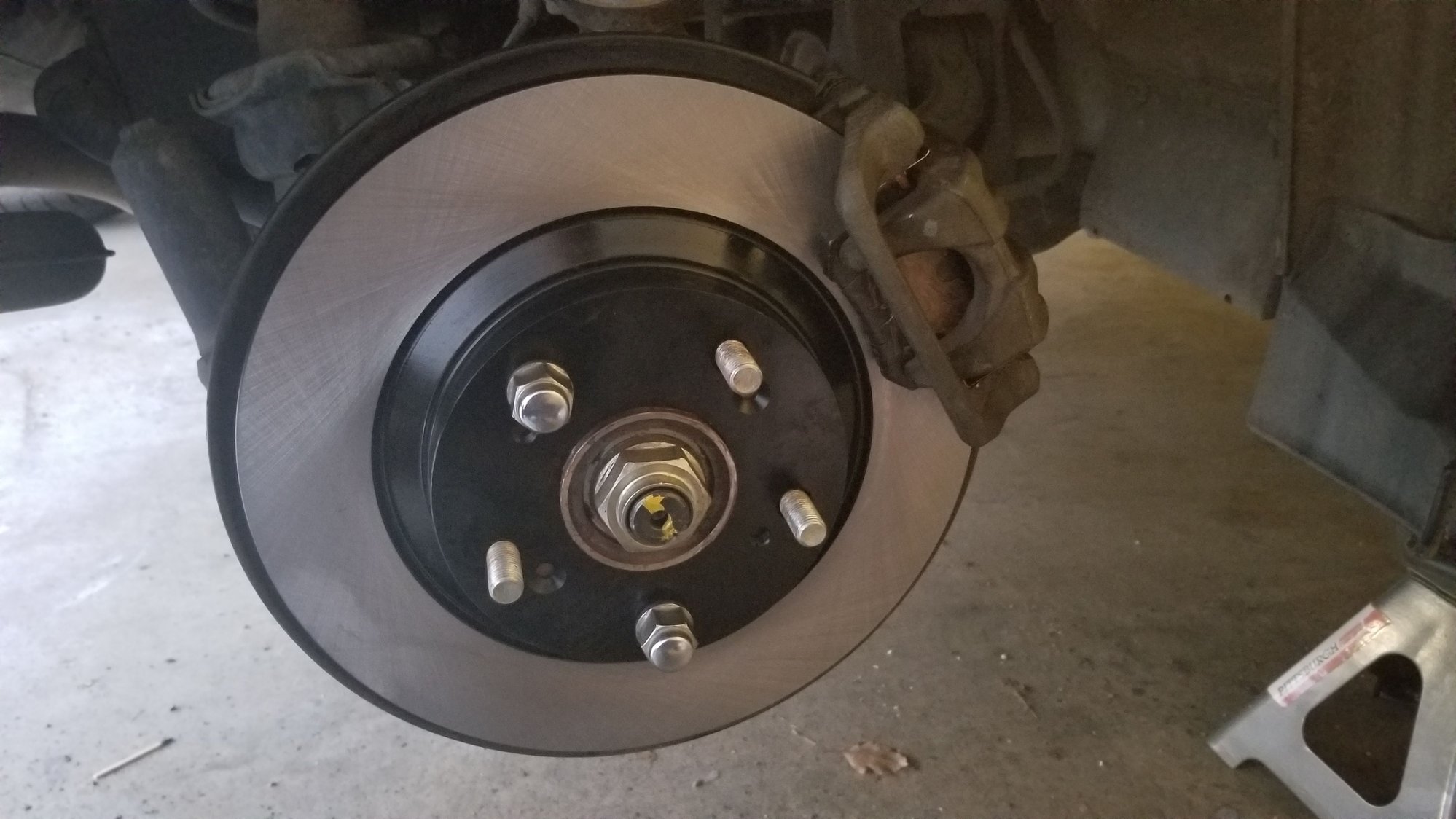

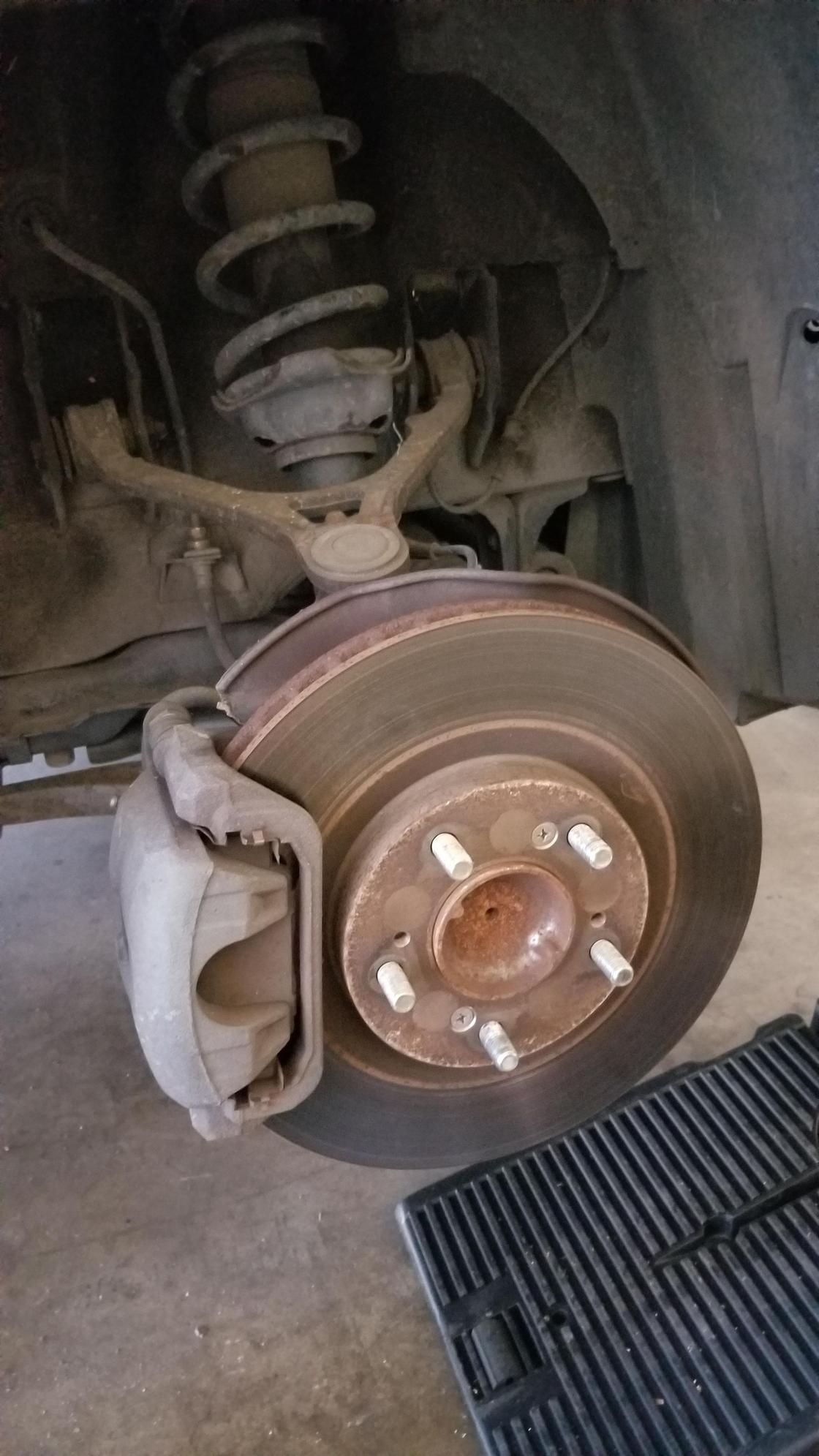

Brakes were squeaky, still had Honda rotors. The screws are one the worst things I experienced with this car. Tried an impact screw driver, heat, cold, then finally spent hours drilling ALL 8 OF THEM out. Painful.
New rotors, new pads, new grease (copper and silicone). Afterwards, did a complete brake flush via the popular gravity method. Nice strong brakes now.

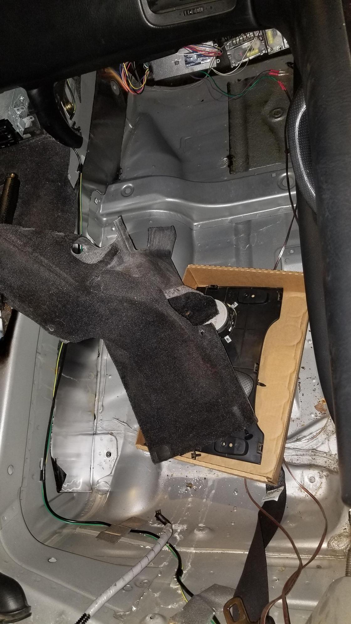

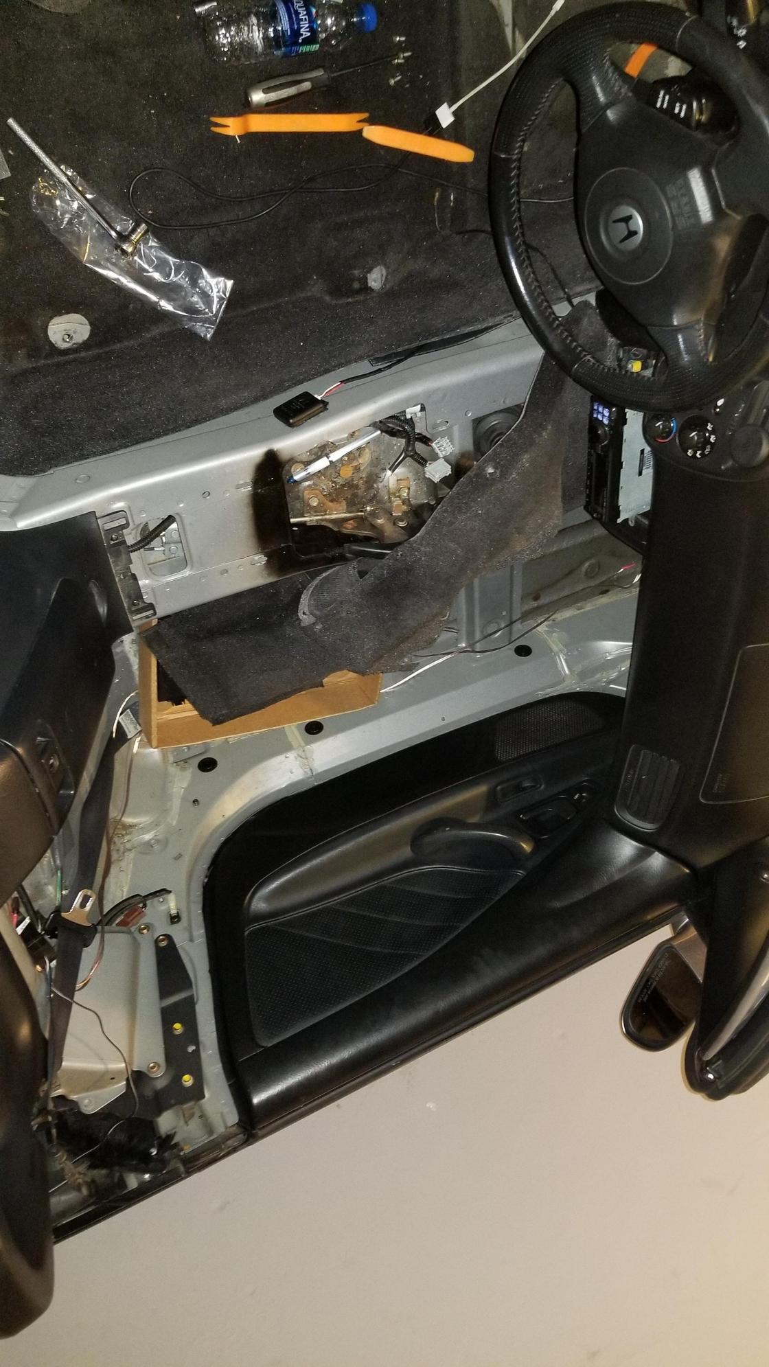

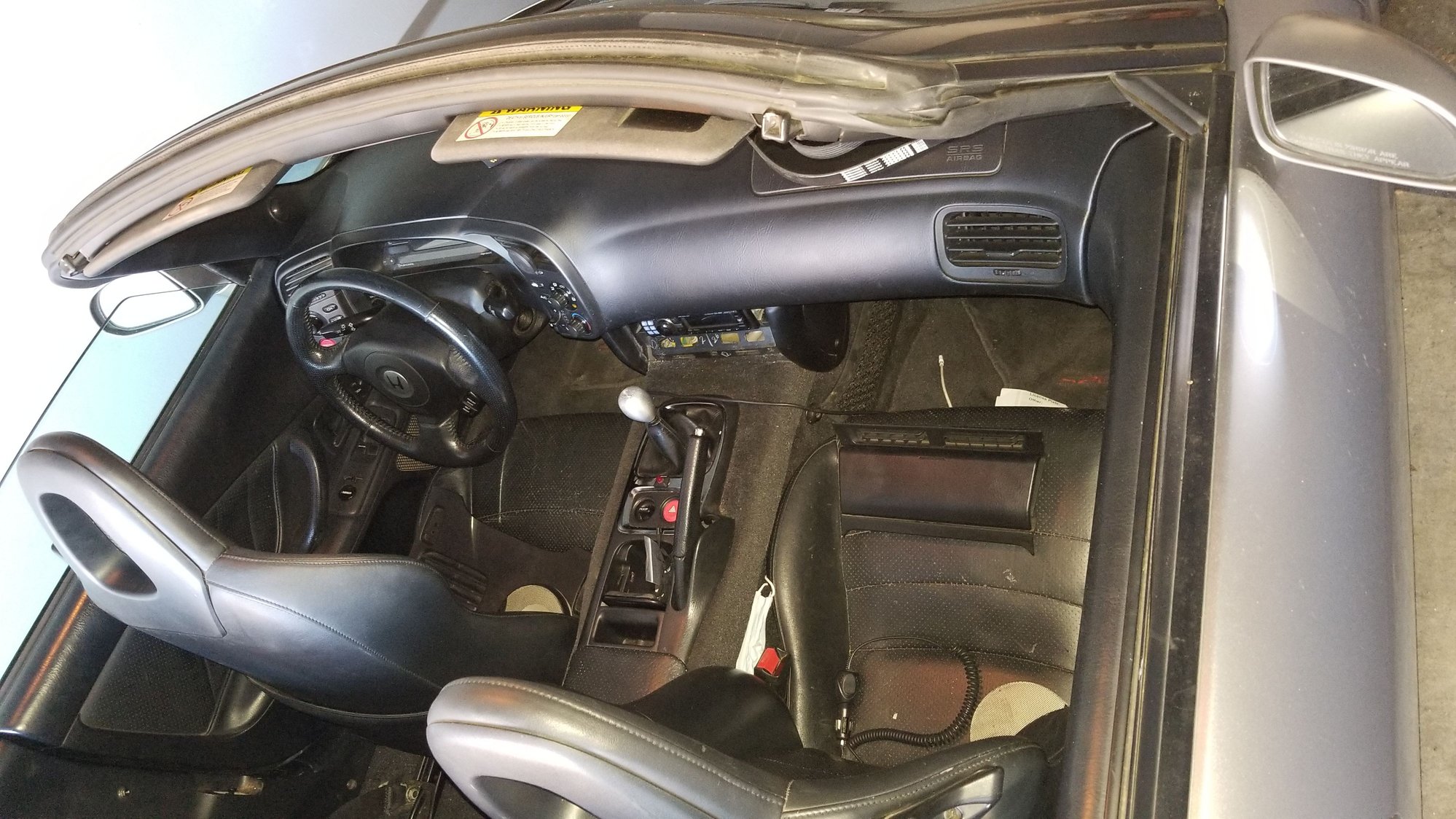

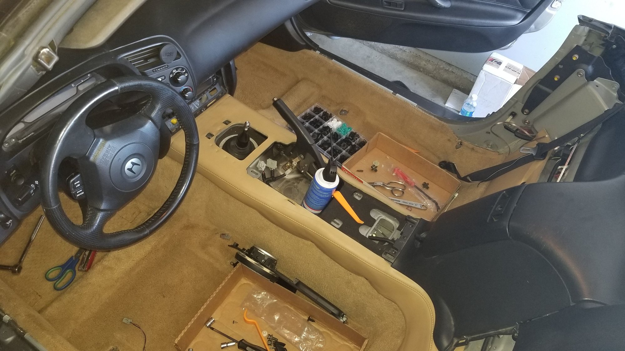

The interior was filthy. I took down the seats, carpeting, center console and went to town with the shop vac.

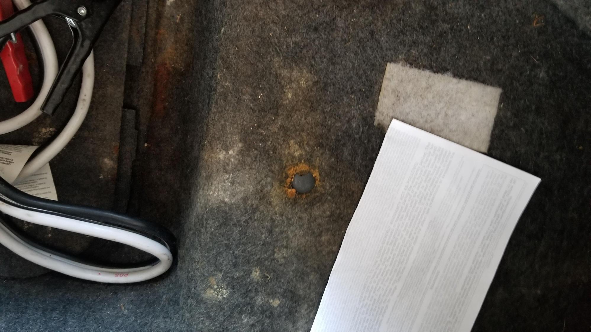

Surprisingly, no rust. Lost of dirt for some reason though.

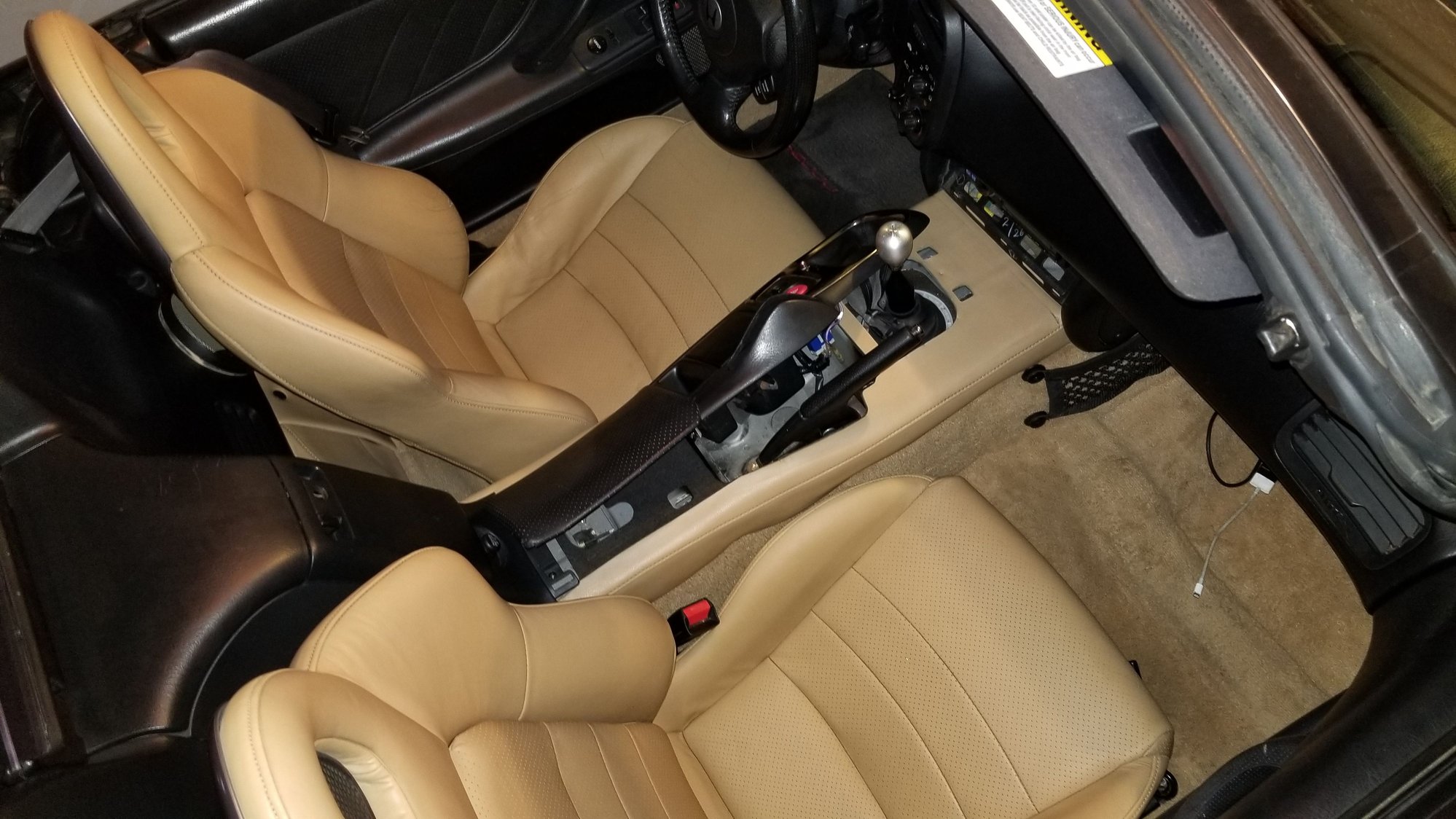

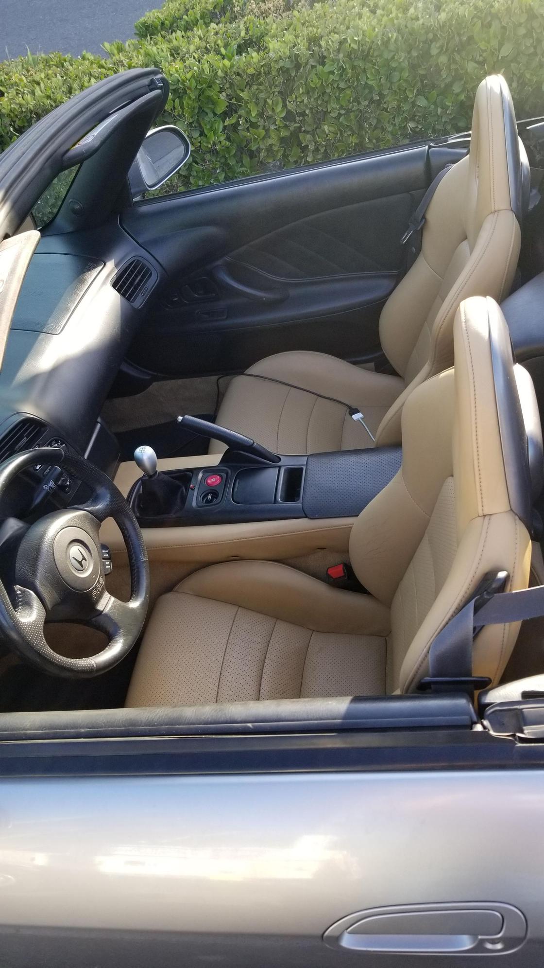

Luckily I met a nice guy who was selling a complete tan colored interior. I like the chocolate peanut butter look instead of the drab all back.
All buttoned up.
Seats are in. Since then I switched the passenger and driver seat cushions to hide the smushed bolsters.

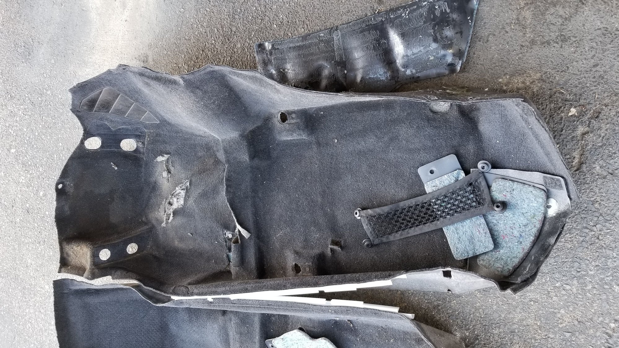

This is how the driver's carpeting looked. The seat bolster was also flat and both seats had a few cosmetic issues. At least it looked like someone spent a lot of time driving the car...
New to me interior.

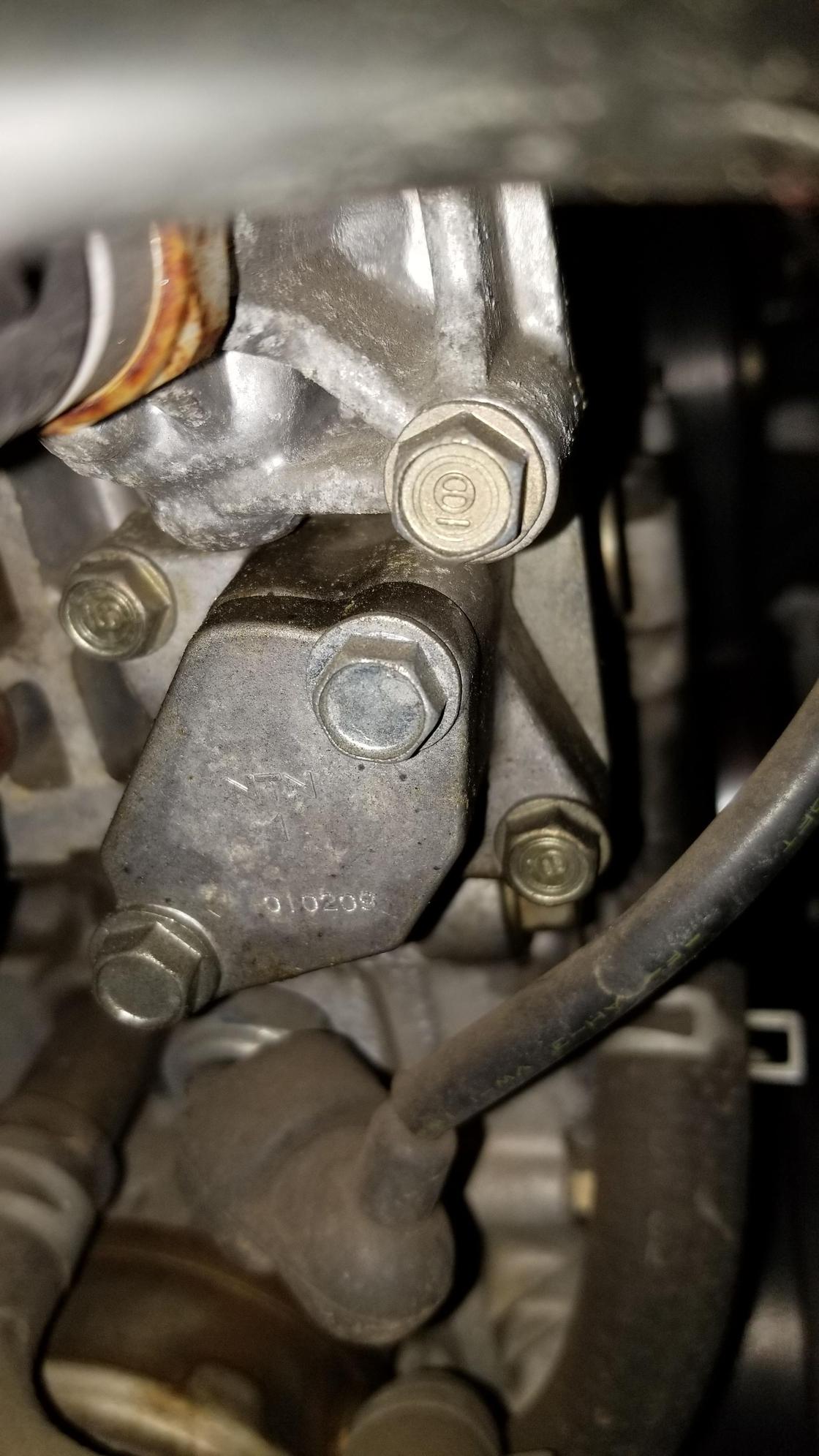

The ad said that maintenance was done by the prior owner's father but I wanted to give it a once over during my ownership. Spark plugs replaced with the NGK ones. Old ones didn't look too bad.

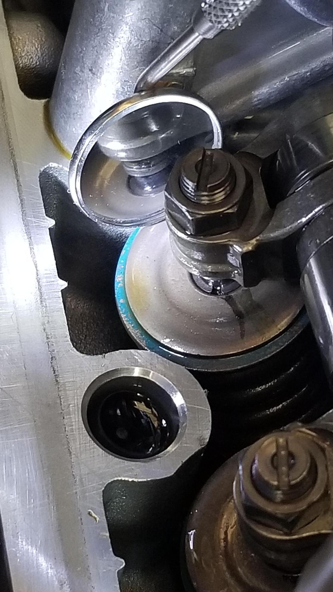

Spent about 2 days taking my time on basic engine care. Replaced the spark plug gaskets and the valve cover gasket with OEM ones. The old ones also looked reassuringly decent. The valves themselves were inspected for cracks, adjusted, then torqued to spec. I don't plan on tracking the car or driving it particularly hard so I did not replace the retainers with AP2 ones. Oil was changed with full synthetic. Filter was replaced with the OEM one. I also went ahead and replaced the cabin air filter and intake air filter. Clutch fluid, differential oil, and transmission oil was also replaced at this time. The fluids looked great, no sparking or obvious metal shards.

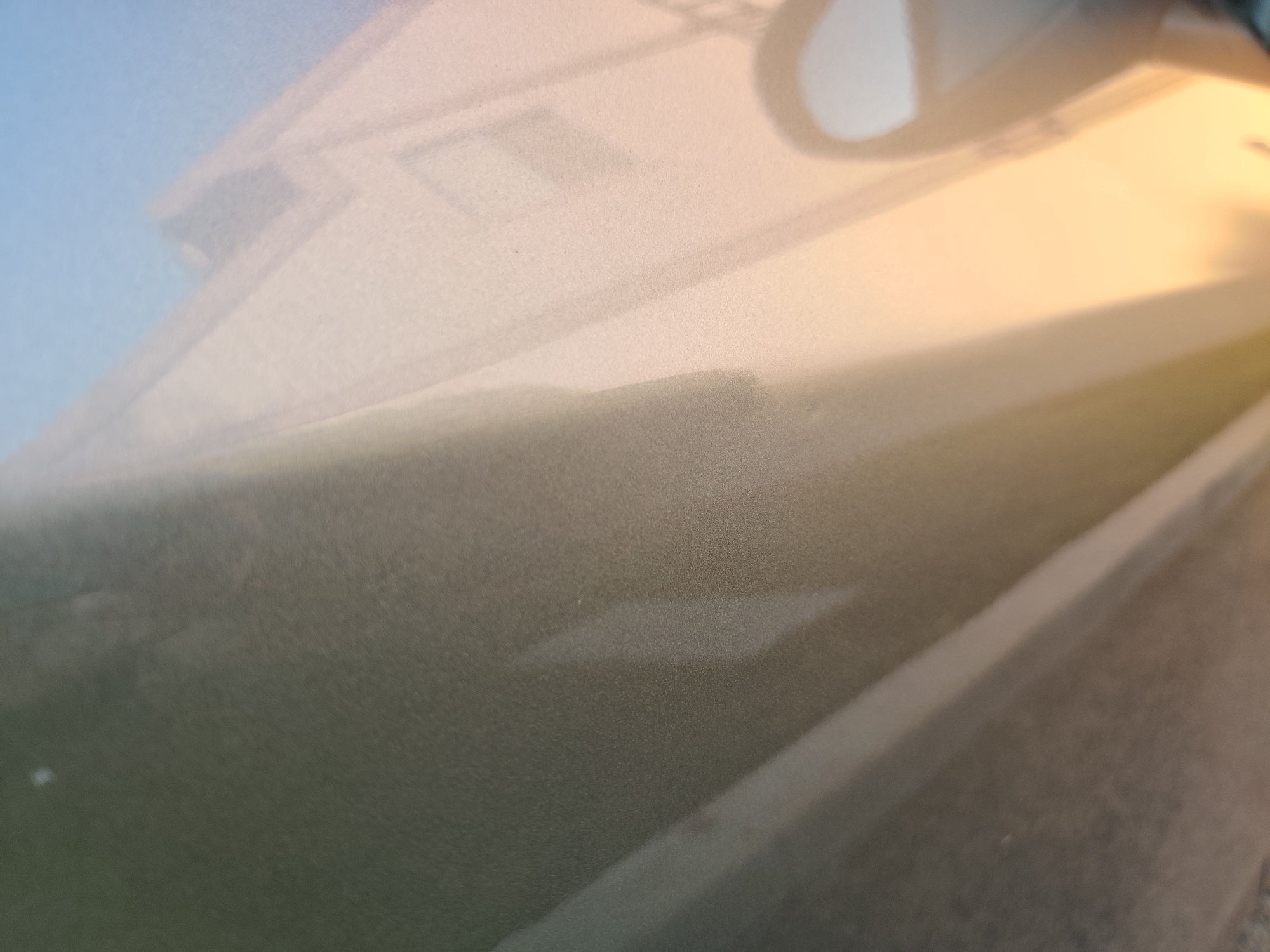

Annoying dent one. Recently hired a PDR guy to pull it out. It's now barely noticeable.
Much better and barely noticeable.

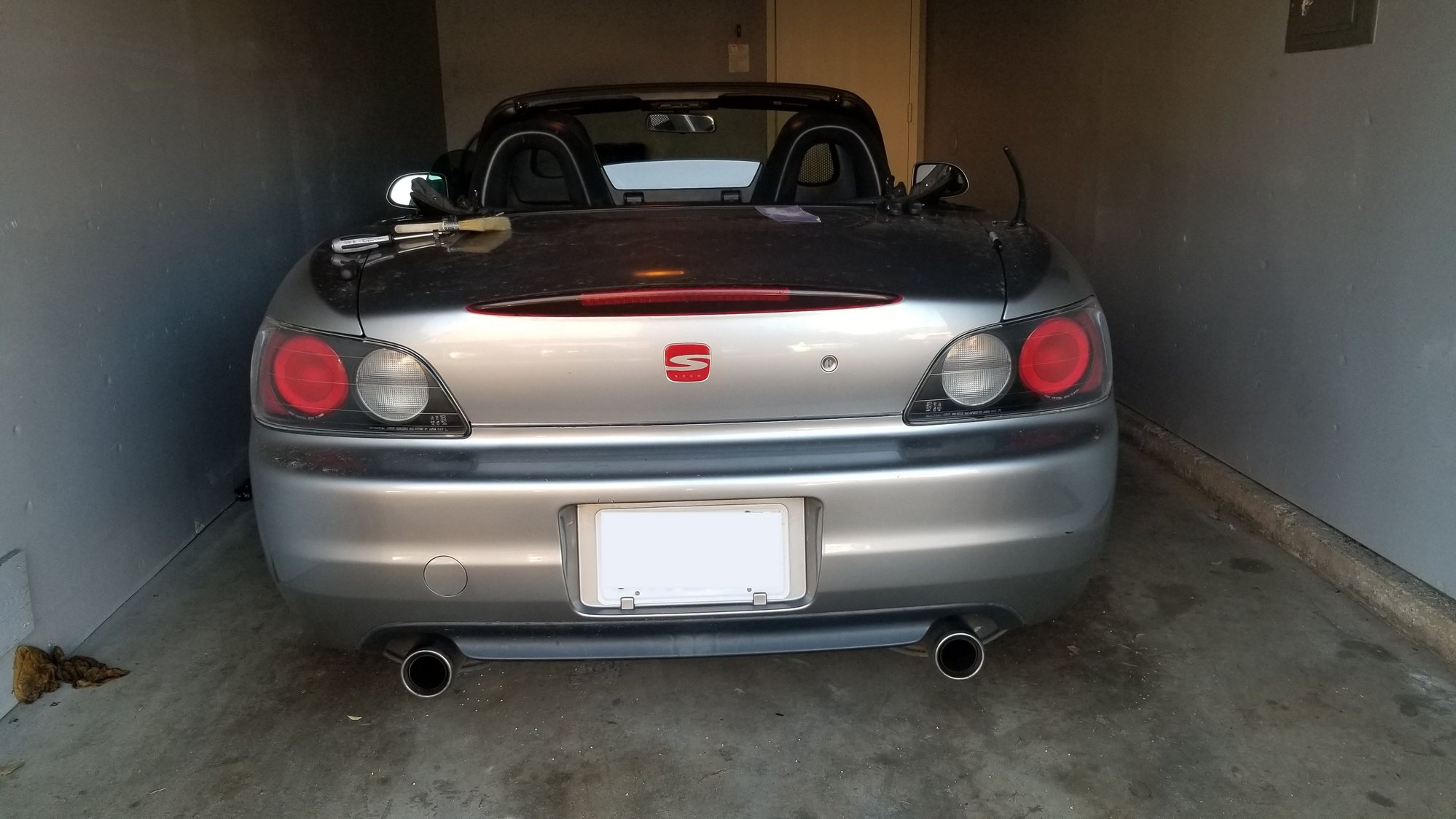

Since most of the maintenance issues were addressed, I decided to do a makeover. I think the spoiler was a great buy, color matched and makes the rear more interesting. I also went ahead with aftermarket tail lights that look like AP2 clones since one of mine had a crack. The wiring was off but I was able to reverse wire the plugs and now all the LED lights work great.
Installed.

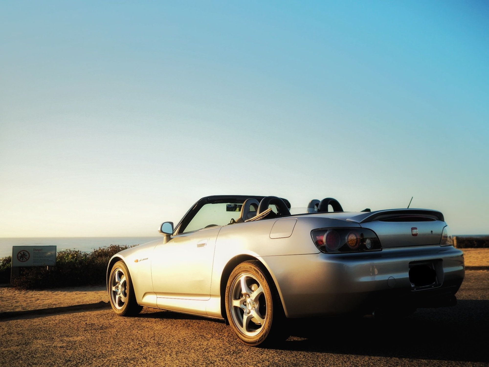

Turned out I'm not a fan of the 16 inch wheels that came with the car. There was just too much gap. So I went on the hunt for AP2 v2 wheels which I think are the best looking for the S2000. Met a nice guy who sold me a well used set.
I enjoy the wheels, curb rash and all.
