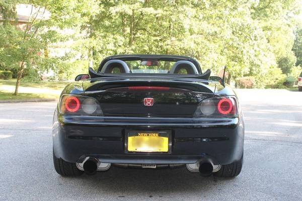

I finally pulled the trigger on a black over red AP1 with 57k miles. Only modifications are an Invidia q300 Ti, and AP2 wheels. It's beautiful, and I already love it. I have a few questions I was hoping some of the more experienced forum members/owners could help answer for me.

I don't have a hard top but did note your roof is not retracting all the way. There are elastic straps between a couple of top bows that wear out and need to be periodically replaced. Someone will post a link.
