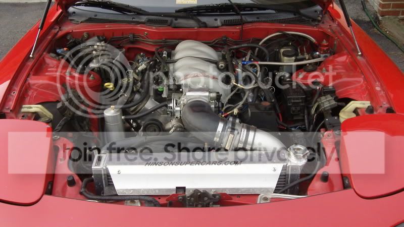

See the s2k in the backround (on jackstands) getting the street brake pads put back on. Just picked up the FD today for a friend thats stationed overseas. I'm watching/storing it for him until he returns or has it shipped to Italy. I get to drive it around this weekend until I send the owners plates back.
What's under the hood you say?!
LS6 block - stroked to 383. Forged internals. Trick flow heads. Wet nitrous kit.
Puts down 450hp N/A and 550 on the bottle.
This car makes my 420rwhp s2000 feel like a luxury cruiser. The gurgly cam is arousing to say the least.
