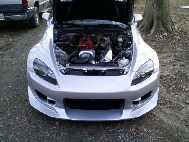

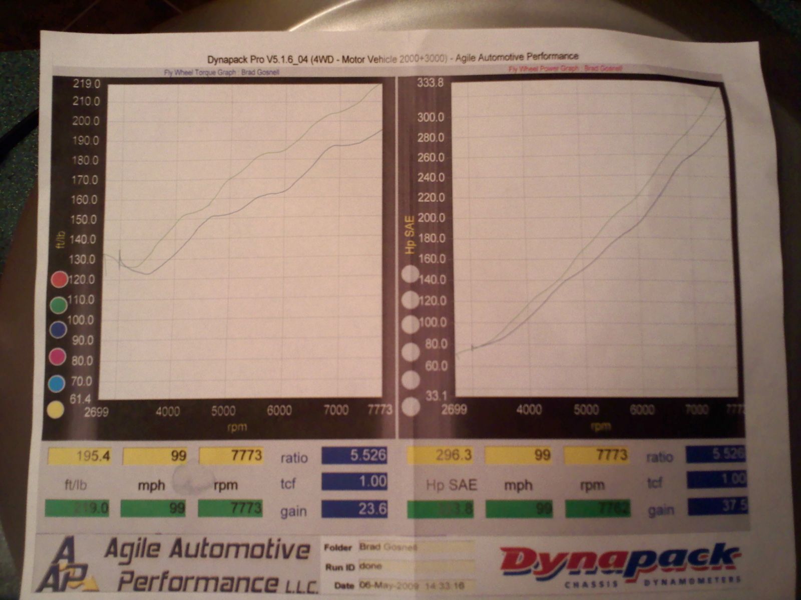

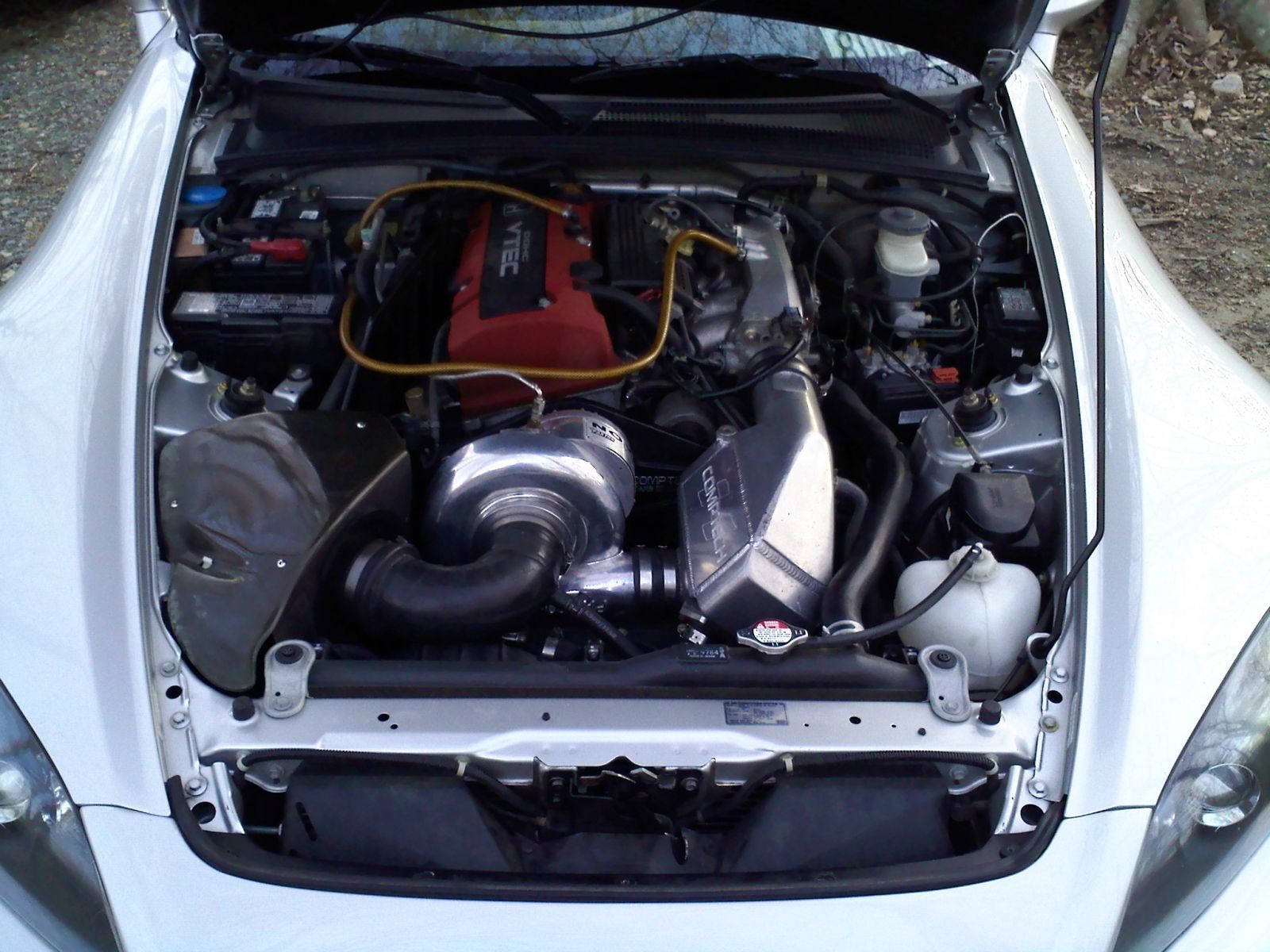

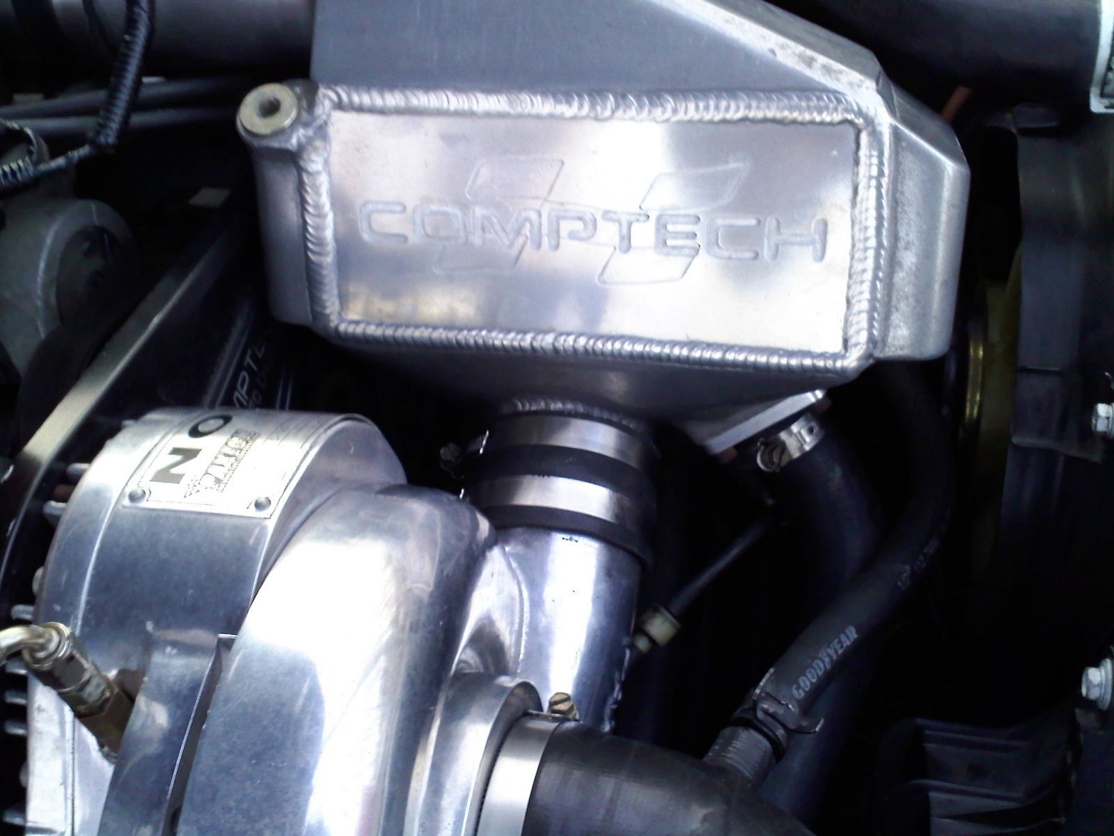

Today i got my S back from Agile as they were tuning the CTSC i installed. All i can say is WOW. They did a great job at tuning. Final numbers came out to 333.8 whp and 218 wtq at 7700 rpm. I didn't know i needed a 3 bar MAP. so the stock MAP is cutting fuel at 8000 rpm. With a 3 bar MAP i should be close to 390 whp. The car is so much smoother thru the revs now with Agiles tune than with the one Inline Pro had on the EMS.

Nice. what psi pulley you running and did you do a head gasket?
Old May 6, 2009 | 06:05 PM
9000revolutions's Avatar
Joined: Nov 2007
Posts: 1,986
From: Bel Air, MD
11 psi pulley. stock HG. what are you getting out of yours Bobby

iiiiii dont think you'll be able to hit 390 with just a 3 bar map... on 11 psi..
either way.. congrats.. and who's agile?
