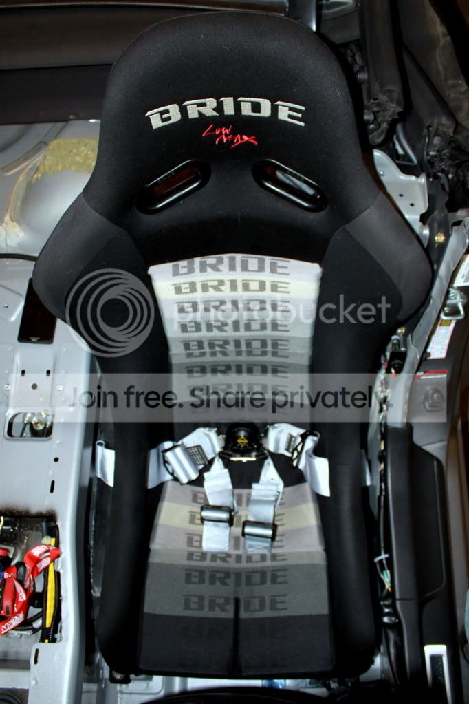

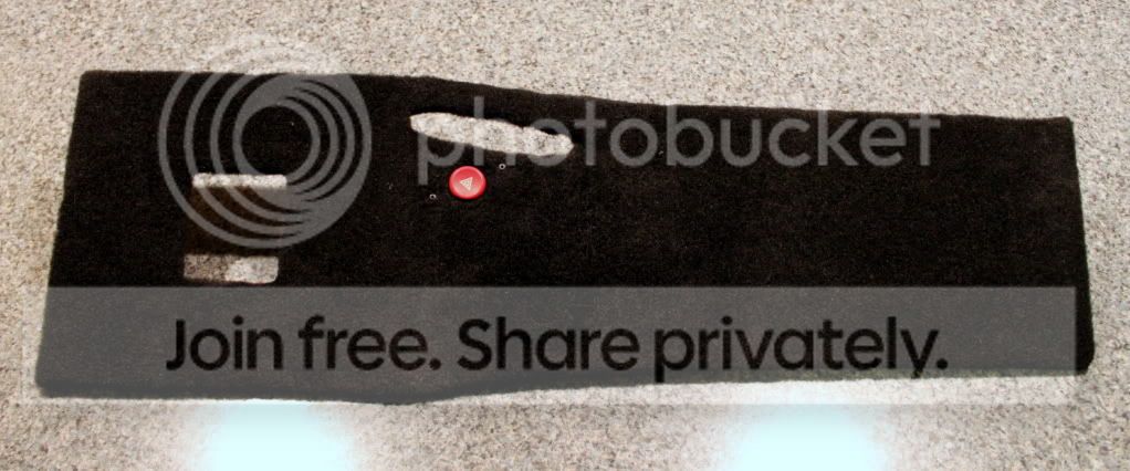

Got a bit done over the last couple of weeks... Pretty much have reached the end of what I can do in the interior until the Roll bar install. I will be starting on the air pump removal and brake ducting shortly...
1. Both seats have been fitted to the car finally...taken back out, put back in, taken back out, put back in,....
2. Painted my shift extension to match the stock shifter body and the Auger Delrin knob that has been sitting in my toolbox for months and months...
3. Floor and pedals have had some grip tape added to them
4. Schroth 6th point and lap belts installed (wicked PITA)
5. Console cut out and wrapped. Very simple but will work well with the semi-gutted interior and I like the look! Still need to find the right hardware to mount it, got some ideas though...

U selling your center console?
