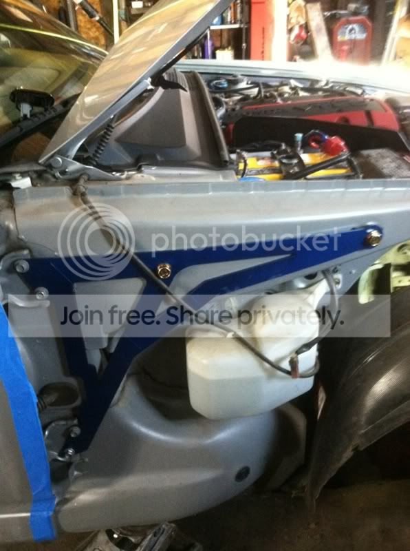

Originally Posted by theprophet36
Oh yeah. Installed fender braces I bought from a fellow s2ki member while the fenders were off:
I have a set of Nagisa Auto on mine I installed last year, made a huge difference in how the front of the car felt. I would get an alignment after, mine changed believe it or not...
