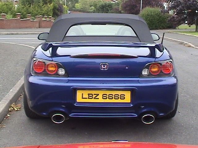

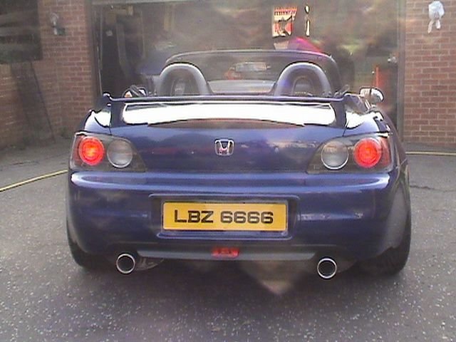

Been meaning to post back on this topic for ages, I completed the full conversion on mine a couple of months back, followed Joshs instructions and they were spot on in every way, and you definitely do need to shave the front crossmember at both sides (otherwise nasty nipples!!!!)
ANyway bought everything from hardtopguy.com inc. headlights even though my cars RHD everything was fine except the headlights are manual adjust. and once set no worries all good
Heres some before/after shots

the conversion on your monte carlo blue looks HOT!
Old Dec 12, 2005 | 01:35 PM
  #38
johnny's Avatar
Joined: Mar 2001
Posts: 50,370
From: All over SoCal
wow. that looks bloody awesome. good job there!
edit: also noticed that you opted for the ap2 front and rear bumpers. it makes the car look all the more beautiful
