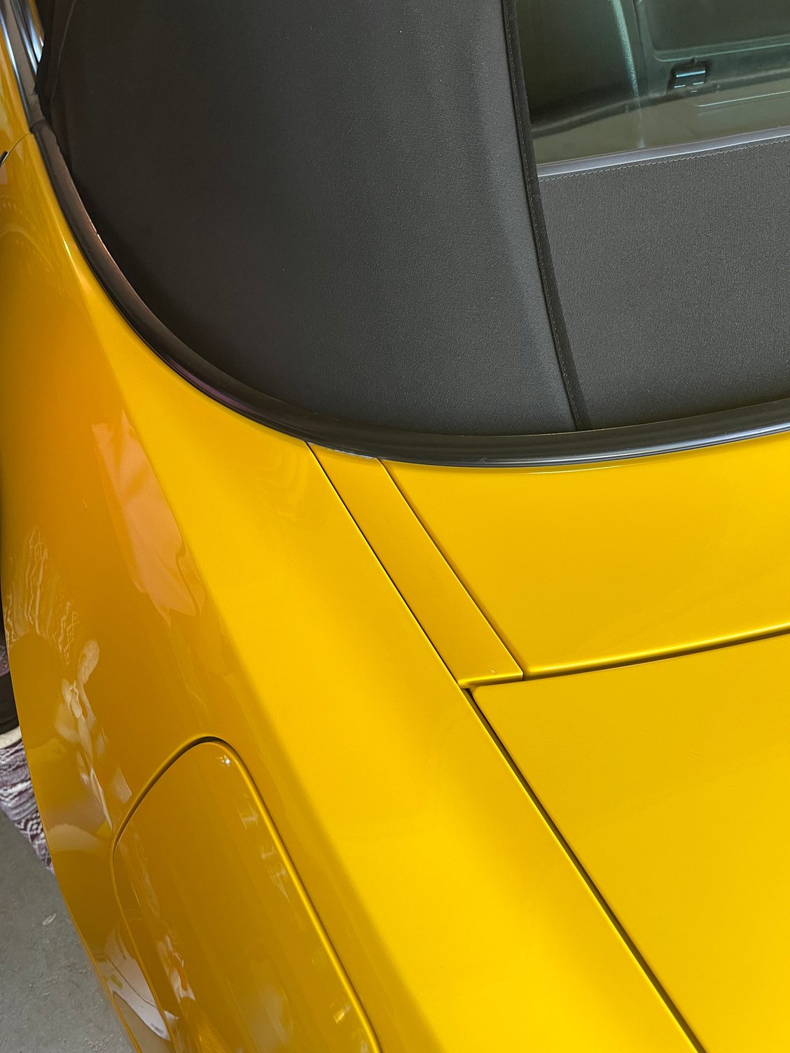

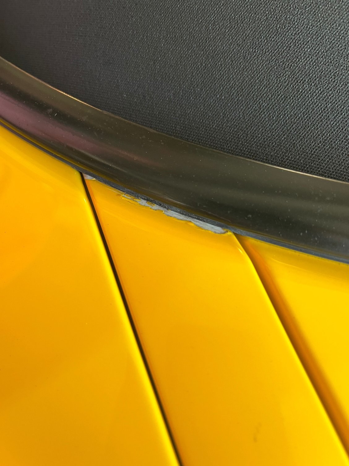

Is this little trim piece plastic?
I was going to put touch up pain on this to keep from rusting but it looks/sounds like plastic, in which case I’m less worried.

Yes its plastic. Easily removable. Open trunk, remove screw, pull towards rear. It should pop out.
