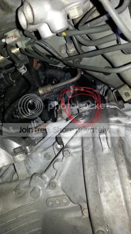

Got my clutch changed at a shop and not only did they damage my knock sensor but they forgot to put this bolt in...
I need help identifying what it is called so I can order one from Honda or just Home Depot
its driver side near the tranny and engine
Also, does the knock sensor look broken? I couldnt get a tool to take it out just my camera
THANKS!

Lower intake manifold brace.
95701-10025-08 BOLT, FLANGE (10X25) 0.89
