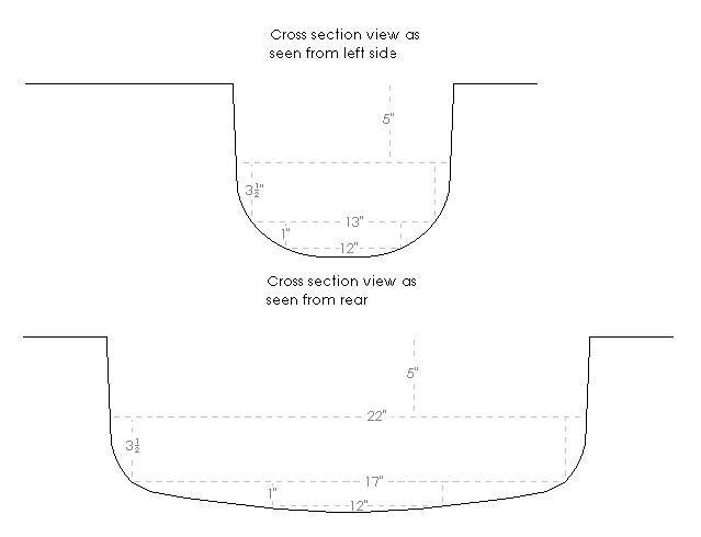

Here's are some dimensions of our trunk
And here are the three different box shapes that you could use
Go here for my whole writeup on the boxes
https://www.s2ki.com/forums/showthread.php?...718#post1481718
Note though that the volumes for the pentagon and trapezoid boxes are wrong because it wouldn't be possible to still use 1/2" MDF and still make it structurally sound...You'd need at least 3/4"
Trapezoid, you're looking at 0.80 cu ft internal volume and the pentagon, about 0.90 cu ft
Along the way, some pointed out that it would probably be easier to just go the fiberglass route so you could look into that but MDF worked for me
I'm using the final trapezoid on the page (Scroll way down) with 1 lb. of polyfill for a Dayton DSQ

Regarding your question about boxes, an MDF box is pretty easy (and cheap) to make. I'm assuming that's what you were quoted on? The problem, as bomberman pointed out, is that you loose so much volume due to the tool area's curves. You really might want to consider making one out of fibreglass to take full advantage of the limited area.
I did mine that way and having never, ever worked w/ fibreglass before I can say that it really wasn't that hard. It was actually pretty easy, just long, tedious and messy. The total cost of materials (from a boat shop here, couldn't find a fibreglass specialty shop) was about $70 when you add in cloth, brushes, resin, etc. I basically bonded the shell to a flat 3/4" MDF top and it works great. Just remember, that curved fibreglass is very stiff, but flat areas have to be very thick to be stiff. You'll probably want some internal bracing to get extra stiffness, which works out well if you divide the chamber into two seperate areas as I did, because I had enough volume for two 8"s!
Fiberglass is the best bet. I was not that committed so I had my installer make a .6 cu ft box for the well for a JL 10W6 v2. It fits in the well and is easily removable. He could have made the enclosure larger, but this particular sub likes that airspace so that is what we went with.
I also thought about sealing off the well as an enclosure. I used to do that on '82 through '92 Camaros back in the day and it worked OK. But with so many subs working so well in low airspace now I think you're better off with a specific enclosure designed for that sub.
