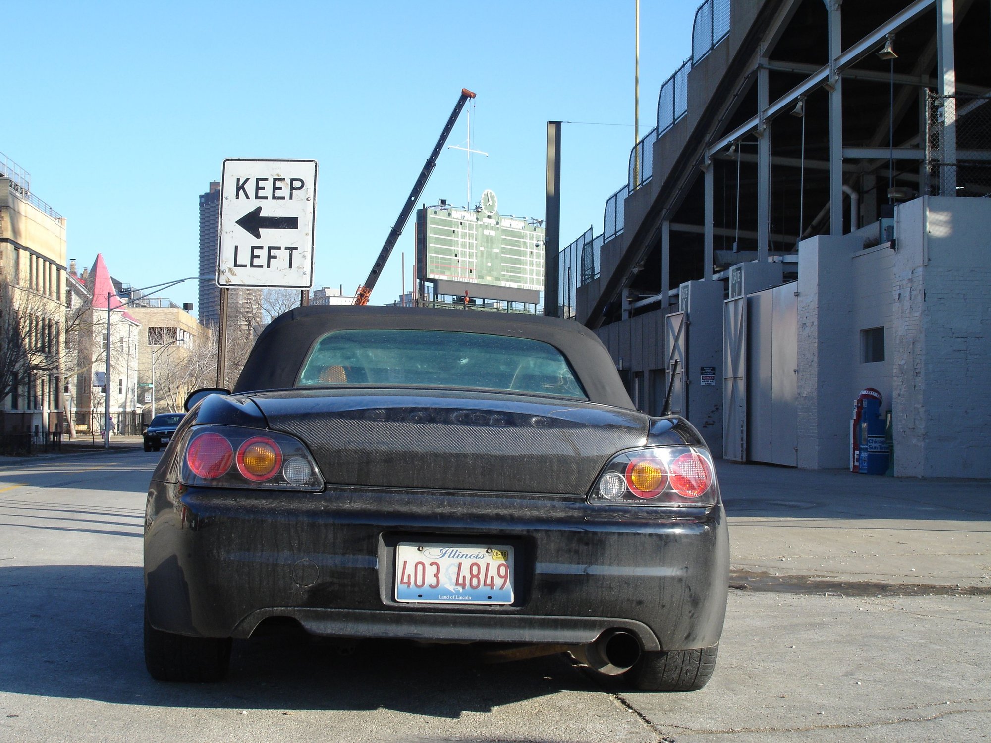

This is a great post. I followed the instructions perfectly and had no problems.
Between a friend and I, we got it done in under an hour.
Thanks.
For you baseball fans, here's a picture in front of Wrigley. There's a lot of construction, so it's hard to get close.
