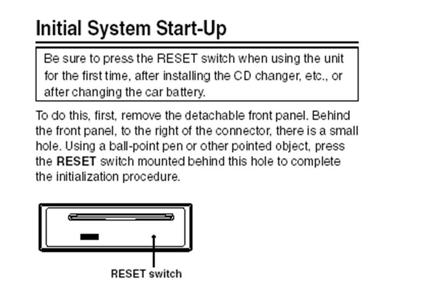

Is there a way to reset the HU without actually unplugging it from the harness (like pressing a button or 2)?
Thanks.....

Old Aug 9, 2003 | 10:35 PM
