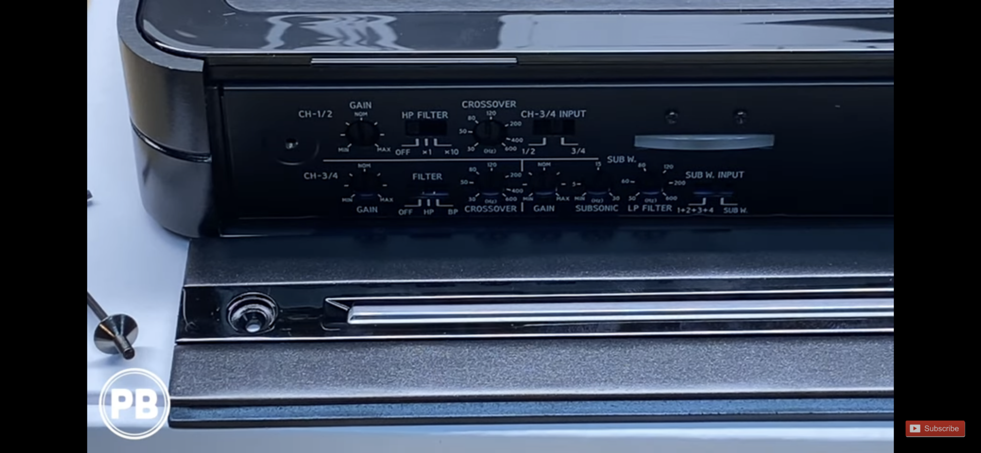

I just purchased an Alpine PDX-V9 5 channel amp to run two door speakers, two tweeters in the doors and 1 12 inch sub in a sealed enclosure.
I have never wired anything except a monoblock amp.
I am looking for suggestions if the tweeters need to be on their own channel (tweeters are Pioneer TS-A300TW).
subwoofer is a
Rockford Fosgate P3D4-10 Punch P3 DVC 4-Ohm 10-Inch 500-Watt RMS 1000 Watts Peak Subwoofer
I am also looking on recommendations on what settings to tune once installed
Pic for reference.

Connect door mid speakers and tweeters to same amp output channel. But connect a hardware high pass filter before the tweeters.
