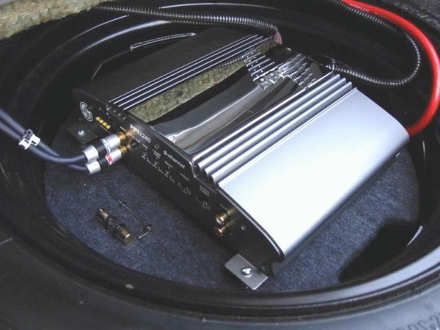

Here's the pics of my setup. I'm running a PPI 2240, and I still have a bit of room. I'm using 5/8" MDF (particle board) as a base with a 1/2" riser, so if you want a taller amp, there is still some room to play with. The risers are to allow some airflow underneath the amp. The only concern with my setup is that I will overheat the amp on 90+ degree days after a couple hours of use. I purchased a 12V computer case fan to help ventilate the amp, but just haven't gotten around to installing it yet. After all, it's winter, and the amp only overheats on very hot days.
