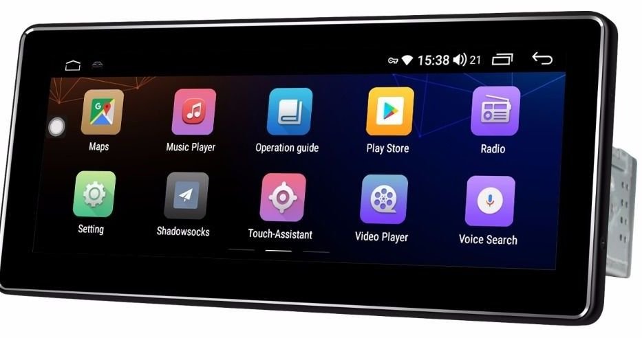

Just to update, the new interface for the JY-HQS01N4G-2 does NOT have the static clock on the side. I think that was the older Android 8.1 model that had that.
The JY-HQS01N4G-2 starts with a screen that looks like this (first image) - then if you click the cloverleaf on the left you then get the standard android screen filled with icons (second image). It's slightly annoying because except radio, I generally don't want to use these 4 built-in apps. But it looks nice.
The JY-HQS01N4G-1 starts off with this screen (or so they tell me- they have offered me the firmware to switch to this). I can't say what else is different, since I don't have this version.
Of course if you use NovaLauncher it's all moot, you can do whatever you like.

That first one doesnt look half bad. Seems like they finally started hiring decent designers.
I still prefer Nova since you can get complete customization. Also so many free icon packs in the play store that helps you get the exact look you want. And widgets you can add to your "desktop" like weather and time etc.
