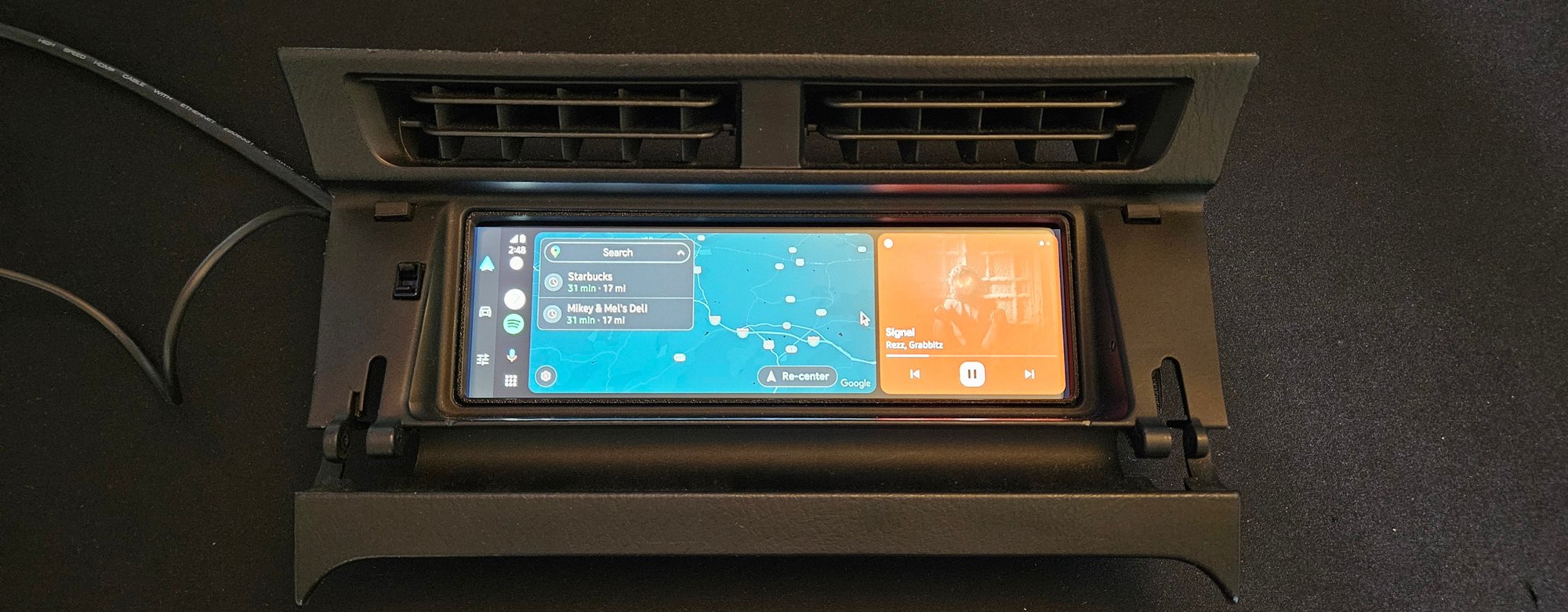

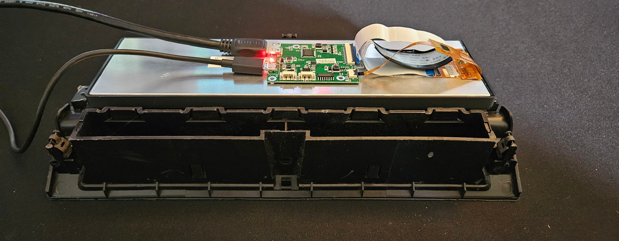

I'm using waveshare 8.8" LCD with 3D printing screen mount

https://vimeo.com/858243391
Oh, so we have the same screen then.
I got mine to fit but obviously it's too wide for the opening. I had to set margins of 115px on the config, but now the touch screen is not calibrating right. are you using the touch at all or only the knob controls? And my openauto is not scaling correctly. still trying to get that to work....

Alright i made some progress on my setup. Instead of trying to recalibrate the touch screen i'm just running the app with smaller window size specified.

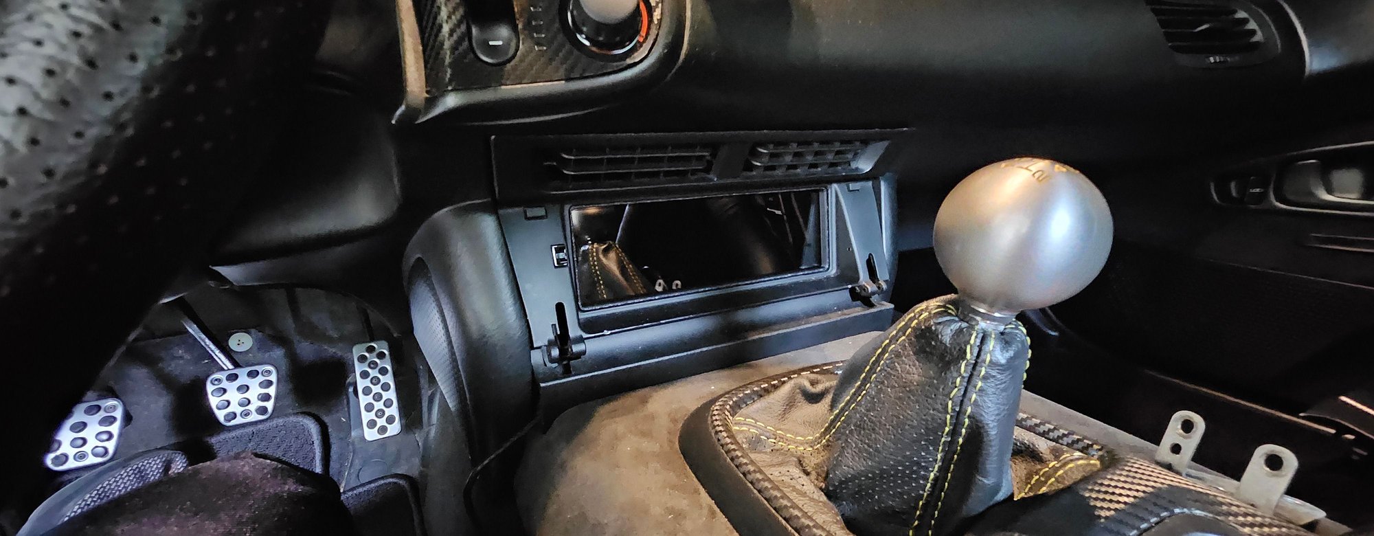

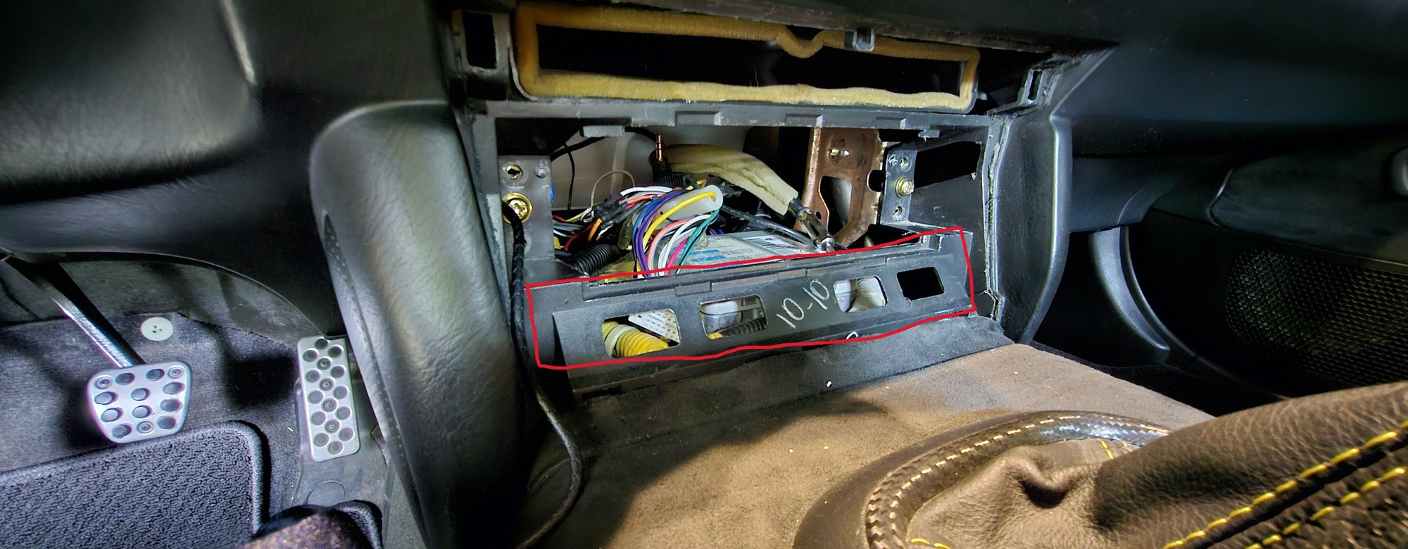

Ok, rough mockup here.... Unfortunately it hits behind the dash, so I guess i'll need to trim out the red area.
looks great, Im searching for slim screen to avoid trimming the dashboard.
