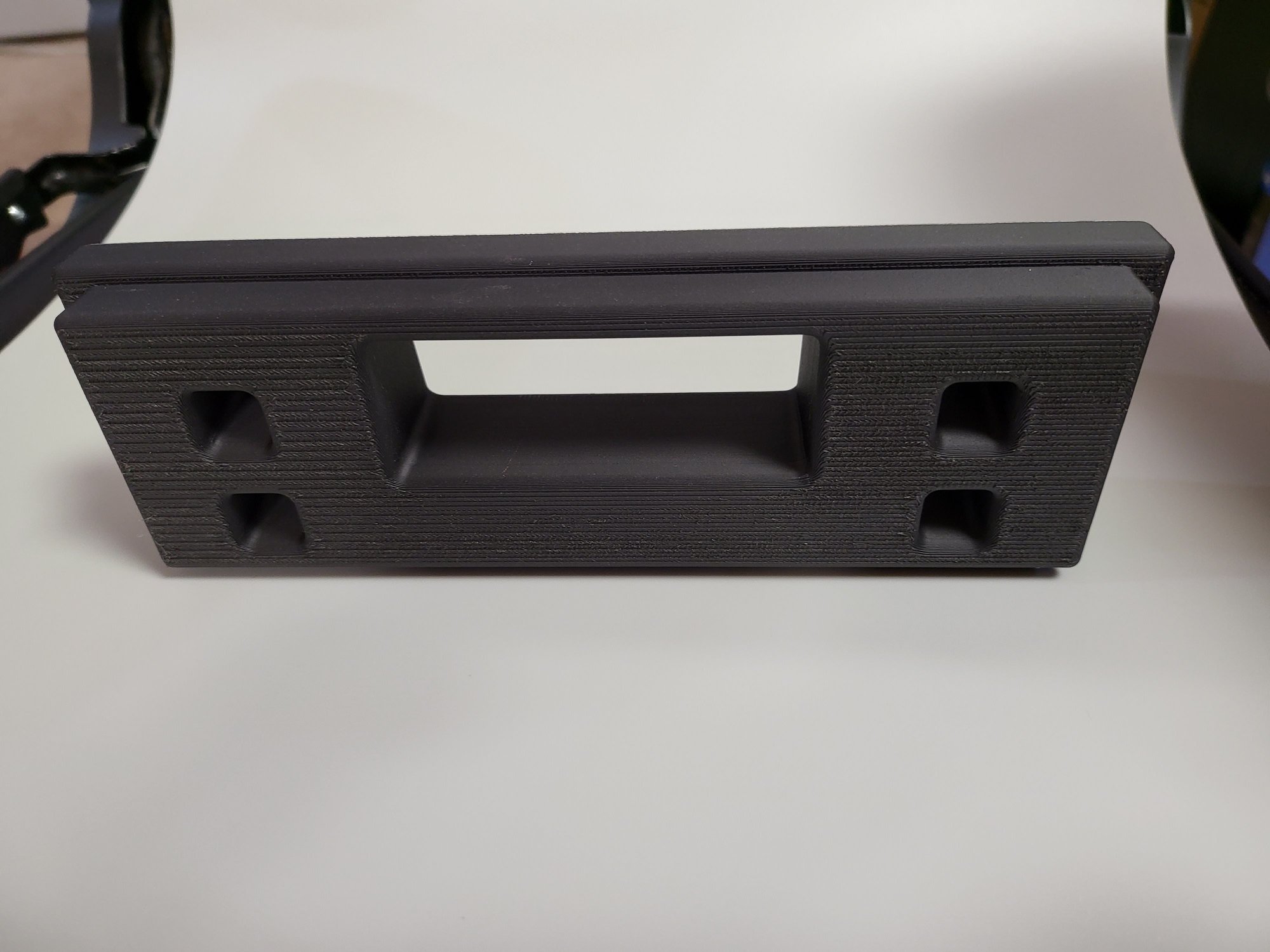

Had a friend design this off of my measurements. Presses into the opening. Allows for easy removal of the screen.
Are you selling these pieces by any chance?

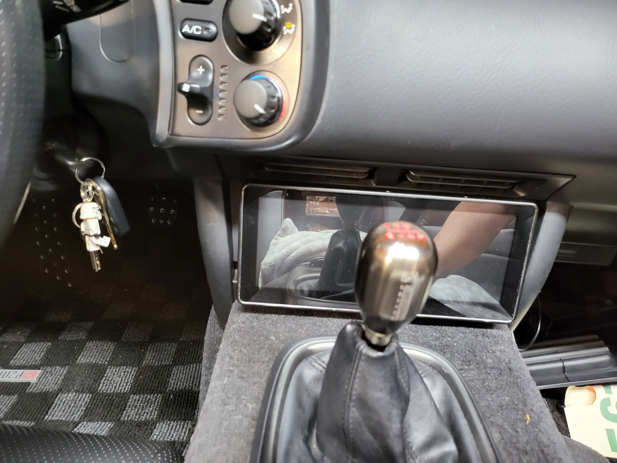

update. test fit in the car. looks so good ( installed without snap clips)
1) Will there be a tutorial?
2) What happened to the shifter?!

Originally Posted by jimmyfu
1) Will there be a tutorial? it will be once finalize this setup.
going to paddle shifting
