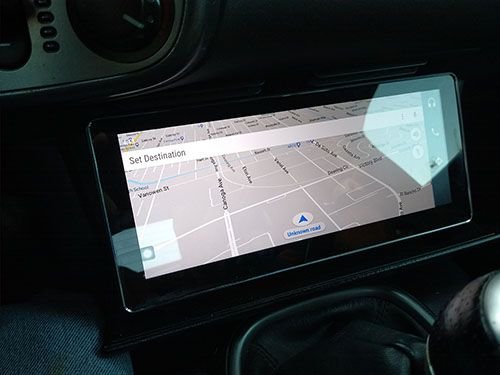

Definitely possible to have full screen. Look here: https://cimg6.ibsrv.net/gimg/www.s2k...591a6be015.jpg
I meant downloading and opening Android Auto directly on the head unit, vs connecting it through your phone. Below is the play store link to install Android Auto directly. Click install and select the Joying unit. You should be able to just open that link from your desktop and install it on your car from there. It will auto-download next time you start up your car. Same with any other apps.

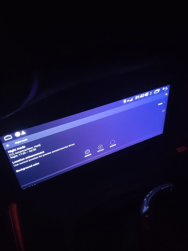

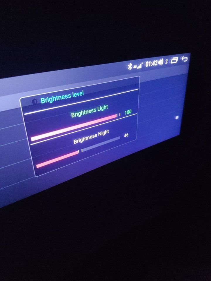

You're right, the JOYING unit itself under settings has two brightness sliders. One for nighttime. Not the auto-brightness I was thinking of that must have been my tablet. You should still be able to set it up in a similar fashion with these sliders.
The light/dark theme bit was also removed for some reason by JOYING. It's normally under Settings, default on android 9 onward. Maybe their newer OS roms include it. Luckily by default all the JOYING UI stuff seems to be black anyways.
Nova Launcher has it's own night mode you can enable under settings, although I don't know how many different apps/programs/UIs this applies to.
Many other apps offer their own dark mode. Google Maps and Waze come to mind. They both have an auto light/dark mode that applies. I dont know if its enabled by default, but I use it often. It also works the same way when viewed through Android Auto.

What you have there seems to be this Android Auto for Phone Screens app: https://play.google.com/store/apps/d...hl=en_US&gl=US
It has the same screen you show in your photo - fullscreen Google maps with some buttons on the right. It does not require a USB cable. But it doesn't seem to do much else other than maps and some notifications. I'm not totally sure what this app is for.
Then there's regular Android Auto, which comes preinstalled on the Joying (or here: https://play.google.com/store/apps/d...hl=en_US&gl=US). That one must be tethered with a USB cable, it is then activated using the Car Link app on the Joying.
My phone then enters "Android Auto Mode." The Joying then runs any of the apps on my phone, not just maps, using a simplified display for driving. But it is not a fullscreen display. This is the one that Joying confirms cannot go fullscreen.
